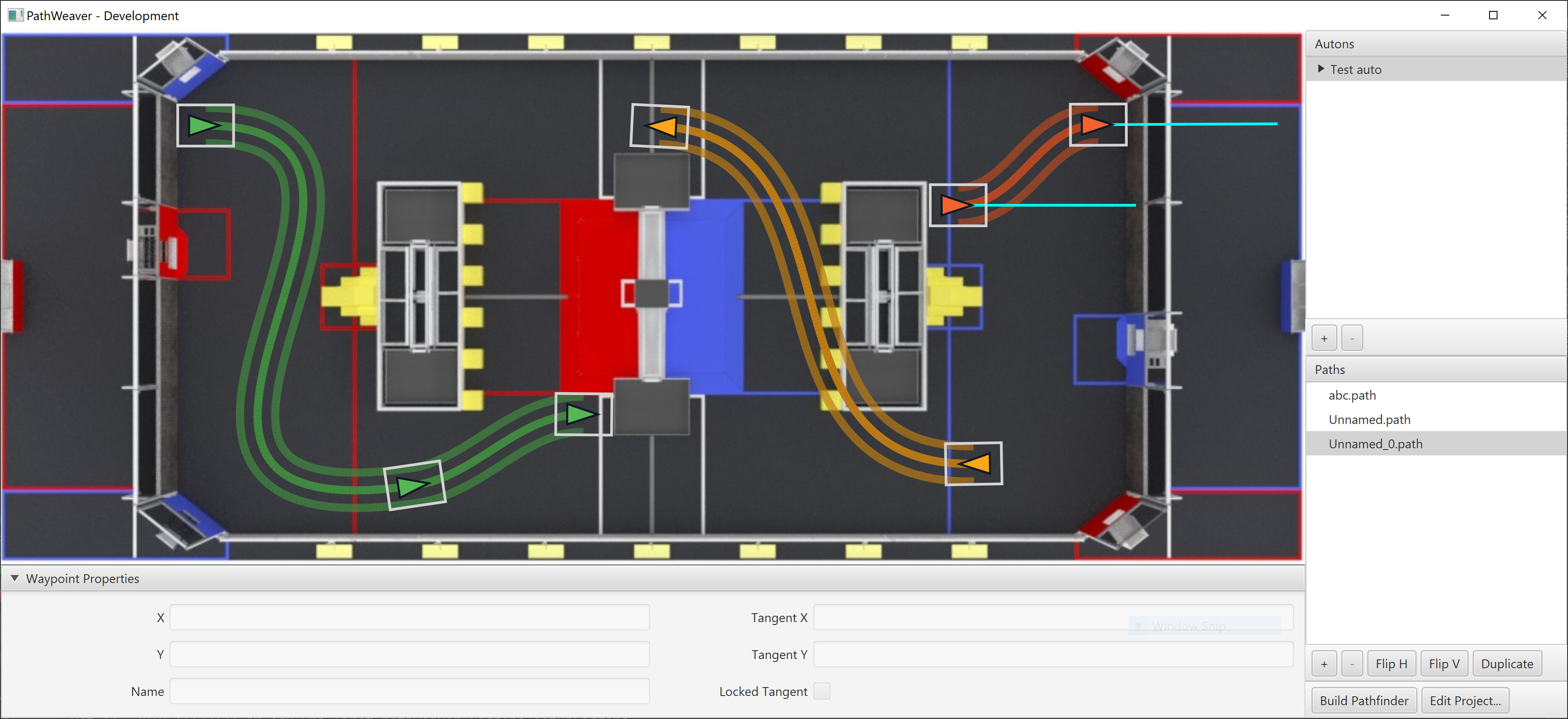

I am looking for feedback on things teams would like to see in next year’s version of PathWeaver. Some of the requested features targeted for 2021:
  • Cubic / Quintic Splines Toggle
  • More intuitive path creation (I can dive into more detail if wanted)
  • Reorganization of the properties (see below)
  • Export Waypoint to code
  • Autonomous (Path Group) file export that is a concatenation of all paths it contains.
  • Path level Max Velocity & Max Acceleration
  • Constraints. Including the region constraints.
  • Robot Outline. Wheel Path outline.
  • Path level start and end velocity control.
  • More hotkeys allowing for quicker navigation.
Here is an overview of my proposal for what the different properties will look like. The current waypoint properties will instead display the properties for whatever object is selected (waypoint, path, or auto):
Program Properties:
  • Select Project
  • Create Project
  • Import Project
  • Toggle Dark Mode (thanks Miscar)
  • Toggle Robot Outline (new)
  • Toggle Wheel Path (new)
Project Properties:
  • Project Directory
  • Output Directory
  • Game
  • Length Unit
  • Export Unit
  • Wheel Base
  • Robot Width (new)
  • Robot Length (new)
Autonomous Properties: (new)
  • Constraint List (new)
  • Constraint Properties (new)
Path Properties: (new)
  • Reversed (moved from waypoint)
  • Quintic or Cubic (new)
  • Max Velocity (moved from project)
  • Max Acceleration (moved from project)
  • Start Velocity (new)
  • End Velocity (new)
Waypoint Properties:
  • X
  • Y
  • Name
  • Tangent X
  • Tangent Y
  • Locked Tangent

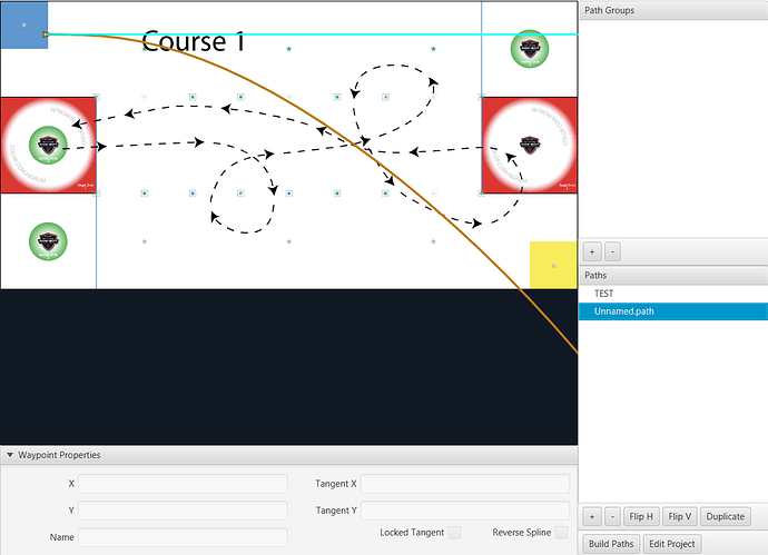

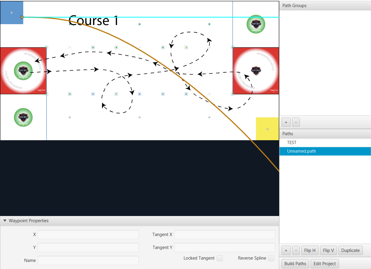

We are having difficulty using custom fields and robots with Pathweaver. We can write the .json, and they seem to load, but the coordinates are off the edges of the frame so, there is no way to edit the waypoints.
To that end, if you could see each waypoint without clicking on it first, that would be helpful.
Here is an example of what we are seeing (I do not mean to derail this thread, I am just reporting what we see)…
Here is the .json we are using (props to @veg for the field image and .json. it taught us how to use FIeld2d successfully:)

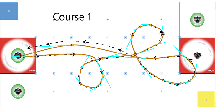

We implemented circular arcs for our IR@Home skills challenges; this experience suggested that wpilib trajectories could be based on a more general, parameterizable curve class, instead of being restricted to only spline curves. For PathWeaver, it makes one think about ways one might specify circles, points of entry and exit, transition curves (so you don’t have velocity discontinuities when moving from lines or other paths to arcs), etc.

Can you elaborate on the differences you’ve found between the Field2d JSON and the Pathweaver JSON? They should be the same (Field2d was designed to take the Pathweaver JSON). Or are you saying that you wish Pathweaver had a GUI to create the JSON file?
Hello. Unfortunately, I cannot elaborate on the differences save that the .json above works in field2d, but does not in Pathweaver. I wonder if either, there is a bug, or if I am missing a step.
By works/not work, I mean that in field2d, every waypoint we enter is 1-1 with real-world geometry.
In Pathweaver, if we finagle the scale, (in the project selecting inches or feet rather than meters, we can see at least one of the waypoints, but if we select the units the project should be in, we do not.
This seems to happen with every project we create manually. However, not with the example projects in git. I will play a bit to see if I can flesh out what is hapenning a bit more.

This is resolved in this PR that has already been merged. PathWeaver was hard coding the default path at like 10 feet and since this field was so small it went off the edge.

Lets debug this. I helped someone in this issue get that image working. There was no issue with the JSON.

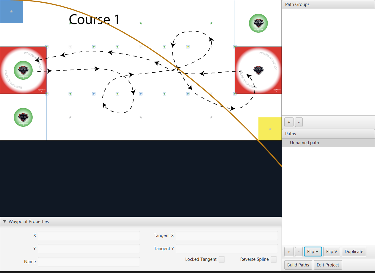

Thank you for your wonderful reply. I had just figured out some the main issue is that all of our fields are so small :).
Issue 1: the beginning pose is at 0,0 so there is no way to grab the handle.
Issue 2 involved the waypoints of the default path. It seems relatively easy to build pathweaver from source, so I wonder if it would be easier to just use the updated version.
If anyone does not want to go that route, I was able to get a solid path using inches as the default scale and moving the top of the field down a bit. However, when I try to open a new path, the same issue seemed to reappear.
Issue 1: We always include a bit of area around the field just for this purpose. Even if it is just 10% white space on all sides. I now realize this isn’t documented and isn’t obvious so I created an issue
Issue 2: If you don’t want to build PathWeaver from source you can always go into the PathWeaver/Paths directory and adjust the X and Y values of the waypoint you want. It will look like this:
Once you get a path in bounds I would say just use duplicate to produce similar paths

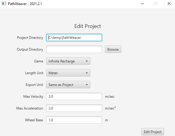

All this playing with scales brings up a related question. If we output the trajectory.json in inches, is WPILib going to convert that to meters on import? Currently, we are casting each pose and waypoint using Units.InchesToMeters(). But, we are not yet using Pathfinder due to the aforementioned issues (but will start now. Thanks).
The project settings has Length unit (you would want inches) and Export Unit (you probably want “Always Meters”).

Visualizing the robot will probably look something like this with the ability to toggle both the outline and the wheel paths off.
