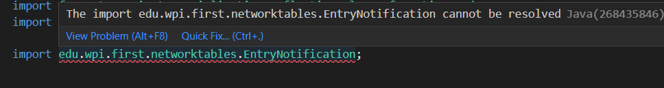

The import edu.wpi.first.networktables.EntryNotification cannot be resolved
I can’t seem to figure out why there is an error on this import. Is there something wrong with the way it’s typed? Is it deprecated?
That class was removed in 2023. See the NT4 migration guide here: Migrating from NetworkTables 3.0 to NetworkTables 4.0 — FIRST Robotics Competition documentation
Thank you Peter Johnson!
