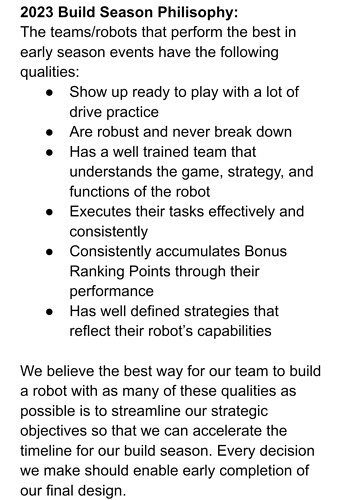

As you can see from our strategy paper, 6045’s goal this season essentially boiled down to: “Keep it simple, get done early”.
This philosophy enabled the following timeline for driver practice:
