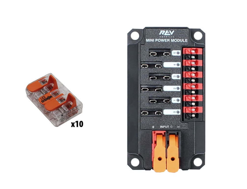

My team is trying to figure out what the red and black wire go to on the can coder for the mk4i swerve module. We think has something to do with the power supply, but we are not completely sure.

The red/black is exactly what you surmise, power supply. It needs 12V, and can be powered directly off of your PDP/PDH. You can use one of the “small” low current ports on PDH or one of the big 30A/40A capable ports – whatever you have available. You can allocate 1 12V port to all your encoders as well as other 12V items (e.g. limelights, other sensors, etc.

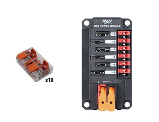

There’s a couple ways to power them and what our team likes to do is wire all the power leads of the cancoders together into a 5 pole wago (left) into the rev mini power module (right). That way it cleans up the wiring a bit. You can also use the mini power module to power a limelight and other 12v sensors. You then wire the mini power module up to the pdh/pdp.
