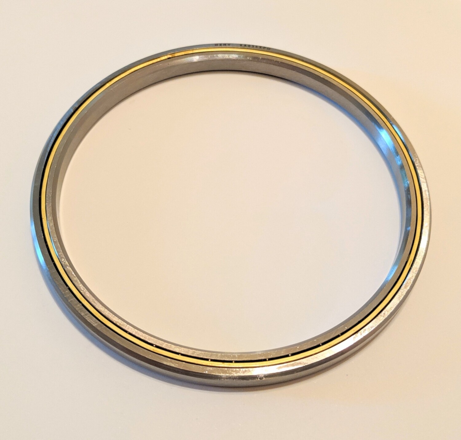

We should be receiving the 4" OD x 3.5" ID swerve bearings on Wednesday. We’ll have a limited quantity to start on this initial run but plan to order more. Lead time is only about a week on them, so don’t worry if you don’t pick any up on this first run. We’ll be getting more assuming quality is good.

The 4" OD x 3.5" ID x .25" swerve bearings are now in stock. Let me know if you have any questions!
Did you make a typo on the price? This is substantially cheaper than I’ve seen elsewhere.
