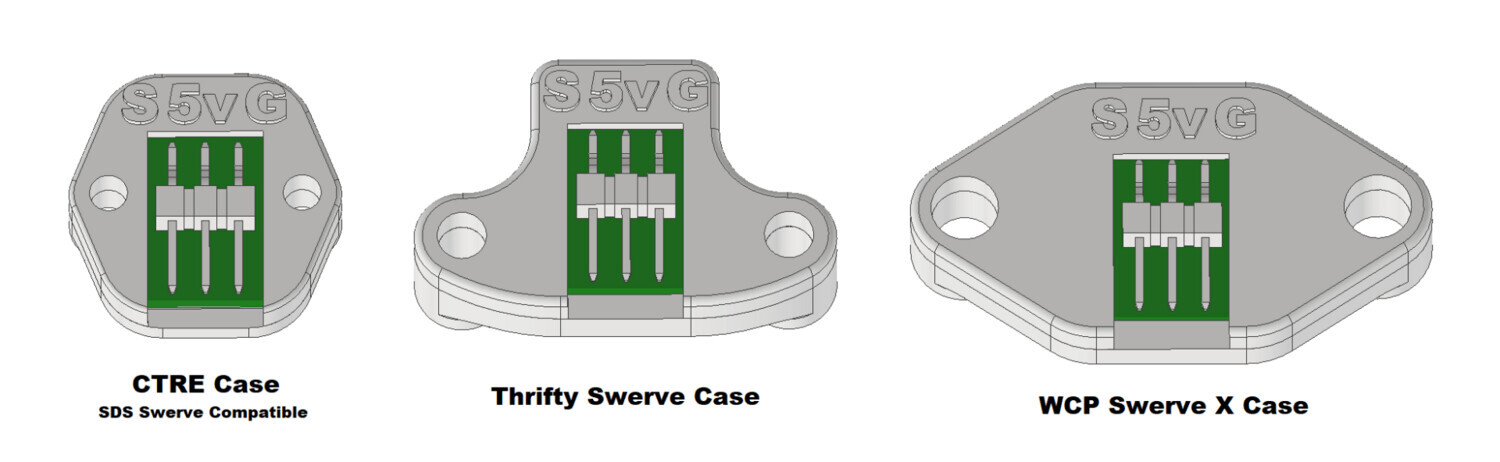

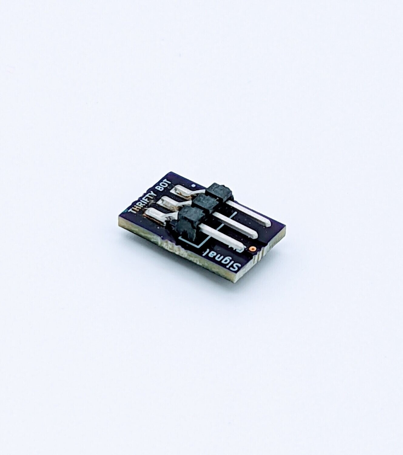

Introducing the Thrifty Absolute Magnetic Encoder!
This is a project I have been working on for quite some time, and we are happy to finally release it to the world! In a nutshell, it is a low cost absolute encoder all-in-one solution targeted primarily at swerves. We have created a trio of cases to help interface it with all COTS swerve options, and we are excited to see what other uses teams come up with.
It outputs a 12-bit analog signal relative to the magnet’s diametric position and interfaces with any standard PWM-style cable (included).
Let me know if you have any questions! All parts are genuine and the PCB was fabricated and assembled in the USA.
Edit: Forgot to mention: it is very smol. Also shoutout to @marshall for the beta feedback!

Even better, this product ships with a case included for maximum convenience.

Note on the 3.3V option - for best practices, shorting pins 1 and 2 of the IC is highly recommended. A nice solder bridge will work fine. The manual will be reflected to say this.
Super cool! I did not enjoy mounting the other type of magnetic encoder with its fiddly multi-pin cable :wink:
What chip is used on this? I’d like to go read the data sheet… Is this a ratiometric sensor (like a potentiometer)? IE, if the power supply is 5.3 Volts, the output is 0-5.3 Volts? And, really, the output can’t be 0-5.3 Volts; rail to rail outputs only get “pretty close” to the rails. I think folks are going to need/want a bit more stuff from the data sheet.
You probably want to have a bit of verbiage on the calibration procedure for this: doing a few full turns and finding min/max levels to go into the firmware. If its ratiometric you may need to measure the supply rail to deal with variations.
It is ratiometric. I will update the manual to clarify “operating conditions,” as you are right, they are different from the absolute maximums found in the present manual. As for the “pretty close” verbiage, check your PMs.
Fun datasheet! Thanks @samthesnake !!!
So, for the interested parties: the analog output doesn’t want to see anything lower than 100 kOhm load for 0-100% operation. The data sheet doesn’t tell you what the output resistance of the analog output pin is, so you can’t calculate how close to the rails you will get. For the high impedance input on the RoboRio, you should get very close to the rails.
There is a 10 Least Significant Bits hysteresis that happens when you run all the way to the min or max before you go back into normal operation. SO, when you sit at 0/360, it will not chatter on you; you will get a nice stable zero or VDD signal. 10 LSB steps is -tiny- on a 12 bit chip!
