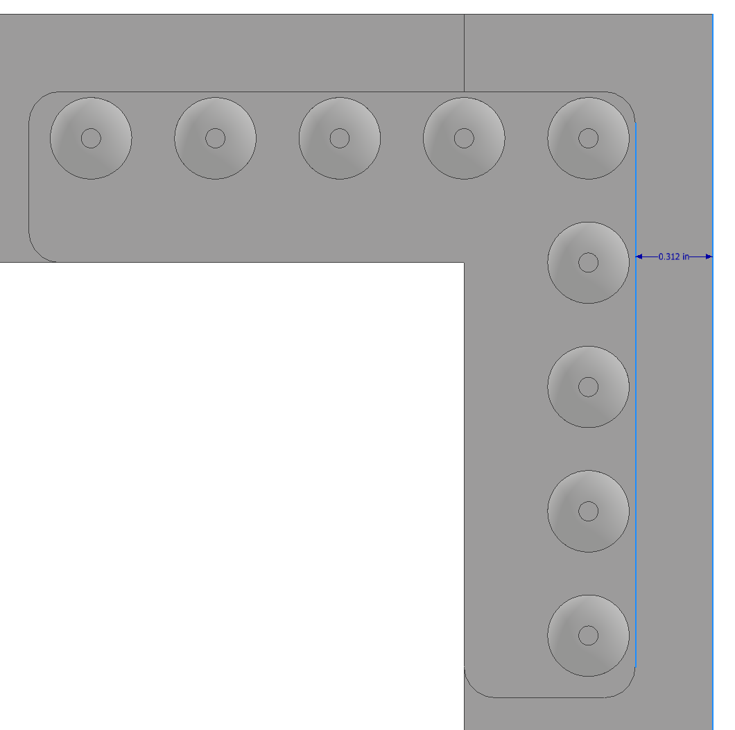

There seems to be a problem with at least one of the dimensional drawings for the elevator gussets. Are they 0.69" wide, leaving a 0.31" space for bearings (third image), or is there a 0.327" space, meaning the gusset is 0.673" wide? Or are you using 1.017" wide tubing?
You’re right, I’m not sure what happened there. Image has been updated on the product listing as well -

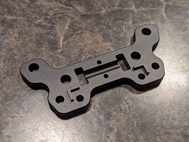

You know you’re an engineer when you get excited looking at something that’s been machined, vibratorily deburred, and then coated and thinking mmmmmmmmmmmmmmm sexy. It’s no wonder why my wife wonders about me sometimes.

Just curious if you’re okay with sharing, how are you making the protrusions and axle cutout? Looking at the part at first I thought it was just a milled plate, but now I see it has to be more complicated than that.
The respect I give this statement is over 9000
I asked back in November how these were made on the facebook page. Myself and a few team mentors were thinking the same thing you are, “no way that’s machined!”.
I was told they are machined. Looking closely at the features, there are small radii on the raised “L’s” suggesting a tiny endmill may have been used there, and the semi circle for the bearing shaft could have been done with a ball end mill.
