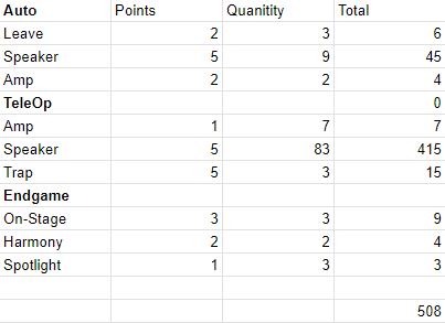

Well, thats complicated. I calculated it if every single note on the field was scored on one side, including ones in the other alliance’s human player station. I also assumed that the robots could score 1 piece per second each during the Amplified periods. My total score was 508 points.
Is this useful? No.
If your alliance is going to score all the NOTES and not allow the opponents to score any, there’s no point in having that odd NOTE scored in the AMP for Coopertition.

Also, i think your math on note points is wrong. Should be 2 amp notes for 1 point each and 4 speaker notes for 5 points each, for 22 points each cycle. 96 notes is 16 cycles for a grand total of 352. If the first cycle includes auto amp notes then it’s 354. Unless I’ve missed something?
Edit - I see it’s adding cumulatively on some lines
Good catch. I fixed the lines to not be sporadically cumulative… I had it all in a spreadsheet, so the totals all made sense, but my breakdowns were incorrect. Thanks!
