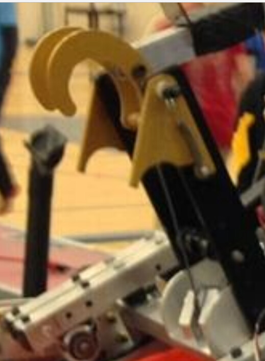

One example from 2013 off our robot that we used to use a spring-loaded hook to get past each bar. Not the best pictures, but between the two you can kind of tell what’s going on. Top set of hooks would pull the bar you are lifting up to past the lower hooks to engage on the bar.
Seems doable to duplicate this from underneath. Heck, just copy what they did in the game reveal vid and put a bumper around it.
