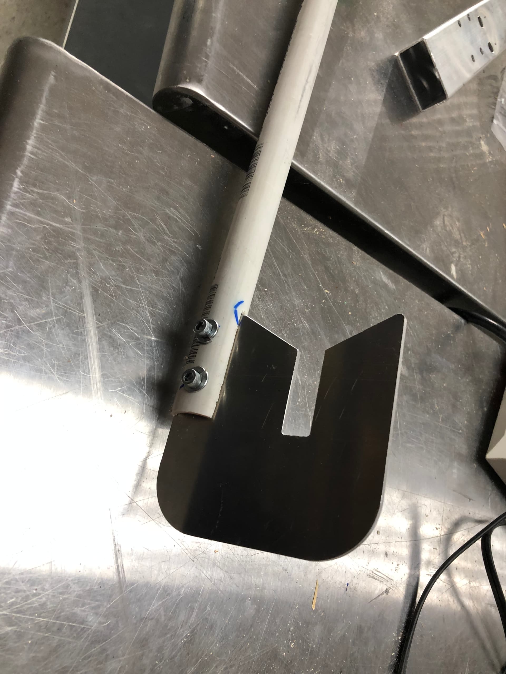

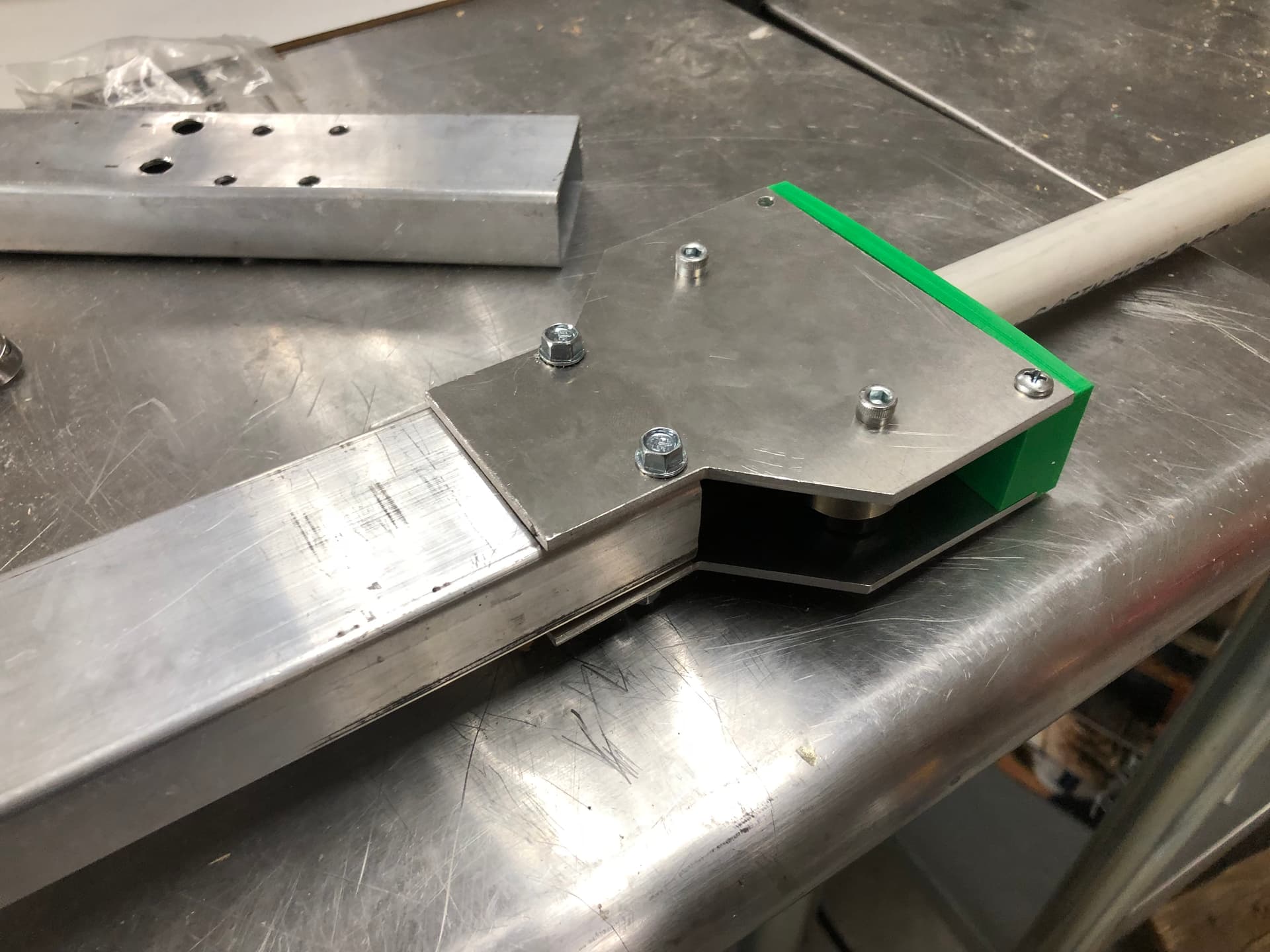

Thoughts on this hook design for #2024 Crescendo
Hey there, my team though up a pretty basic winch-climber design, and we chose to fit it with a hook specialized for chain, that we borrowed from the PRi3D of the North Ri3d bot.
I’d love to get some feedback on the potential benefits and drawbacks of this design.
Seems pretty reasonable, but I’d make sure you’re tying off the winch to the bolts through your hook, the PVC may not survive otherwise.
