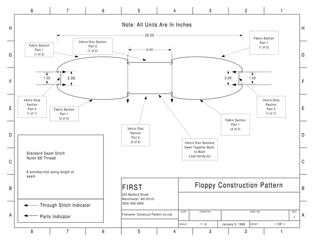

@Dave_Hurt Except in 1999 we were not using hook nor loop tape on the floppy itself. The floppy was made from a polyester/spandex blend that hook sided tape would “connect” to, also there were not the number of interactions then per floppy as we will have quantity of interactions per hatch panel this year at each event.
I hate to say it but as I recall there were black rings around the OD of the floppy, and on the “donut hole”. And if I’m not mistaken those rings were… Velcro. And there was velcro on the base of at least one robot I’m aware of. I wish I knew where I managed to find this picture (probably TechnoKats History Project) but it should show what I’m talking about.
yup, @EricH is right, the black ring on the outer edge of the floppy and the center of it were all loop side of velcro. I still like that game, it’s funny to look back at pictures and see how different things were back then :slight_smile:
Whoops, talk about a brain fart. Guess I should have double checked. :astonished:
