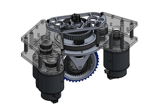

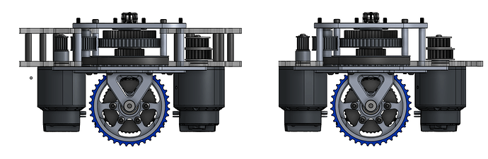

This led into the CAD phase of the project. Starting off, 1678 uses the SDS MK3s + their own custom parts to adapt the module for three motors. This led to “updating” the modules by pretty much plugging the 1678 extra parts onto a MK4 module. This was not a very big feat as the MK3 and MK4 are in fact very similar. I also felt as if I could be a bit more lenient on the spacing/sizing of the motor plates as 1678 had a very small package to fit them into, while I do not. This led to “beefing up” the plates (adding surface area) as well as “sandwich-ing” them (idk the correct term) and connecting via standoffs for extra stability.
|317px;x224px; ^top plates are the original 1678 plates, bottom is the new plates.
^right is the CAD orignal of the 1678 module, and left is the “sandwiched(?)” version
^isometric view of the module

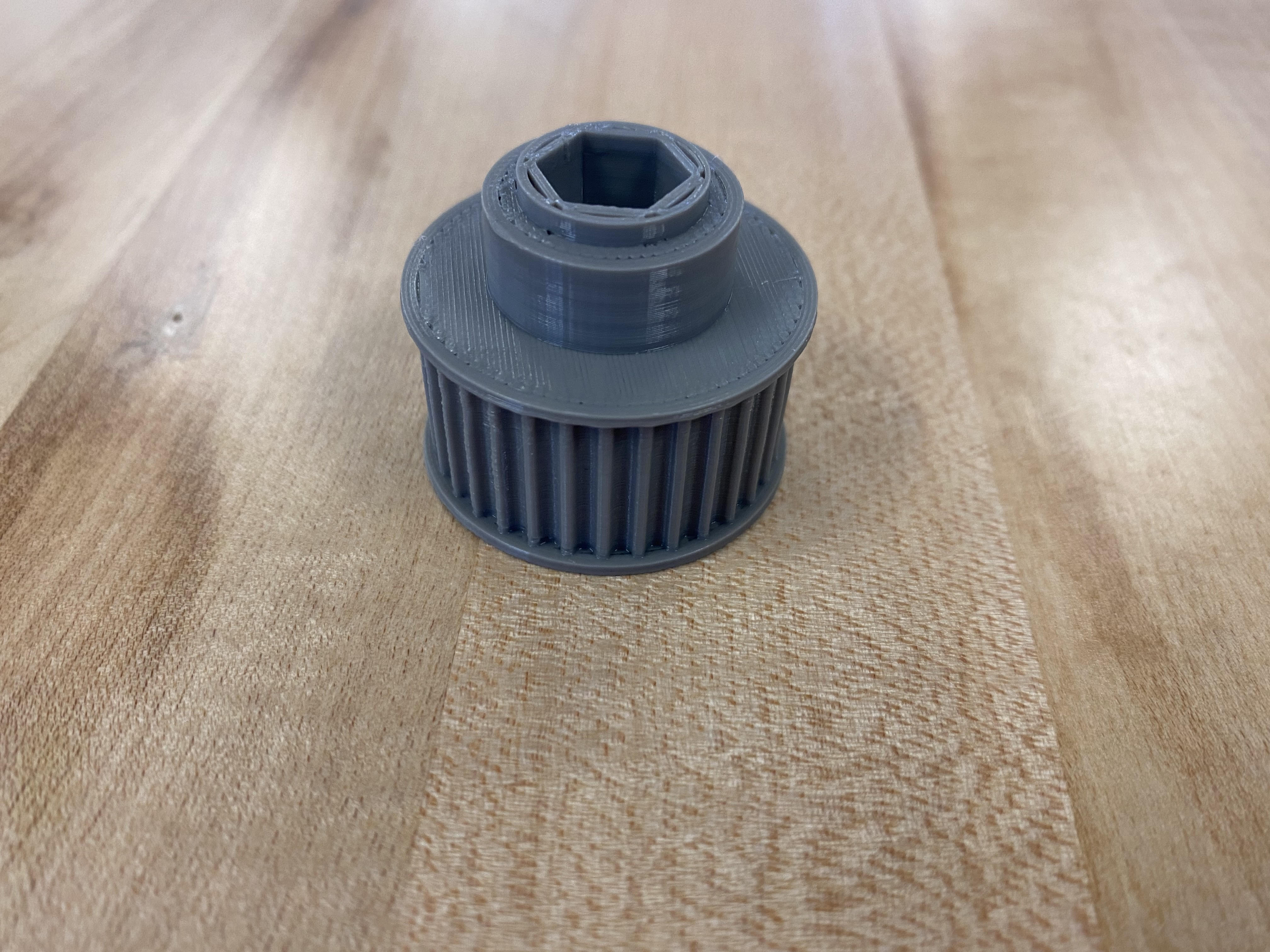

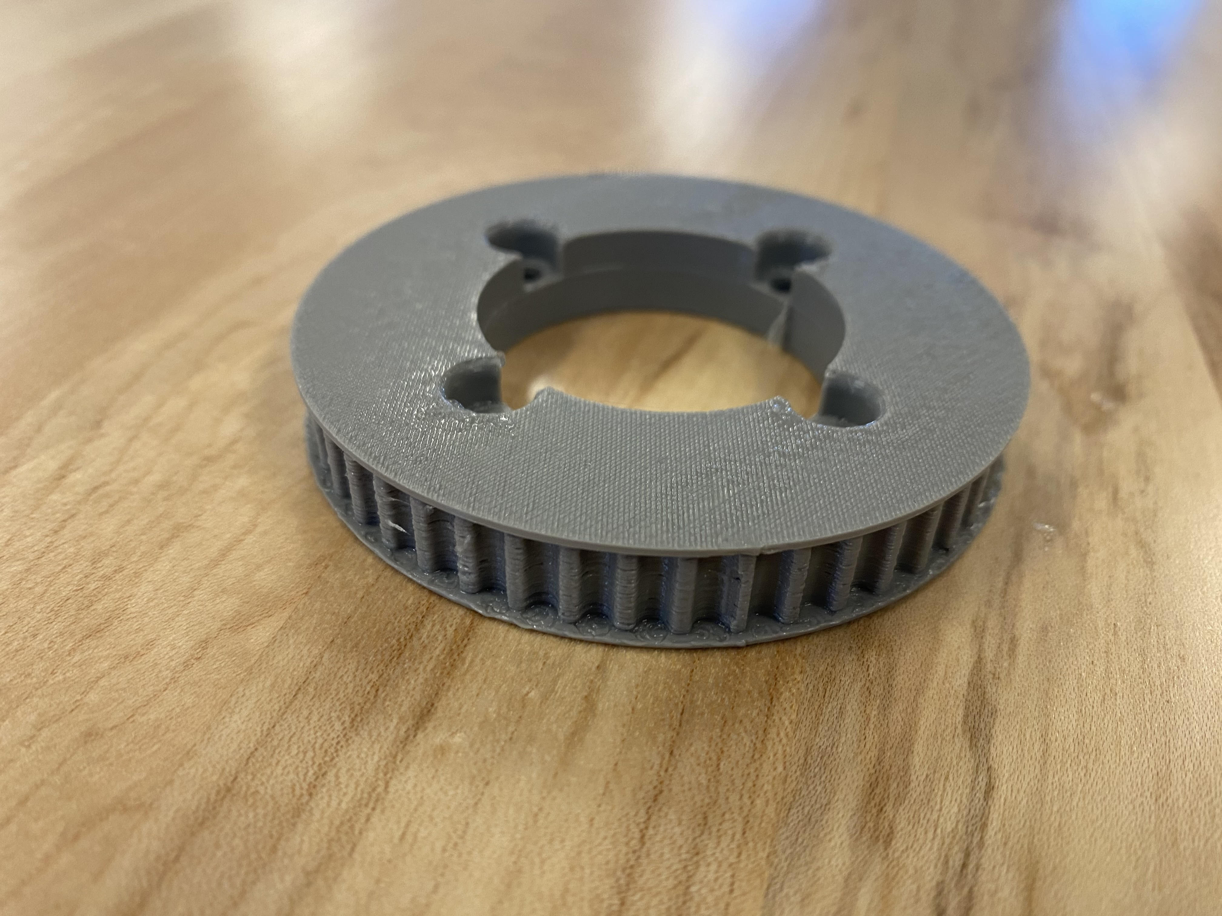

After these steps were completed, we come to the part of the project I am currently on, fabrication. Currently our lab has two MakerBot Method X 3D printers that I’m (trying and sometimes failing) to use to print the two 3D printed pulleys that are seated under the original drive double gear and the original steering shaft. I’ve gotten these prints to work successfully as PLA, but I am struggling to get them to not “string” as carbon fiber nylon prints. I’ve managed to get the driving pulley to print out of the CFN but I’m still working on getting the steering pulley done. I have faith it will work after some extruder temperature changes. Additionally we were gifted a second hand Glowforge at the beginning of this school year so I plan to laser the motor plates out of some acrylic (that isn’t dangerous to inhale when done). I do have doubts about if the acrylic is going to be strong enough to withstand the forces in play. If this becomes an issue, I could contact a local CNC-equipped shop that would be willing to machine some motor plates.
^left 3D printed steering pulley in PLA, right 3D printed drive pulley also in PLA

You may find that you can print plates and get something good enough for form and fit, especially with the filled plastics. Gentle function, maybe. CNC routed polycarb will get you decent levels of functional plates. That’s what I did with Nick Cousin’s Winter Swerve… CNC routed fiberglass will get fully functional, but its kind of icky to route; lots of “don’t even think about breathing this stuff” dust…
So, your goal here is maximizing coolness, right? With a side order of making it easier to break the tires free?
The gods of symmetry are angry! Could you move the second drive motor so it’s equidistant between the first drive motor and the azimuth motor?
If the goal is to make a pro street, funny car swerve, then mission accomplished, otherwise 3 NEO550s would do the trick and still have high coolness factor.
That’s the hope… :eyes:
That’s interesting, I didn’t think about printing the plates, I thought they would break easy, definitely going to see if I can do it now.
And yes, coolness and outright performance is the goal here. Our team is from the PCH district, a somewhat underdeveloped district on the technical side so it might be cool as a quirk of the team doing something that few have done soo…
I thought about moving the secondary drive motor to the middle like 148 did… BUT this was easier… if it turns out as a problem having the motor far away I definitely plan on moving it…

ITS DONE!! Well V1.0ish that is. Had to modify the gearing a little bit because the main driving pulley was rubbing up against the steering pulley. Re-printed a smaller middle drive pulley so that constituted different belts so on and so forth. Another point of issue would be flex in the plates, but I’m working on a fix for that.

Love it. I think more and more teams will do something similar in open-field games. A little overkill but doesn’t the i in MK4i stand for incredibly OP.
The ground clearance on those Falcons is a bit terrifying to me. For actual game-play, if your robot goes over something it’s not supposed to (cable protector, another robot, field debris, a cone that doesn’t like pushy-pushy, what-have-you), you might end up with some interesting lateral forces on those poor little fellas.
Yea… there’s a lot that isn’t optimal about the first iteration of the module. I think using the MK4i for the second iteration should solve this… I’m currently looking to re-CAD the three motor MK4i plate to have all of the motors inverted… but we shall see
Of course, not having your motors inverted means your modules are taller, so they’re in the way of upper mechanical mechanisms…
Ahhh, trade-offs.
