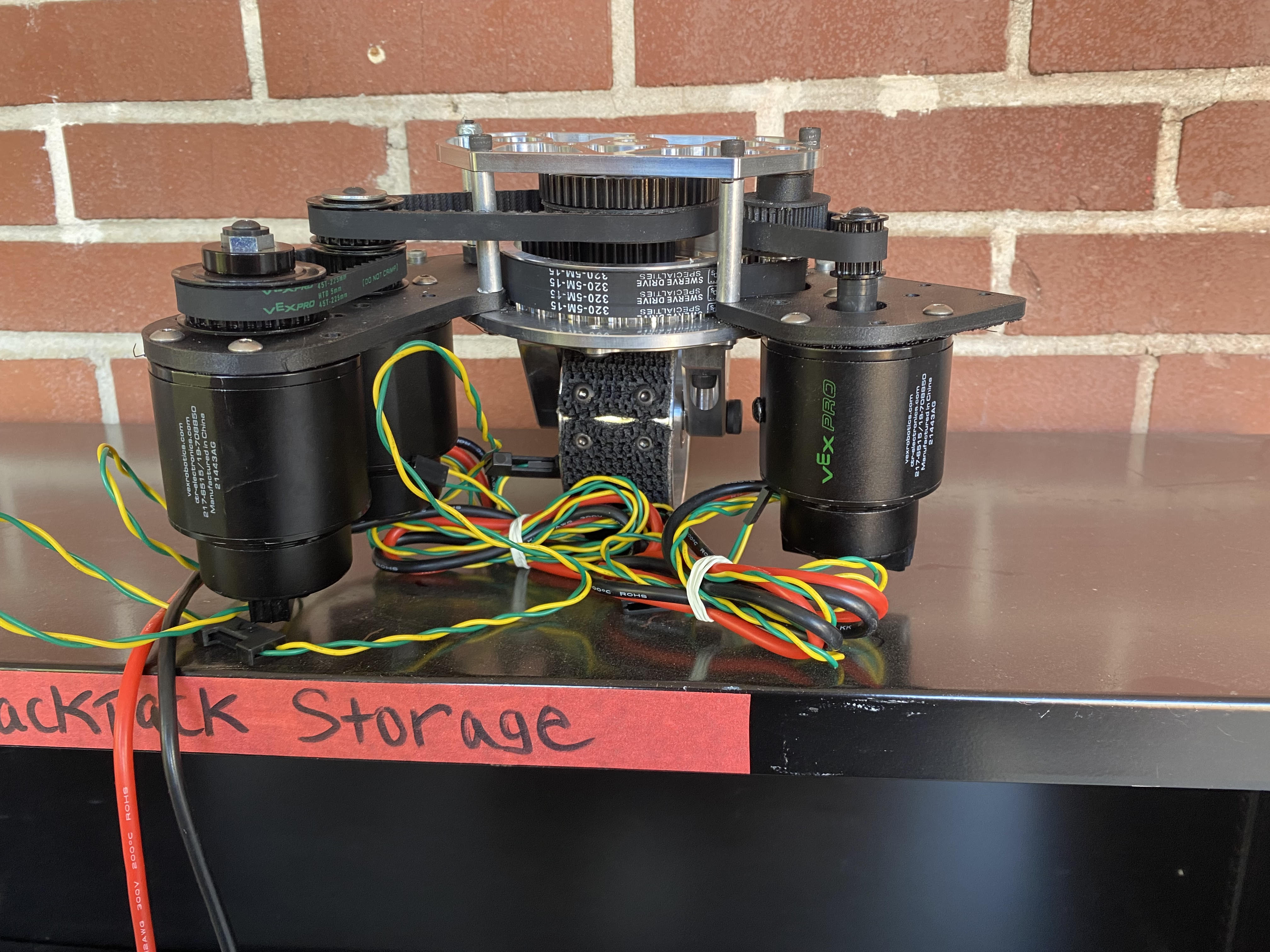

Three Motor Swerve Module

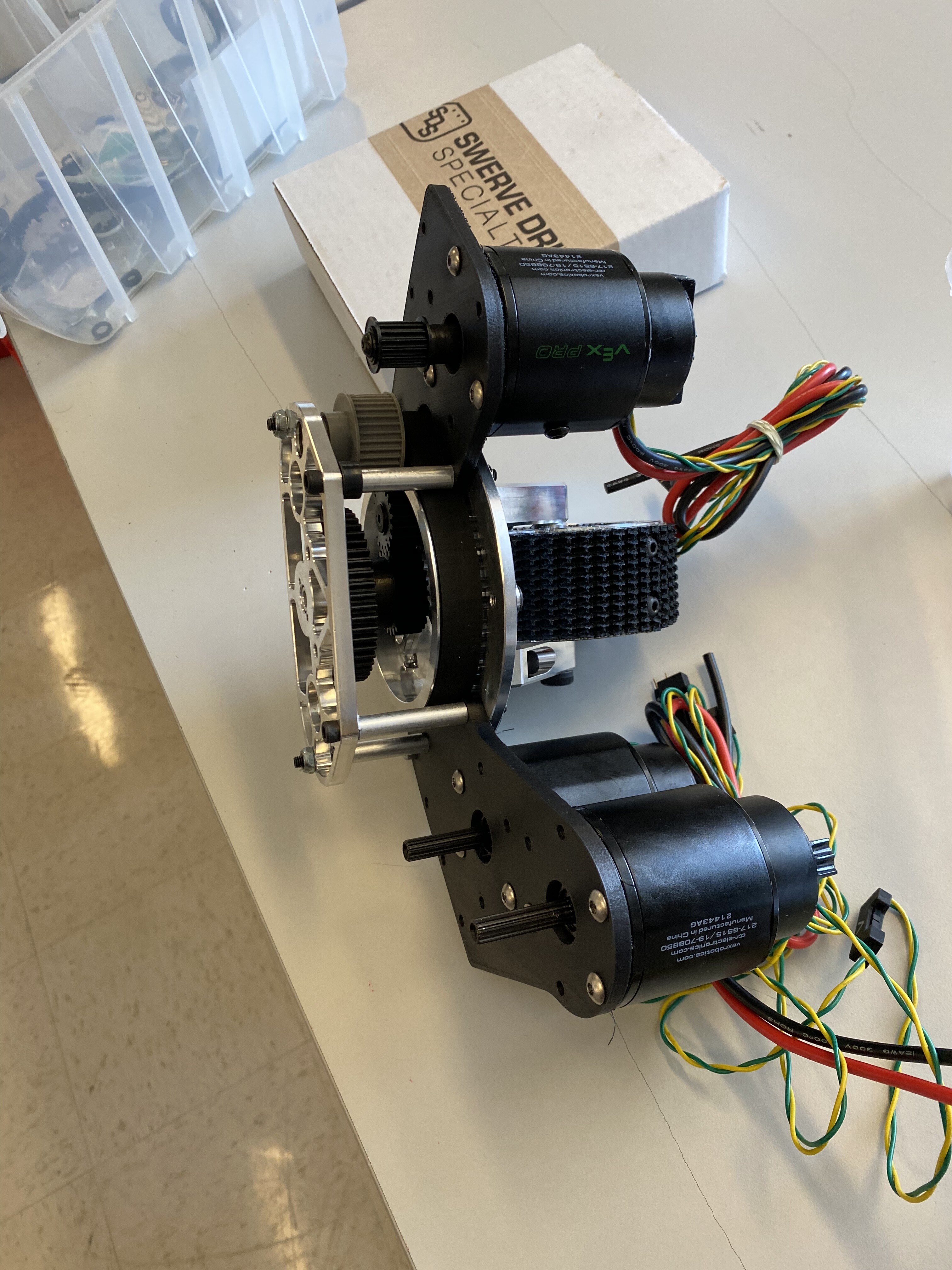

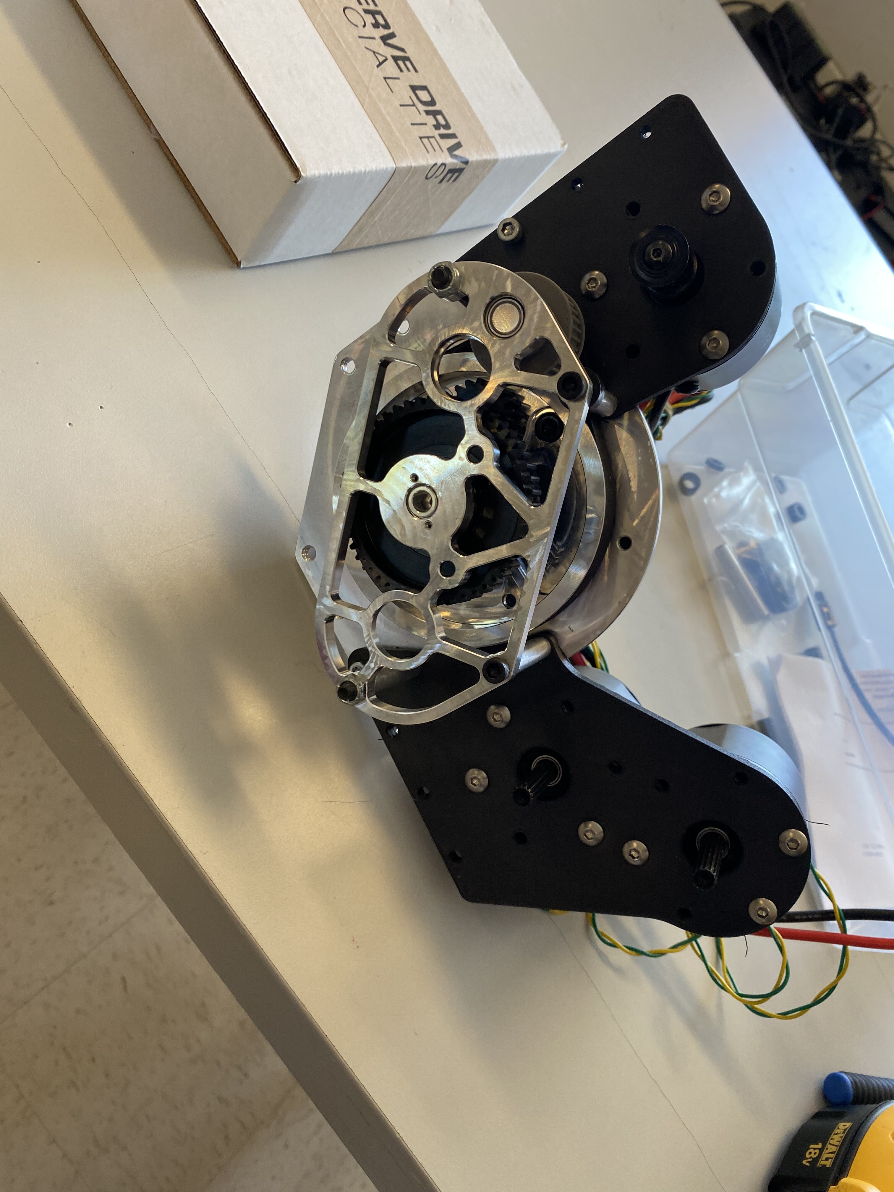

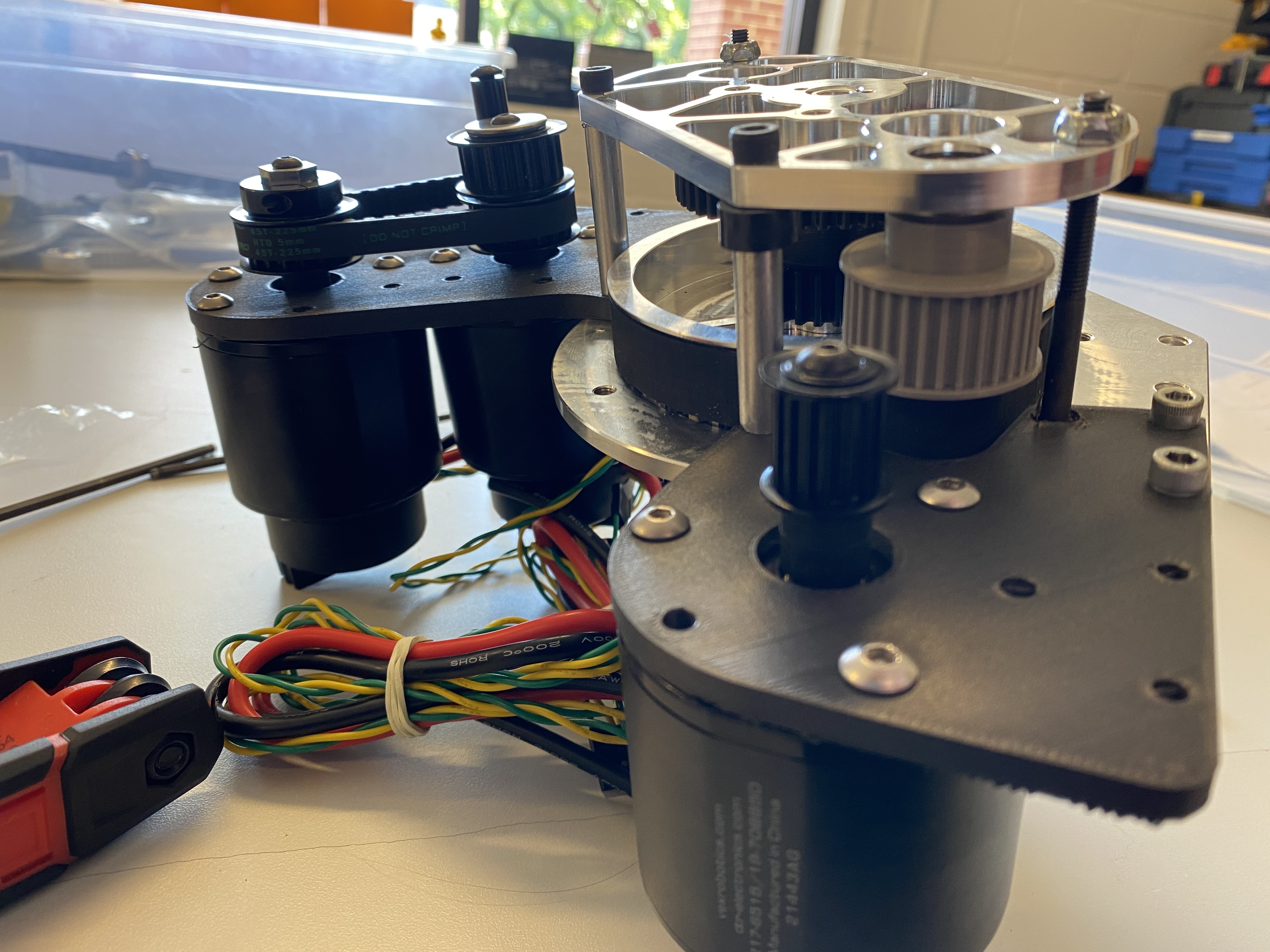

ITS DONE!! Well V1.0ish that is. Had to modify the gearing a little bit because the main driving pulley was rubbing up against the steering pulley. Re-printed a smaller middle drive pulley so that constituted different belts so on and so forth. Another point of issue would be flex in the plates, but I’m working on a fix for that.
-Alex

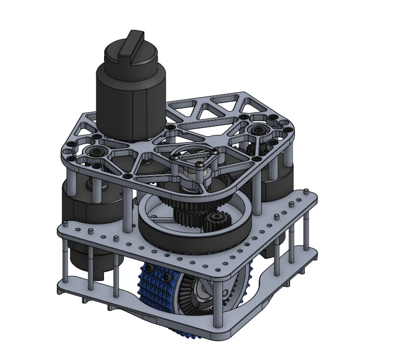

So I did this in like an hour-ish…
  • It’s just a modified top plate to the MK4i that allows another Falcon to be slotted in that drives the same gear as the primary drive Falcon.
  • Theres no changes to the ratio so it kinda defeats the purpose of adding more power, but hey it exists now…
Link to CAD:
Love it. I think more and more teams will do something similar in open-field games. A little overkill but doesn’t the i in MK4i stand for incredibly OP.
The ground clearance on those Falcons is a bit terrifying to me. For actual game-play, if your robot goes over something it’s not supposed to (cable protector, another robot, field debris, a cone that doesn’t like pushy-pushy, what-have-you), you might end up with some interesting lateral forces on those poor little fellas.
Yea… there’s a lot that isn’t optimal about the first iteration of the module. I think using the MK4i for the second iteration should solve this… I’m currently looking to re-CAD the three motor MK4i plate to have all of the motors inverted… but we shall see
Of course, not having your motors inverted means your modules are taller, so they’re in the way of upper mechanical mechanisms…
Ahhh, trade-offs.
what about changing the gears to L1 than you can have the L1 speed with a heavy robot plus you don’t need to do a lot more moding
Yeah, that’s probably the most optimal way to run it without a bunch of geometry changes.
