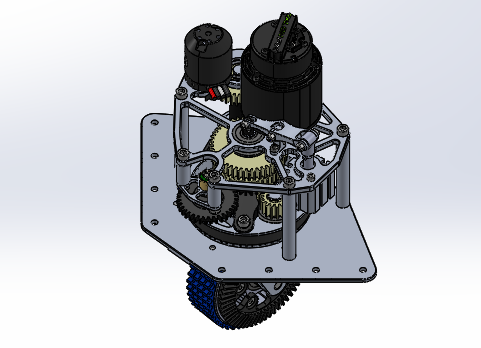

A few days ago @benjierex, Head of Engineering from my team, posted a swerve drive he made. I decided to also model a swerve drive.
I decide to take things one step further and design a shifting swerve module. I decided to reduce a stage from the swerve by putting two different pinions on the Falcon motor and have the two pinions go to the dog gears.
The module’s general design is very inspired by WCP and SDS MK2 swerve modules.
GrabCAD Link

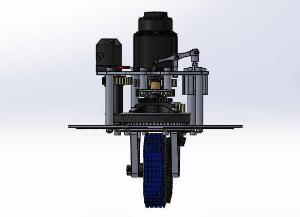

I love the lever style for the shifter, very clever. Not sure quite how important it would be to shift on a swerve drive, but it definitely looks fantastic.
Is there any sort of joint on either the pneumatic or the plunger which allows the plunger to stay coaxial to the shaft?
Im kinda embarrassed to be honest, I didnt think about that.
I think Ill put the bolt that connects the lever to the shaft in a slot.
I was about to comment on the shifter being offset like that, but then I saw the lever. I really like that, seems like it solves most problems with an offset shifter. I have the same question as Clay, you could run into problems if the plunger doesn’t stay coaxial to the shaft.
What’s the total weight/footprint of the module?
The weight is 1.3kg or 2.9lb and the footprint is 175mm x 175mm x 268mm or 6.9" x 6.9" x 10.5"
You sure about that weight? Less than 3lbs is suspiciously low… do you have all materials/weights set?
On another note, is the base plate for the module 1/8th (or similar) aluminum plate? I wouldn’t really trust that, it seems like it would bend too easily.
I’m pretty sure all materials and weights are set, but Ill double check.
The base plate is 5mm which is a little thicker than 3/16".
you were correct, some weight were set incorrectly. Its actually 1.87kg or 4.1lbs

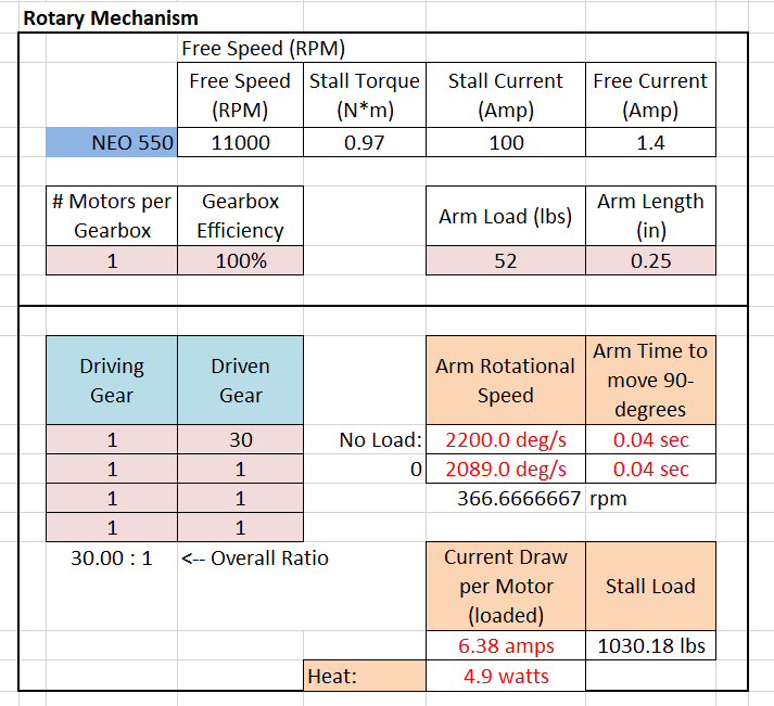

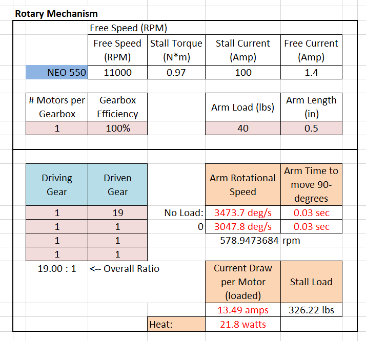

I worry about how high the azimuth reduction is. With only a 19:1, you’re a lot more likely to burn up the neo 550 during the match and it will also be harder to control. I have seen most teams using a neo 550 standardize on ~30:1 which seems like it wouldn’t be to hard to get with a larger initial gear.
Thanks for the feedback, Ill look into fixing that.
Is there any way to calculate what the gear ratio needs to be? or is ~30 : 1 based on real life testing?

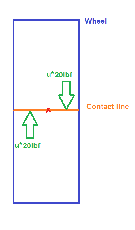

Here’s an example I made in JVN calculator. “Arm Length” should be 1/2 the wheel width, and “Arm Load” should be 1/4 your robot net weight with bumpers and battery. I add a little extra weight to account for CoM shifts.
Does 1/2 the wheel width account for the friction from the other half of the wheel? I’ve always been unsure whether there would be frictional load from each half of the wheel when turning about the center axis and whether that would be twice the load of the regular lever arm calculations.
If we imagined that each swerve had, instead of one wide wheel, two infinitely thin wheels offset from each other by the wheel width, we would find that each of these thin wheels bore 1/2 of the module’s weight, or 1/8 of the robot weight. 1/8*(Robot weight)*2*(1/2*(Wheel width)) = 1/4*(Robot weight)*(1/2)*(Wheel width). So it’s identical to put 1/4 of the robot weight on one edge of the wheel, or to put 1/8 of the robot weight on either edge of the wheel.
Math checks out, thanks for the science :ok_hand::ok_hand:
If you assume the weight is evenly distributed across the line where the wheel touches the ground, the center of the weight distribution is in the center of the wheel. Scrub is in the reverse direction on either side of the center of the contact patch and is a function of lever arm.
In fact, based on this sketch I made, the lever arm might only be 0.25" for a 1" wheel with 40lbf on it. I also neglected the coefficient of friction of the wheel in my earlier post, so here’s an updated JVN model with a CoF of 1.3.
You can assume a “worst case” like what Clayton did for extra safety - that’s how you get to a 1/2 lever arm instead of 1/4.

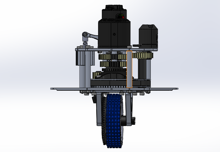

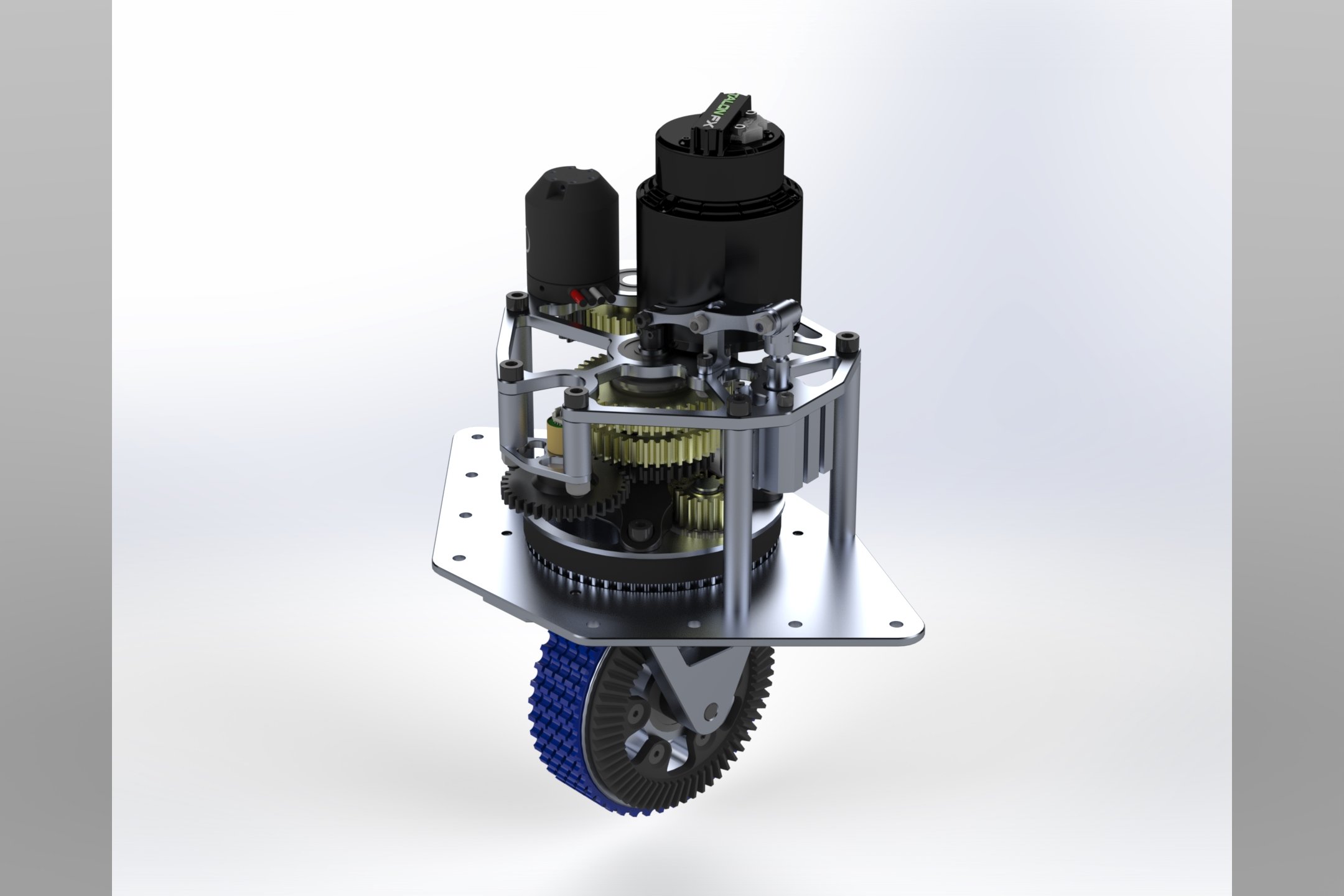

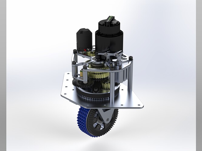

finally got around to rendering, here are the first few renders:
Really cool module! I was working on the same concept last week but never got around to finish it. +1 for the coolness of the lever thing of the shifter - one of the reasons I left the project in the dark was the packaging of the pneumatics, and this is a really nice solution for that.
Don’t you feel like the encoder mount needs more support though? It looks to me like it’s prone to shaking.

I took a look at the CAD for a few minutes and have a few notes:
  • The lever shifter is a really cool solution to packaging the shifter piston. That being said, I’d doubt whether the challenges that come with a shifting swerve are worth it for the limited advantages in real life.
  • The lever bar is unnecessarily difficult to machine. It’s not flat on any face so we would have a very hard time making it on the router.
  • Not sure how you’re getting a 19.26:1 rotation ratio. I see a 6:30 gear reduction and 18:59 belt reduction, which is a total of 16.39:1. You can bump that up pretty easily though by reducing the smaller pulley to 14t (would need to be custom machined, but we would probably do that anyway) and increasing the larger gear to 40t. That would give you 28.1:1, which gets you to a much lower current while still being plenty fast.
  • The top pockets on the main turning pulley are dangerously close to the root of the pulley teeth (< 0.5mm clearance at some points). They should probably get pushed further in.
  • Right now the main turning pulley needs to be flipped to machine the top pockets and bearing flange recesses. If you can move all of the pockets to the bottom and put the flanges outside the bottom face, the entire thing can be machined in one setup (upside-down) which will greatly reduce machining time and improve accuracy.

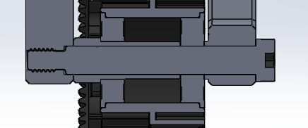

  • The wheel bearings and spacers don’t seem to be the right size for the bolt they’re sitting on
  • If you’re using a shoulder bolt as a wheel axle, you want the shoulder to go all the way into the opposite side wheel leg. See this cross-section from the SDS MK2:
Overall though, looks very good!
