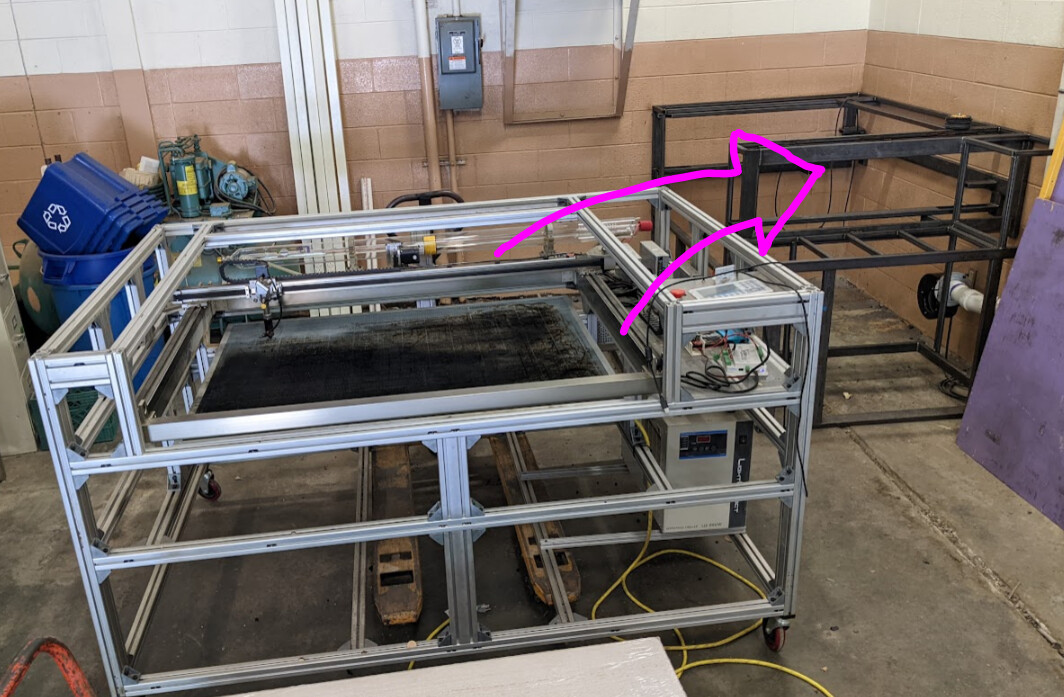

After cutting nearly our entire robot from polycarb on the laser in 2020, we struggled mightily with the same equipment 2022, sinking dozens of hours into troubleshooting the machine and earning near-zero reward for our effort. We did however use the laser quite a bit as a marking tool and then cut the parts by hand with band saw / drill press. We made our Everybot climber that way, for example.
The work still isn’t over; we in the process of transplanting the entire machine into a new frame which will feature improved ventilation and more dimensionally-stable mounts for the optics.
