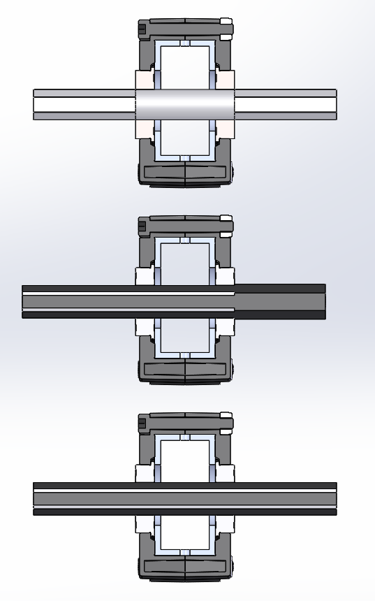

Below are some pictures to compare what I am writing about.
The first picture is a 1/2" round shaft milled at the ends for 7/16" hex. The tube is a 2 x 1 aluminum tube common for WCD style chassis. This implementation requires some level of mill work and a mill operator skilled enough to manufacture the hex.
The second picture is a 1/2" hex stock with part of it turned down to fit a ThunderHex bearing. The one end acts as a stop for the shaft and is a full 1/2" hex for those of you worried about the rounded ThunderHex shape reducing wheel torque. This requires a lathe to turn down the standard hex to ThunderHex.
The third picture is ThunderHex stock used with the ThunderHex bearings. There is no mill or lathe work required, which makes a WCD style drive with round bearings accessible to teams whether or not they have a lathe or mill.
Sure, if your team resources allow you to mill a hex and you want to use 1/2" round bearings, then ThunderHex isn’t for you. However, here are some interesting facts as compared to 7/16" hex.
Even with the hole, the 1/2" ThunderHex will see approximately 62% of the bending stress that the 7/16" hex will see given the same bending moment.
Even with the hole, the 1/2" ThunderHex will see approximately 62% of the torsional stress that the 7/16" hex will see given the same torque load.
For every lb of 7/16 shaft, ThunderHex will weight 1.093 lbs.

The 13.72mm bearing seems to be the perfect size. You still get plenty of contact area on the bearing (http://content.vexrobotics.com/vexpro/pdf/VEXpro-ThunderHex-Drawing-20141216.PDF), and it’s still a hex, so you can throw a gear/sprocket on it, and not worry about the shaft breaking.
The clearance hole also lets us tap these for 1/4"-20’s, but doesn’t really weaken the shaft much.
