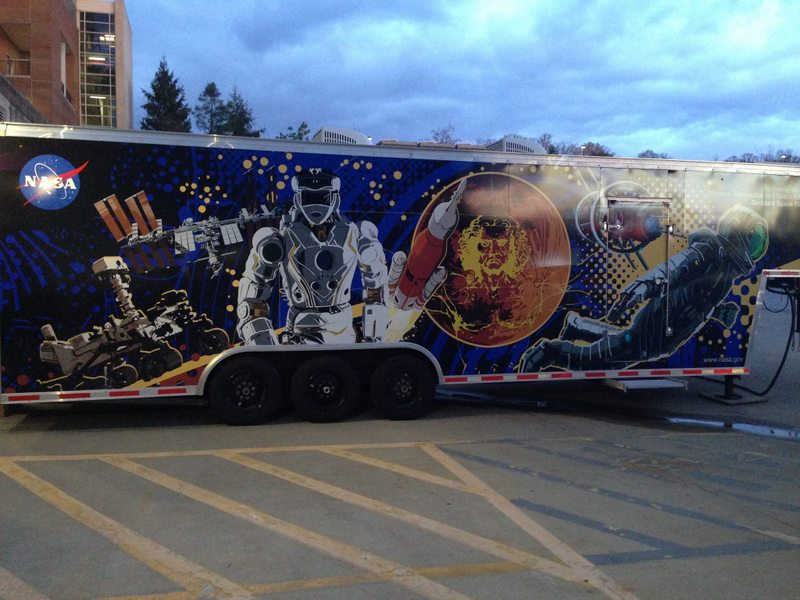

Please pay attention to all of the manuals. The only place a robot can be worked on at any competition is in the pits. No work can be done outside of the venue and brought in (such as after hours in a hotel room). The machine shop (or official venue machine shop designated area) is the only place welding can ever occur.
Look for this IN the pits at Worlds.

As I recall the NASA machine shop was setup for MIG welding, not sure if they had TIG there.
