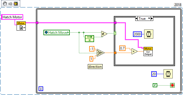

We’ve been having trouble trying to get a timed action working. We’ve never had much luck with this, even when following Team 358’s awesome examples . We’ve searched different threads and tried many combinations of the instructions in those threads and the code still doesn’t work.
What we want: We want our hatch mechanism to rotate from a stored position inside the robot to a deployed position outside the robot, resting/stalling against a mechanical stop at either end of its travel. When a button is pressed, we want the Hatch Motor to run at -0.7 for 2 seconds and then at -0.1 indefinitely (securely storing the mechanism). When the same button is pressed again, we want the motor to run at 0.7 for 2 seconds and then at 0.1 indefinitely (securely deploying the mechanism).
This seems like an easy thing to accomplish in periodic tasks, but no dice. Here is our current labview code:
The button press boolean is written to a global variable in teleop and read in periodic tasks. The button works fine and the boolean responds as its supposed to, but the motor only seems to be executing the first frame of the flat sequence structure. What’s also odd is that there’s an irregular delay between when the boolean changes to when the motor reverses direction.
Don’t worry about the stall condition. We’re using a bag and only going to be stalling at low outputs. The Hatch Motor while loop in periodic tasks is duplicated to show the True and False cases, only one loop exists in the real code.
Thanks in advance for any help! We really appreciate it!

I am not a big fan of sequence structures - I always use state machines for a variety of reasons. One of which is because I only ever want ONE “set output” VI for each motor anywhere in my code, ever.
I insist on being able to probe the input that runs into my set output vi for debugging - and with multiple set motor vi’s you have to search around to the one that might be running at that given time.
But I suspect what may be happening is that you set the output for 2 seconds, and then it only executes the second frame for 1 loop before returning and starting to execute the first frame again for another 2 seconds. It’s probably so quick you don’t realize it’s happening.
Another thing - you’re seeing that wierd delay because the sequence will not release it’s priority until it’s done, so it doesn’t get out of the sequence so it can’t re-loop the outside loop to look at your button press. You ‘locking’ it into that frame for 2 seconds.
Does that make sense?
You could test this theory by putting a 2 second wait in the second frame.

I think Tom_Line hit the nail on the head.
You need another while loop in the 2nd step of each sequence structure around the “set Output” to -0.1. Add another timer block for 20 ms in it also and then set the Stop input for the while loop to the “Hatch Move” variable. It should loop setting output to -0.1 until Hatch Move changes to the other state. Note that you’ll need to do this for both the true and false case and one of the “Hatch Move” variables will need to be inverted to stop the while loop.

You actually seem to need more cases than you have accounted for.
Each time periodic tasks evaluates the outside loop these seem to be the cases you want:
  1. Move hatch in true case one time
  2. Stall hatch in true case all other true times
  3. Move hatch in false case one time
  4. Stall hatch in false case all other false times
There is an easier way to do this, give me a second…
Maybe something like this (it’s a snippet, so you can drag onto a block diagram to see the False case, which is just a .1 set motor x the direction, i.e., the same motor set using .1 without the delay):
ToggleActions
#6
Thanks to everyone for all the replies. Mark’s solution worked great! We still plan to try to get the sequence structure to work in case we have a situation with more than two conditions in the future.

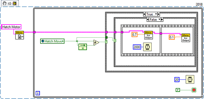

#7
The sequence case can be made to work by letting it only trigger once (i.e., the first time only) in the True case, and once in the False case.
The error was it kept executing over and over when True (or False).
So you needed a case around the case.
Then only enter the outer case when Hatch Move doesn’t equal the previous Hatch Move (Feedback Node).
Something like this:

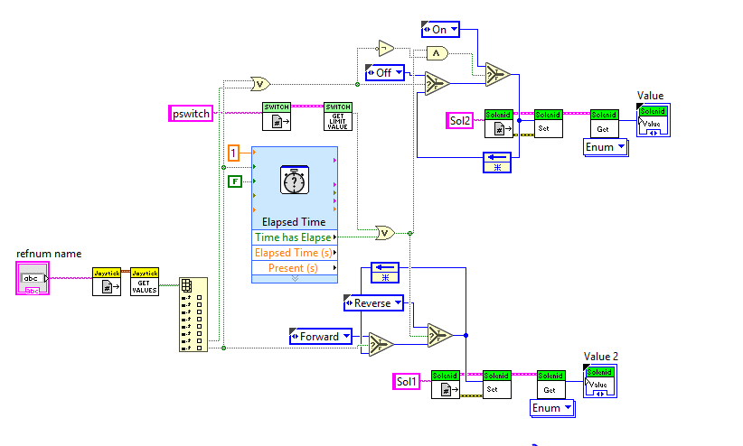

#20
@apm4242
Here is the code that I used for a pair of suction cups:
as you can see, I used a timer function. This allowed me to input any float (in this case 1), and then it sent me a true value if the time had elapsed, without having to stall the whole vi. (It’s measured in seconds.)
The best part about this timer function is you can input a different value, depending on certain conditions.
