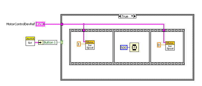

I’d suggest using a periodic loop for this. In the loop, check the button and wire to a switch. In the True case of the switch, turn on the motor, delay for the right amount of time, and set the motor speed to zero. Then return to scanning the button. To sequence the motor on/delay/motor off, you can use a dataflow dependency or a sequence structure.
As with the other periodic loop, put a delay in it to read the joystick at 50Hz or so.
Greg McKaskle
In addition to what Greg said, you’ll want to keep track of the last button value so you don’t do it over and over again. To do this, use a shift register and wire in the button value. Use one of the Boolean operators to make sure you execute the code only when the button is true and the last button value is false.
Is there any chance to receive a screenshot on what you guys mean? I’m not sure if I’m doing it right… the result is that there’s no delay, and that the switch keeps on moving only if the button is being held.
I hope this isn’t too late, but here it is. When I actually did it, Greg’s way means you don’t have to keep track of the last value because it doesn’t matter, once the button is hit it delays for the right time and then returns, ready for another one.
I’m attaching both a screen shot and the vi. Hope it helps!

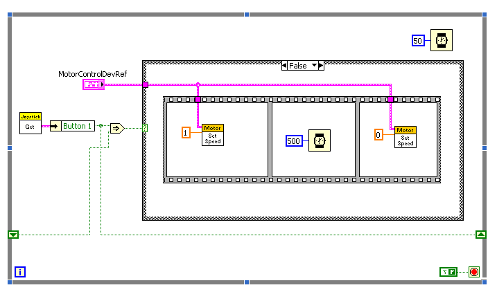

Thanks for the kind words, assaf2b. I would really hate for it not to work, so I quick tested it and found something that could be changed. I think if you use that code, it would keep the motor going until you released it, then wait and stop. I don’t think this is the result you want, so I’m posting a revision of the code.
This time I took my own advice and stored the last button value and only took action when the button is true and the last value is false. Then when I ran it, it set the motor, waited the specified time, set the motor to zero, and didn’t do it again until I released the button and pressed again. I think this is the behavior you want, so here is a screen shot and vi. Just drop the while loop into the Periodic Tasks vi, hook up the motor and joystick, and you should be good. I have tested this on the front panel and works as advertised there.

Ah well, it didn’t work. But hey, who cares, we’re going to Atlanta! Rookie All-Star award, and 2nd place in our country’s competition.
What I did was move the opening reference of the joystick from Teleop Init to the Begin VI, add it to the Periodic typedef, insert your code in the Periodic VI, and yet it didn’t work - whenever the button was held, the motor kept going with it.
However, as I said, we’d all like to thank you regardless of the results.
