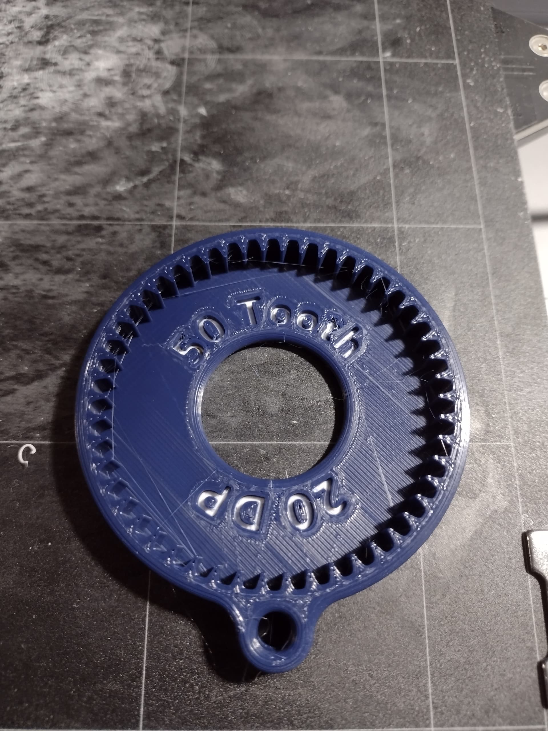

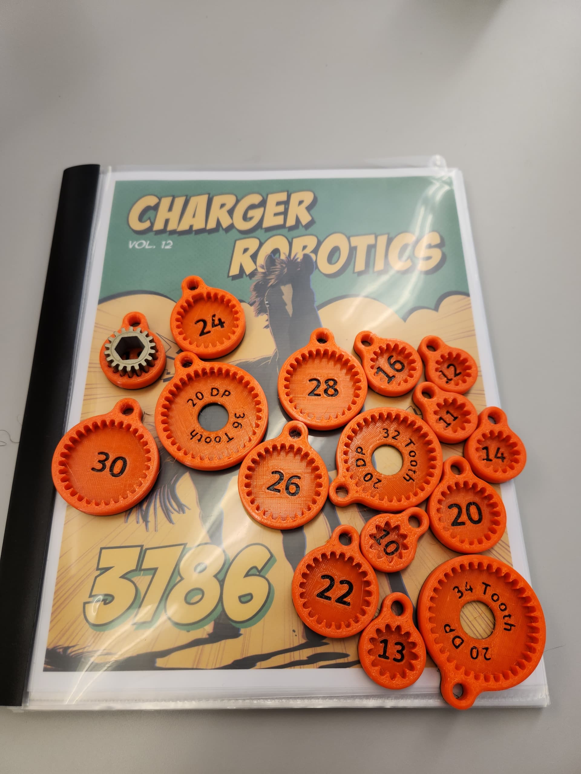

Inspired by our nut and bolt size checker, I created these models to avoid counting teeth on gears. Printables

I went ahead and printed one of these off on my dual-extruder (because why not?) Snapmaker F350 just to test it, overall I’d say it came out pretty good, but my main suggestion would be to, where possible, use font that is larger/bolder, as the lettering on some of these can be a bit hard to read, even when using two different color materials.
Now I just have to see if it will fit a gear the next time I’m in the shop, or if I’ll have to scale it up a bit.

Thanks for the files!! I printed a batch to try out and they work great. I think I might make a rigid “Tree” for them to fit on that can live near our storage area so you can quickly try out sizes and they are easy to manage.
