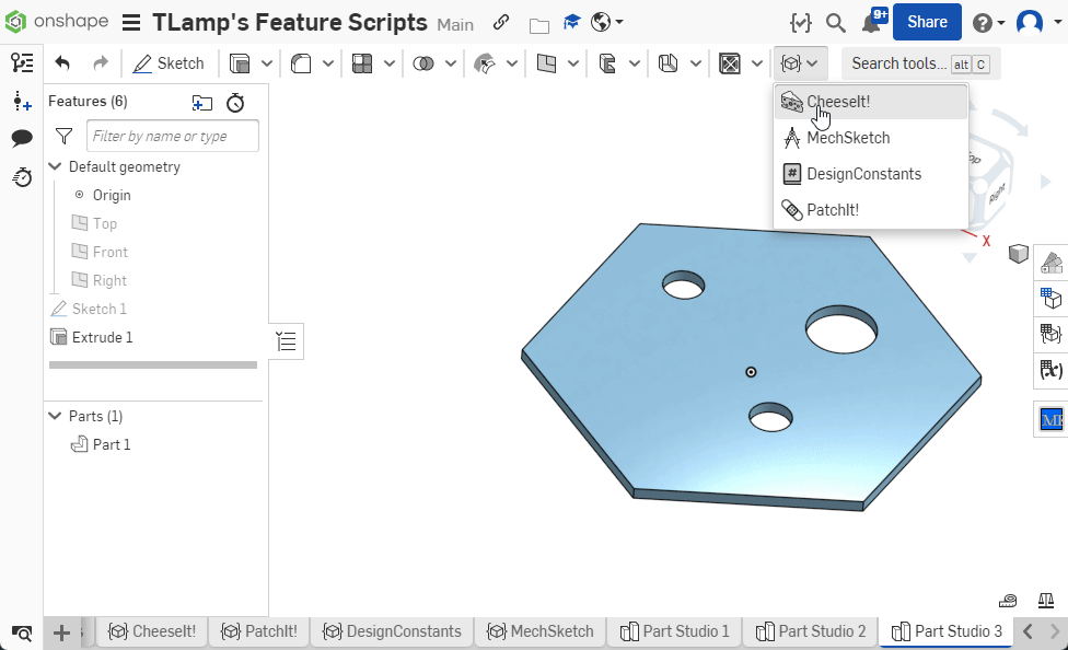

CheeseIt! - Auto weight reduction pattern
CheeseIt! automatically applies a isogrid/hexagon/circle weight reduction pattern. It works around part features such as bearing holes and whatnot. In its current state, the script’s automatic grid generation is inefficient but works. It is usually faster to define your own grid in the advanced tab.
chrome_RmyCAAbNbm

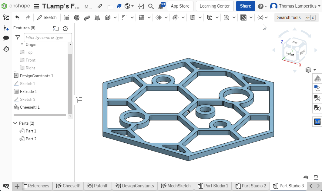

PatchIt! - Used to patch pockets from CheeseIt!
Sometimes the CheeseIt! the script will generate pockets that aren’t ideal or will cause some intended holes/part features to separate/float from the actual part. PatchIt! will patch said holes. The current version does not support sheet metal.
PatchIt

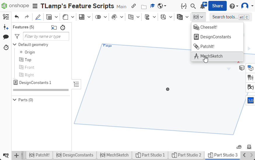

MechSketch - Imports sketches of COTS parts and pulley/gear generator
Given a plane and an origin MechSketch will import a sketch of a COTS FRC part or you can generate a sketch of a custom HTD5M/GT2 pulley or spur gear. These featurescripts combine the functionality of several other public featurescripts.
MechSketch
