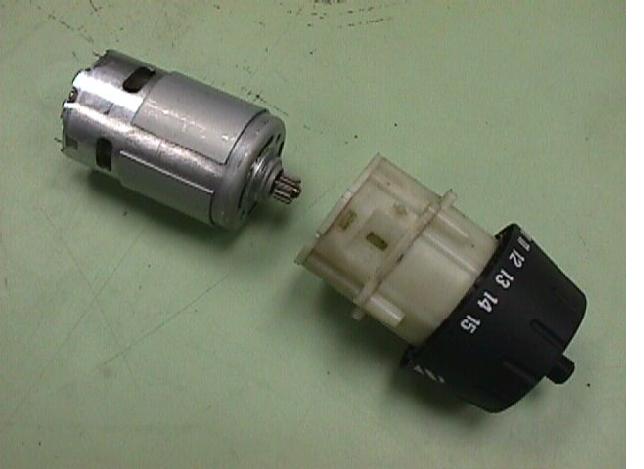

I’ve heard from some of you that change gears refer to the Bosch gearbox, do guys mind telling me what that is, since my team is interested in switching gears for this years competition :slight_smile: Thanks!
The bosh gearbox is also referred to as the drill motor gearbox. it is pictured below. It has a shifting mechanism that uses a shift lever and two sets of internal planetary gears. High speed gives 1000 rpm and a stall torque of 10Nm and low speed gives 300 rpm and a stall torque of 29 Nm.
www.team696.org/motorspecs.html

We should remind everyone of the locking pawl in the drill motor transmission. There is a white paper on this board about how to remove that little tooth. With the locking pawl in place you are almost assured to breakout the transmission case during competition.
