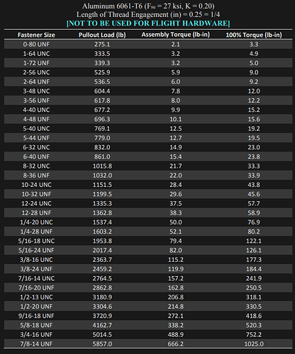

What are some of the torque specs for the things we commonly do in first? I know how tight things should feel generally, but I would like to know the numbers for some of it to help with explaining to the kids.
For example, the bolts that mount a motor to a MK4i swerve module. Or the bolts that mount them to the frame.
Mostly 8-32. 10-32, or 1/4 into aluminum

Torque values for different sizes and grades of fasteners are easily found on them internets.
NASA has a great paper on it. Here is the chart for steel English fasteners threaded into 1/4in thick 6061-T6 (very common in FRC):

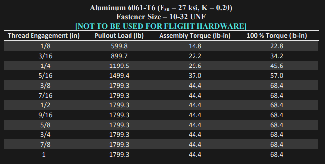

Also common in FRC, here’s a chart for toque vs thread engagement for 10-32s:
If you’re using properly sized nuts or another situation where the bolt is the weak link, this chart is great. Here’s a snippet:
