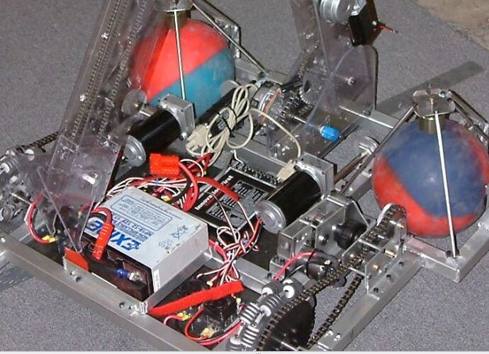

The title of this thread made me think of a drive system from the past*, using trackballs. I think the control for that was a joystick.
