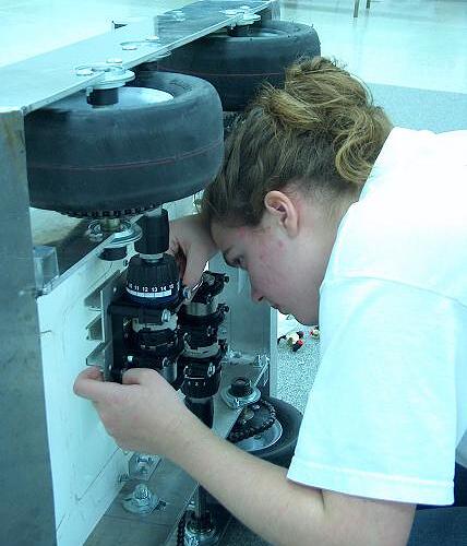

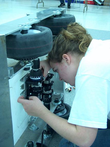

My thoughts would be two front gokart slicks and then for the back have a wheel with lots of forwards traction but not much side to side traction so you can turn. We used 4 gokart slicks last year. See the picture. We ended up putting caster on cyclinders to drop down when we wanted to turn a lot. We were reseting breakers. So these would be great for the front but find a better way for them to slide in back with out giving up the traction forwards. Maybe fully inflating them would help some though.
