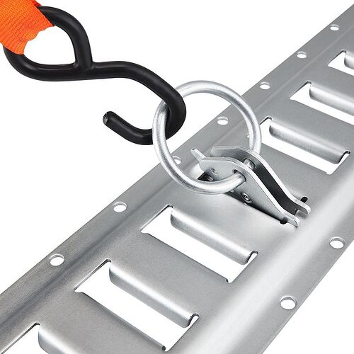

Be sure to get floor and wall strap rails like “E-Track”. You can then strap all of your workbenches, carts, robot to just about anywhere in the trailer.

Toolboxes are heavy, it is nice to have the flexibility to get the center of mass more or less over the axle of the trailer.
E-Tracks are so nice for strapping everything down. I consider them a must have otherwise you have to install a bunch of D-rings inside the trailer

Whatever you bring to competition, lots of E-track is good.

Thanks for the E-Track recommendation.
