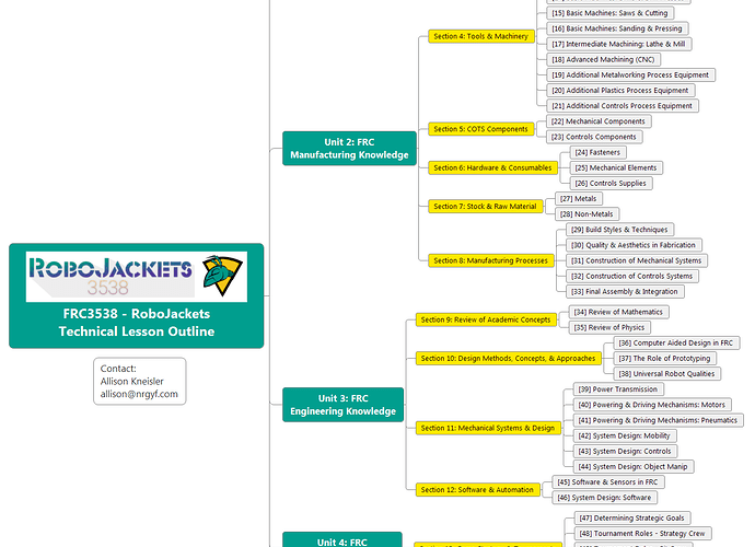

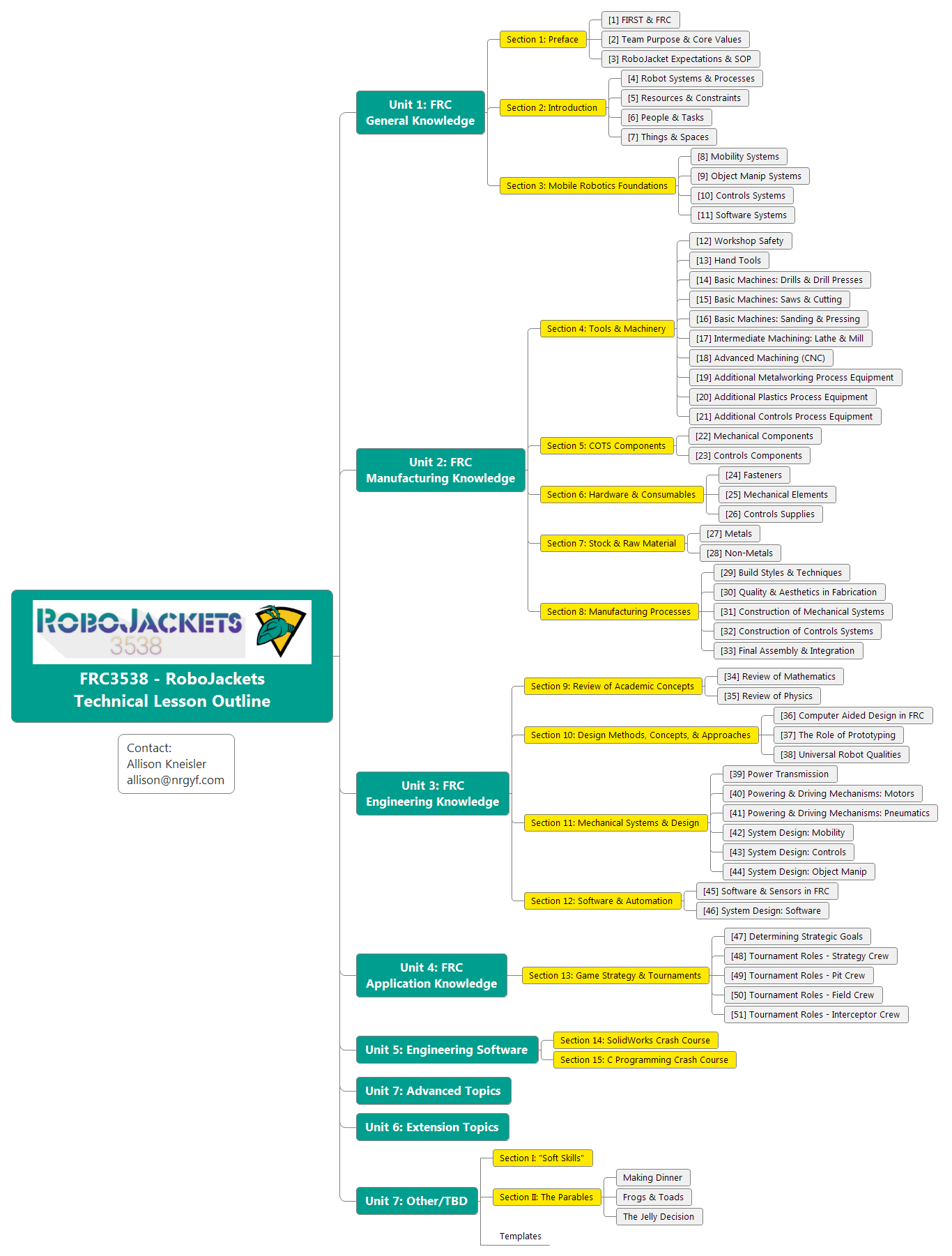

It’s a work in progress (as is just about everything I do), but see attached image for our general outline. My goal for next fall is to get everybody through at least lesson 33.

Allison, that is a really great diagram and pretty much exactly what I wanted to convey.

That looks like a solid plan. In what way do you plan to convey the information? Would that be mostly lecture style? Do you have small projects that the students would be doing to go along with the lessons, or are projects included in the lessons? Do you anticipate each lesson taking the same amount of time or is that more of a general overview?

That plan is amazing. I’ve been wanting to develop a curriculum for our team for the past few years to do over the summer and fall. If you don’t mind I started using your initial plan as a way to develop ours, adding more general team training and adding a business section. You can check it out in list form HERE.
What software did you use to lay out that image you posted? It makes looking at both big picture and details very easy.

I’ve been adding to this outline for the better part of six(ish, I lose track of time) years now, but my team is fairly young (third season this year) so our method for application is still evolving. Our first season (2014) I didn’t get involved until kickoff, so that whole season was trial by fire. For the 2015 pre-season everybody was more or less on same page, so we did structured four hour meetings weekly with the first two hours being lesson time and the second two hours being project time. Each two hour lesson block was split about 50/50 between lecture and laboratory work. For pre-season this year we actually ended up taking a bit of a step backwards as it was the first year we had to cater to both experienced students and rookies and that didn’t go over as well as it could have (we were also busy moving into a new shop, so we weren’t focused on training as much). I haven’t super thought out methodology going forward, but it’ll be a mix of lecture (presentation and/or video lessons), discussion based, laboratory work and activities, and workbooks and written assessments. I do know what I don’t want, for students to be disengaged or turned off by the curriculum implementation, or for the academic element to overshadow the project/maker space vibe.
As far as timing of the lessons it’s pretty all over the place right now. Some lessons just have a lot more content than others, and in some cases the group would get really into a lesson so we’d work on it for two or three days. Other topics we’d fly through multiple lessons in one day. We went in order-ish one year, and then not at all another and both worked out pretty well. There’s activities, lab work, written workbook style pages, and assessments associated with most lessons, but it’s all over the place in about 15 different documents and mindmaps and bits of pieces of notebooks/email drafts/etc. at the moment.

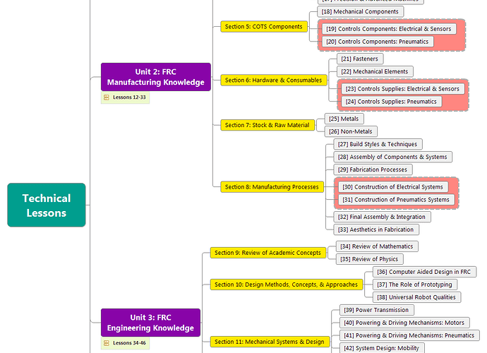

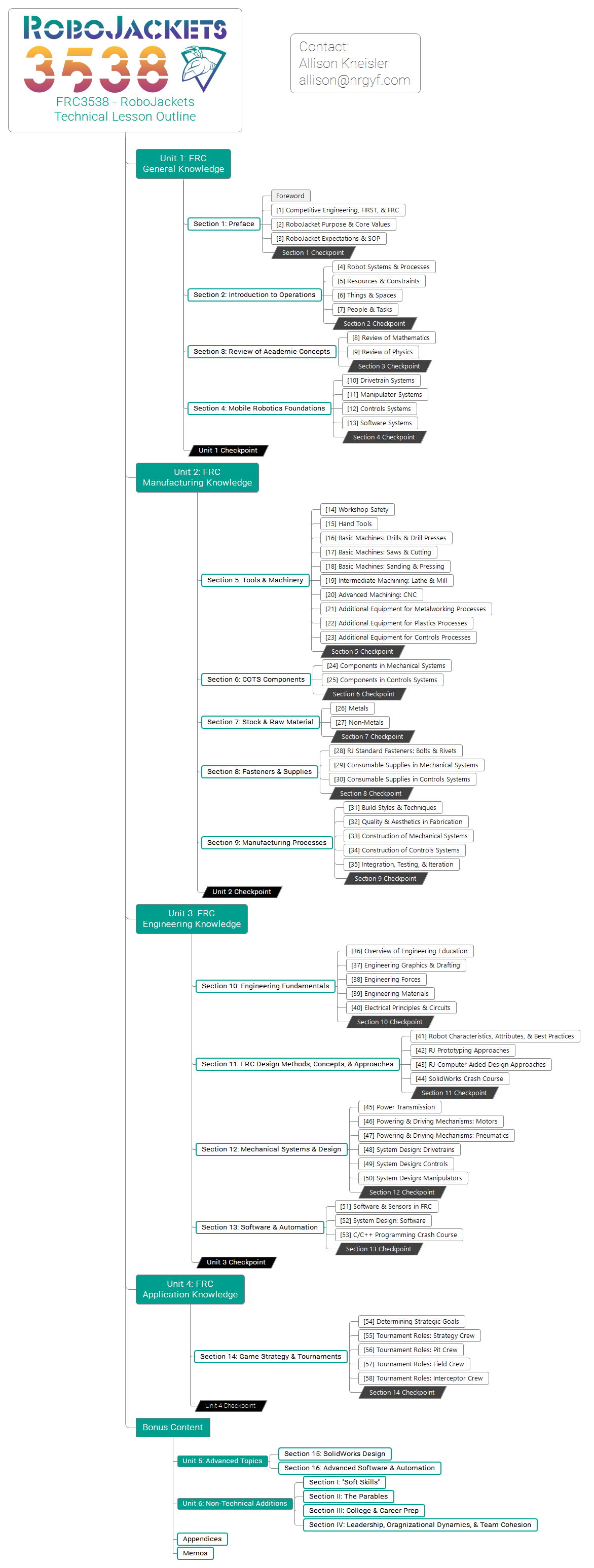

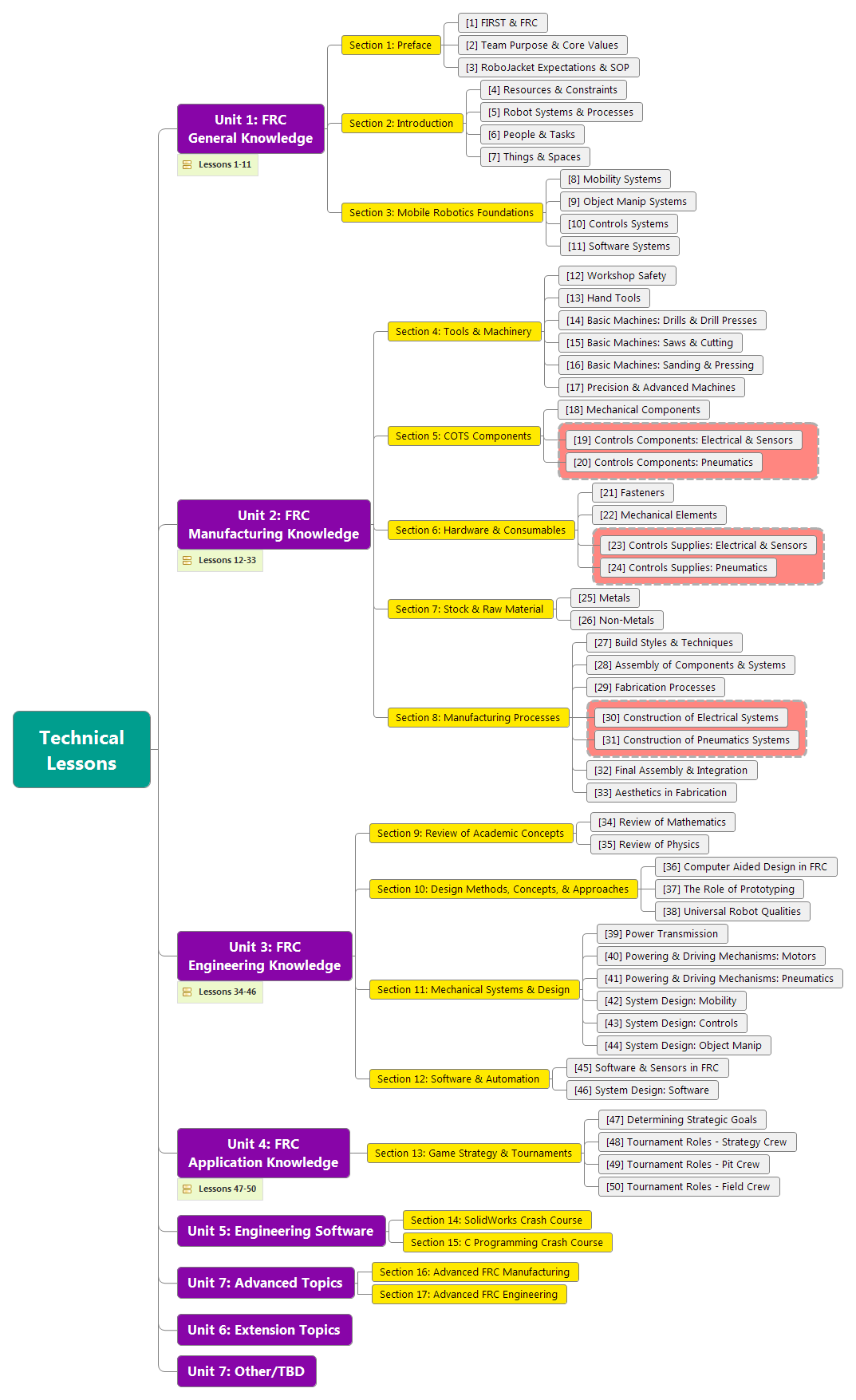

I attached a slightly more updated version and a partially exploded version of the main outline. Is anybody sees anything plagiarized please call me out on it! I’ve been trying to search back through my decades worth of notes and bookmarks to figure out where I got everything from. It’s a tedious process.

Software - I use XMind extensively. I have the pro version on a couple of my computers, but the free one is great too. Really I just use pro so I can extract my themes and use gantt charting, but for getting ideas down the free one is adequate.

I’ve attached an updated version of the outline I posted last spring, and a shared folder with a few different file formats is accessible here. Not sure it’s worthy of its own thread, so I’m reviving this one for context.
Most of the changes are minor. The review of academic concepts got moved into the first unit, a section on engineering fundamentals was added to the start of the engineering unit, and a few lessons were slightly shuffled or renamed.
