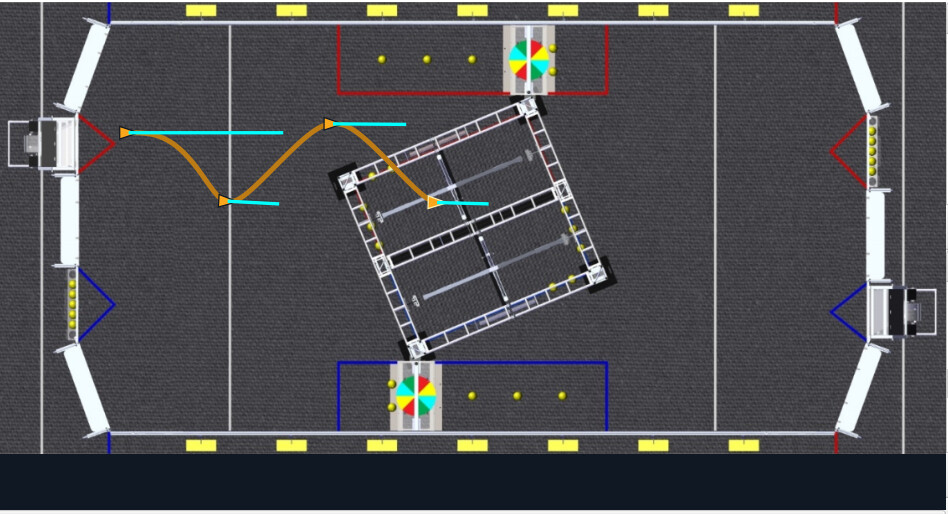

But when the Romi starts following the generated trajectory, it will only go part of the way before it shuts off, assuming it is done following the path. Ex. for a path about 7 meters in distance, it stops after traveling about 3 meters.
Code:
The code I’m using is very similar to
but is modified to use meters as encoder units. I linked an image of the PathWeaver trajectory I’m using for testing.

PathWeaver calculates how long each path should take to traverse. The robot runs for exactly as much time as the calculated trajectory traversal time. Unfortunately, the Romi appears to not be able to move as quickly as PathWeaver calculates that it should. Is the Trajectory class shutting down the Romi at the end of the allotted time?

I looked at your PathWeaver project and it looks like you have Velocity and Acceleration set to 3 Meters/second. For a normal FRC robot that is pretty common but that is WAY too fast for the Romi!
What constants would you suggest for the Romi?
I haven’t done a lot of testing with it. I would plot the velocity (in m/s) and then run the Romi at max speed. That will give you an upper bound. I would adjust down from there based on the type of trajectory you are running.
In the example you linked above it looks like ZQ uses:
public static final class AutoConstants {
public static final double kMaxSpeedMetersPerSecond = 0.8;
public static final double kMaxAccelerationMetersPerSecondSquared = 0.8;
which seems much more reasonable
Adjusting those 2 constants down lower seems to fix it! Thanks all!
