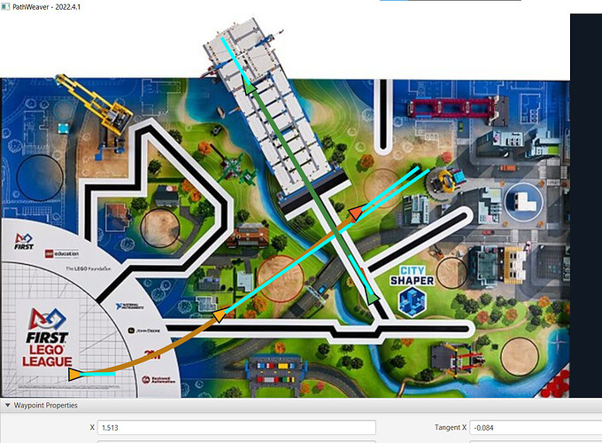

Also, because I’m using the same trajectories as WPILib, it works with Pathweaver. I created a custom game image, and made a fairly simple mission:
And here’s the actual run:
Again, it’s not perfect, but it’s definitely close. With actual models on the field to align to and reset odometry with, it might even be useful!

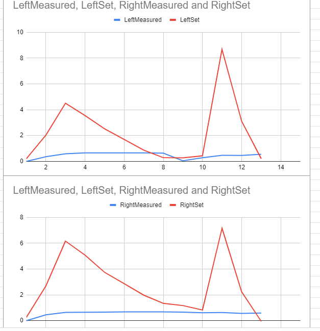

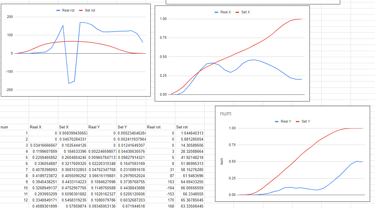

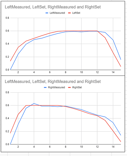

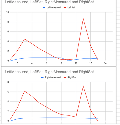

At one point, I had mistyped the ramsete zeta parameter as 7.0 instead of 0.7— this provided quite the learning experience. Here’s some graphs of the controller-commanded wheel speed (Set) and the actual measured wheel speed (Measured) from when that was happening:
(The output was clamped to -1 to 1, representing -100% to 100% motor power)

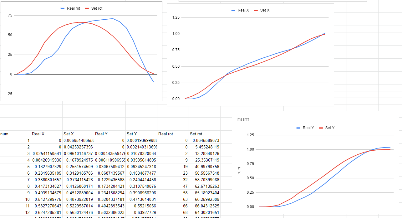

I also ended up graphing the x, y, and theta components of the desired and actual pose, giving some even more wild graphs:
Here, red is the current pose of the trajectory, while blue is the actual pose of the robot as reported by odometry.

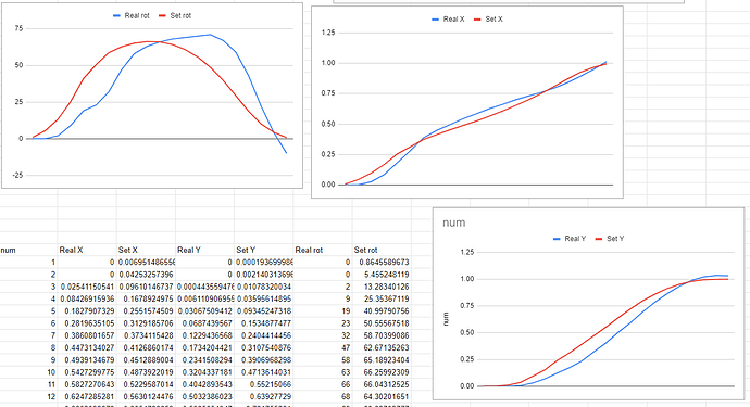

Eventually, I noticed the error, and everything started working again. As part of determining what was going on, I at one point had the ramsete controller disabled, which yielded this:
Close, but it could definitely use better feedforwards and/or an actual feedback controller.

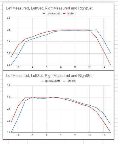

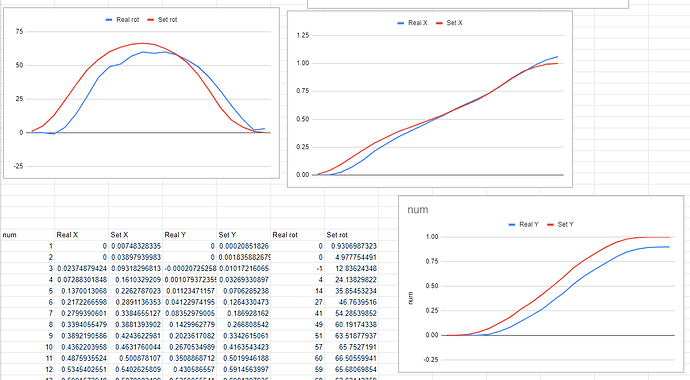

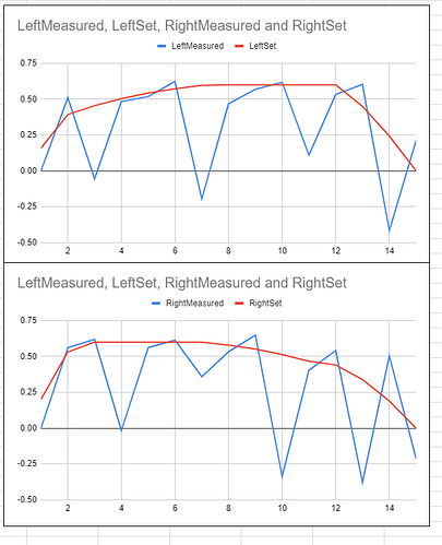

Once zeta was fixed, I reenabled the controller, and got this:
X and Y are much better, and there’s not much that could be done to improve the angular overshoot— it’s within the slop of the drivetrain ( (not-precise motors * large wheels) / small trackwidth)

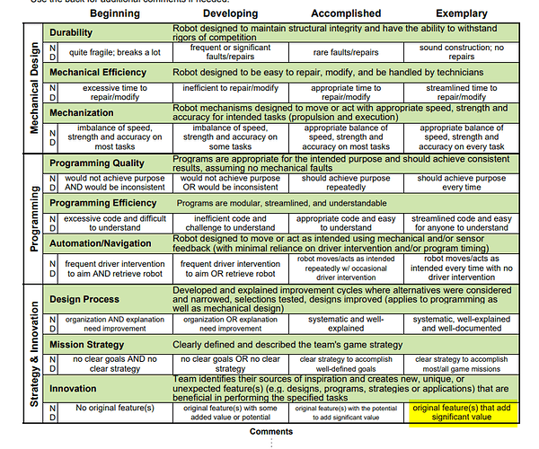

As you might guess, I was very excited when, still in FLL, I read this line of the game manual:
Sadly, this was my last year in FLL, and otherwise stuff like this might have appeared at competition.

Our team has an interesting approach to RDES. Each member would say something about the robot, and then I would talk to the judges for the rest of the available time. We won the RDES award almost every year.
Too bad that’s the old rubric.
<insert rant about how they reduced from five possible levels to really only three, reducing the possible differentiation between teams and making the judging process harder>
Tell us more stories about the old days granddad!
Edit: Ohh yeah, this thread was about Wesley and how awesome he is. I’ve already offered James my right arm and he told me my right arm was more useless than my left one… and we all know how useless that one is.

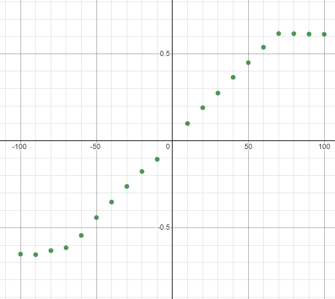

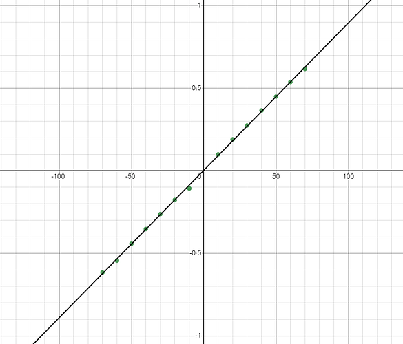

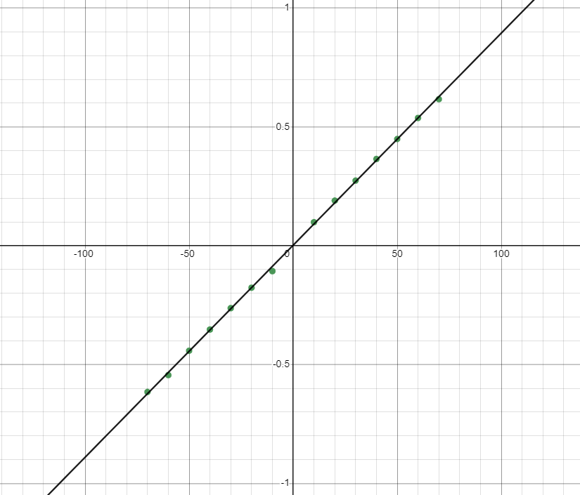

Characterization was an interesting experience without the SysId tool or a very clear understanding of how it works. The direct measurements, wheel circumference and trackwidth, were easy enough; I actually already had them for the driving functions I had made previously (Follow a heading for a distance, or until colliding with something, or until reaching a line, drive an arc, turn in place, follow a line). After re-reading the Trajectory Tutorial section about characterization, ks and kv were easy to find, with the knowledge that they should be in Volts and Volts * Seconds / Meters, respectively. Although, instead of working with volts, I’m using motor percentages, so the range is -100 to 100. This doesn’t actually change anything significant; you just make everything that cares think it’s dealing with a 100V motor. Anyway, mimicking/reverse engineering the quasistatic test was easy (measure the speed at various different power levels), and gave me this graph:
X is applied power (%), and Y is measured m/s.
This graph also provides another useful value, max speed. It’s about 0.6 m/s.

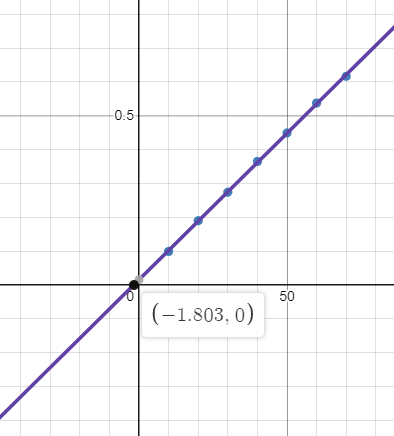

Because the forward and reverse datasets line up so well, ks must be effectively zero— which makes sense, because the wheels are direct drive off the motors, and this test was done on a nice smooth floor. Separating the datasets confirms this, as ks should be the x-intercept of the regression line:
ks definitely isn’t negative.
Because of this, the entire dataset (minus the bits at the end where the robot was at max speed) can be used to calculate kv. It’s the inverse slope of the regression:
Now that we have wheel circumference, trackwidth, max speed, ks, and kv, what’s next?

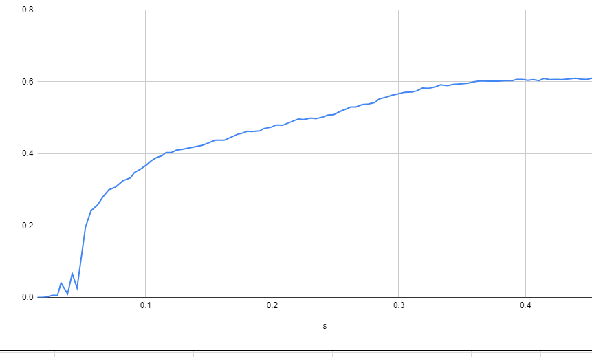

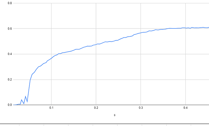

I tried to imitate the dynamic test by setting the power to 100, then rapidly measuring the actual speed. I got data, then has no idea what to do with it. This graph, with time on the x-axis and speed on the y-axis, gave me the value I ended up using for max accel:
I used the two points on either end of the steep bit of the graph, and found the slope of the line between them, giving a max accel of 20m/s/s. High, but believable, considering how light the robot is.

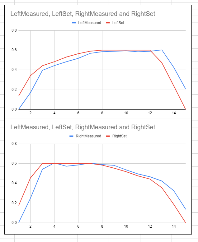

Fortunetly, I can use the SysId tool to calculate kp; in theoretical analysis mode, it needs ks, kv, ka, and max voltage, and it gives out a kp value. The response initially wasn’t great; here’s the wheel speed graphs again, with kp ~ 0.6 and no ramsete:
It’s close, but could be better. That’s when I realized that SysId has a maxVelocityError parameter, which was set to 1.5 m/s. Twice the max speed of the robot. Setting it to 0.1 gave a kp ~ 1500. I decided to try it anyway, with predictable results:
I started slowly increasing the velocity error parameter, which decreased kp (seemed like exponential decay), until I got these graphs with kp ~ 15:
It’s at least a little better.
