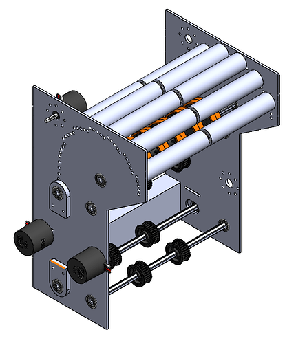

Our Amp/Trap Outtake prototype group is currently working on designing a trap mechanism that uses a 180 degree turn to score in the trap while ONSTAGE.
how will it open the trap’s door?

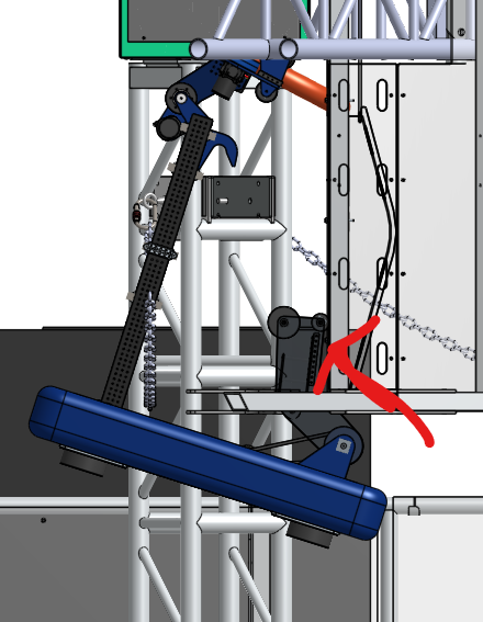

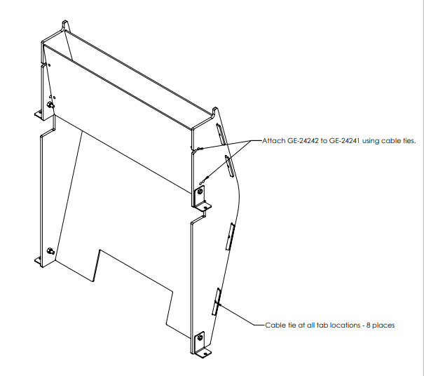

Yep, shooting is not going to work. If you look at the chute, behind that flap.
See those two little ears up top. They stop the flap from moving back more than 3 inches. The only way you could feasibly shoot into it is if you were above it shooting downward.
(assume hook on bottom)

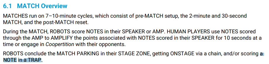

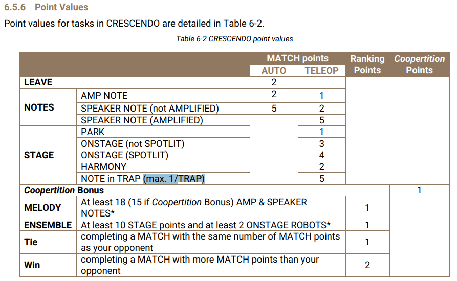

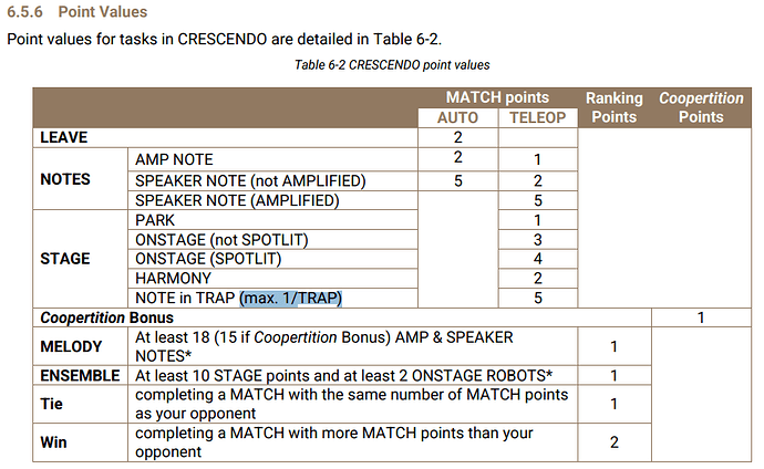

Why would you specialize in only the trap? wouldnt these rules indicate that you can only score one note per trap in endgame? so you would specialize in something that can only get you a max of 15 points if your cycle times are fast enough to score 3 times in 20 seconds? it seems like something not worth specializing in.
I feel its something worth specializing in mostly if you’re a RP team. Also at early competitions it would be useful to just not worry about guaranteed climbing points. I do agree that specializing here is a lot less useful than something like the Amp.

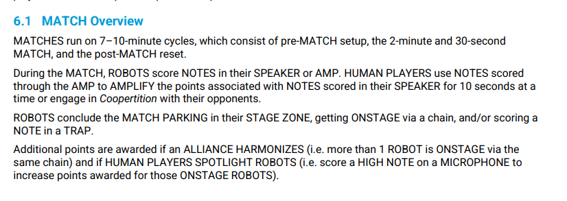

There is nothing in the rules saying that Notes can only be scored in the Trap during the Endgame.
I think what he means is that per trap slot, u can only put one in; meaning for an alliance, the max trap notes they can place is 3
That wasn’t what I was responding to.
He’s saying that you’re scoring 15 points in 20 seconds. I’m saying that the “20 seconds” part of that is incorrect.
Given the Trap’s scoring methods, you’re likely to also end up with 18 points (Onstage).
Given other things on the field similar to the Trap, I suspect more notes overall can be placed with the same mechanism.

It’s worth noting that the amp and trap r extremely similar, the trap just has a flap
We werew wondering the same thing on the other thread. Never says you cant score endgame points before endgame. My reading comprehension seems to come up with you arent as protected as end game. Youre only protected when you’re in the air not in the area.

You only get the climbing RP if you have over 10 stage points and at least two bots off the ground. So even if you score all three traps, if you are the only bot on the alliance that can climb, you’re not getting the RP.
I was more so talking about the actual points associated with the climb, not rp.
