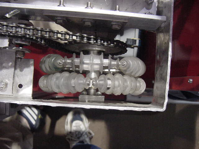

Okay, time to brag just a little about 122’s drive train. We have four wheel drive and love it. The downside to having four wheel drive usually is turning - wheels have to slip side-to-side and the center of rotation is around the center of the robot. We however, through an incredible amount of labor, made omni-wheels, or regular sized wheels with many smaller lexan wheels that spin side-to-side. The result is that our robot had absolutely no trouble going up the ramp with two loaded goals, but could still turn quickly around its rear wheels. Our rear wheels can then also have as much traction as we can give them, without having to worry about being able to turn. The ridges in the mini-casters also helped a lot in being able to climb up over the wood block under the bar.
~Tom Fairchild~, who’s getting off his high horse now. :wink:

We, or actually Mark Koors first came up with the front wheels for our 1998 machine that would slip sideways easily while having good fore and aft traction . We were able to run much “taller” gearing with these wheels than with four wheel chair wheels. We used similar front wheels, but of simplified design in 2000.

Those side slipping wheels are cool, but just wondering. Did you run into problems with being pushed form the side? or on a sideways incline (I know you shouldnt have been sidewats last year, but it wasnt unheard of)
Just seems that while nice they would allow you to be pushed around alot.

We used the side slipping wheels on the front of our '98 and '00 machines, and the machines could be pushed sideways more easily than if the machines had wheel chair wheels at both ends. It turned out that not much pushing occurred in the '98 game and most of the pushing was fore and aft in the '00 game. Your point is a good one, though. In a game where robots could be pushed sideways to advantage, the side slip wheels would definitely be a compromise.
