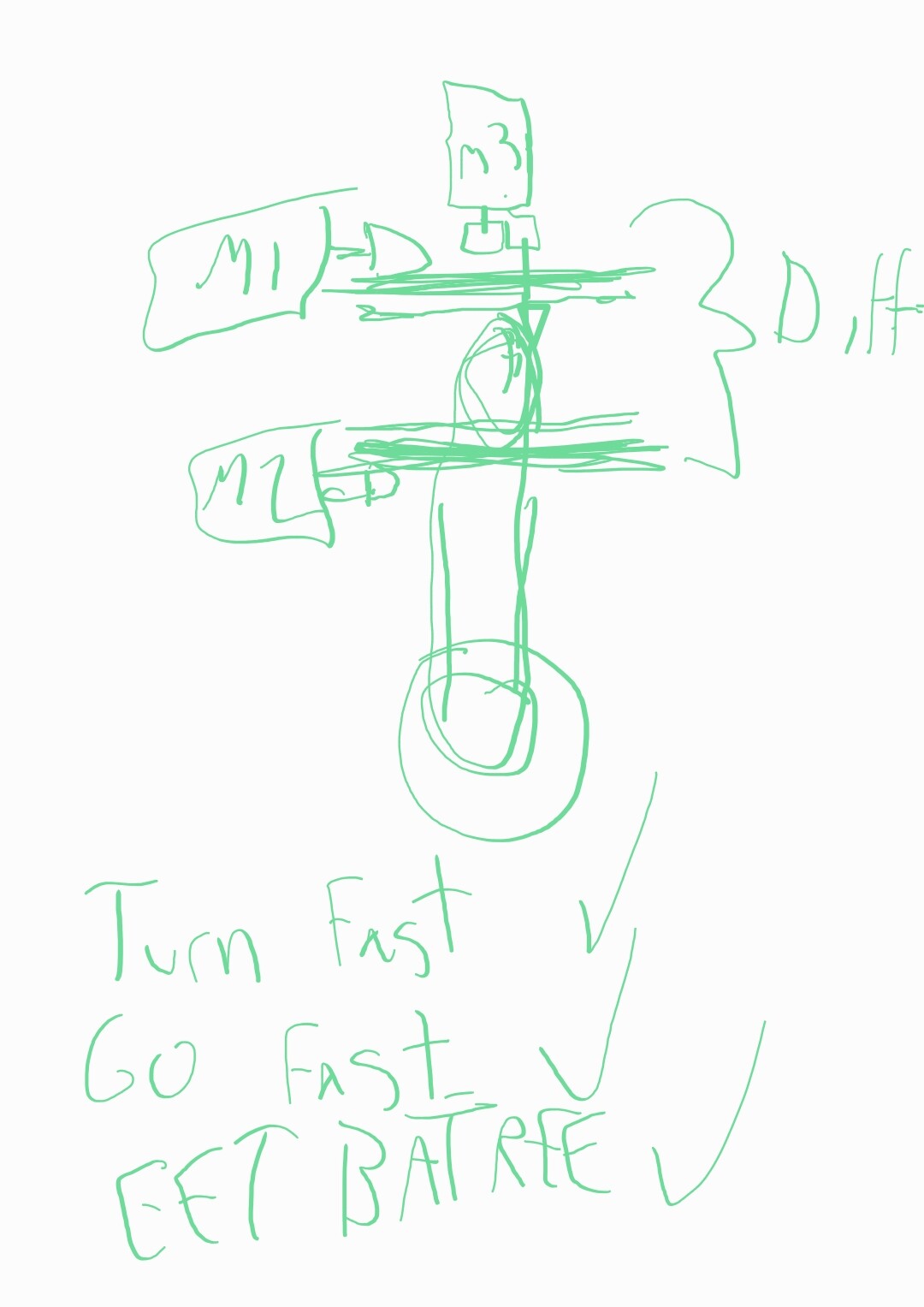

This is just a proposal but I have seen dual motor differential swerve from a few teams this year and high tide had a fantastic 2 drive 1 azimuth swerve setup which worked incredibly and I’m wondering what the mechanical feasibility of a tri-motor differential swerve would be, coming from a programming stand point I don’t see any issue with it and electrically just have to be careful for brownouts, so I was wondering if this idea is doable mechanically.

Mechanically or design wise, I’m struggling to see how three motors could achieve a differential swerve aside from just packaging two together for more power.

A three-motor differential swerve module is going to have the same mechanical design roadblocks as a three-motor differential drive. How many of those do you see?
Internet points to anyone who draws even an abstract linkage that does this sensibly.

Oh I’m well aware of the tuning challenges and I felt like taking on something new after building H-Drive systems from the ground up and trying coaxial swerve simulations with basic physics, I’ve already got an entire tool suite for tuning just for it, playing with current limits, spike limits, and voltage limits using the low level interfaces on the falcons should make it doable just a bit difficult. I’m really only concerned about how mechanically out of hand it could get to fit everything together, and I feel a little bad for all the batteries.
