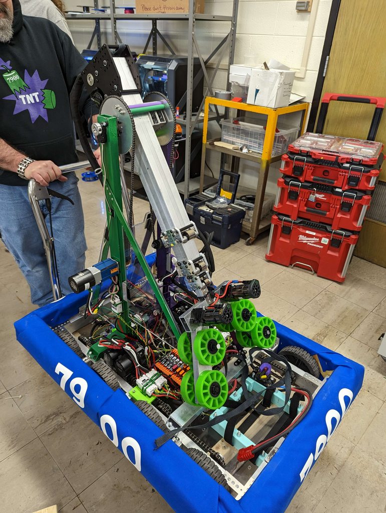

We demoed our robot C4 during open house nights at Case, REAL, and Washington Park High School (Park) to attempt to get more students to join the team. The turnout varied significantly between the schools, but we believe to have some potential students interested. We also did some code changes and repairs on this year’s robot C4.
We had a lot of issues with various joints of the robot being fragile and requiring repairs after nearly every match at the Wisconsin Regional, so we will be working on some training for the students to learn good strength practices. We also have been having issues with Rivnuts coming out, which was our major way to affix different parts to the tubes. We are planning on doing some pull tests with different brands and installation methods. But in setting up the test it was determined that the likely cause of failure was due to over riveting. It was noticed that instead of flaring against the inside of the tube, some of the Rivnuts would just expand the hole which caused significantly less holding force. So, the likely fix for this will be just training on how to install a Rivnut properly.

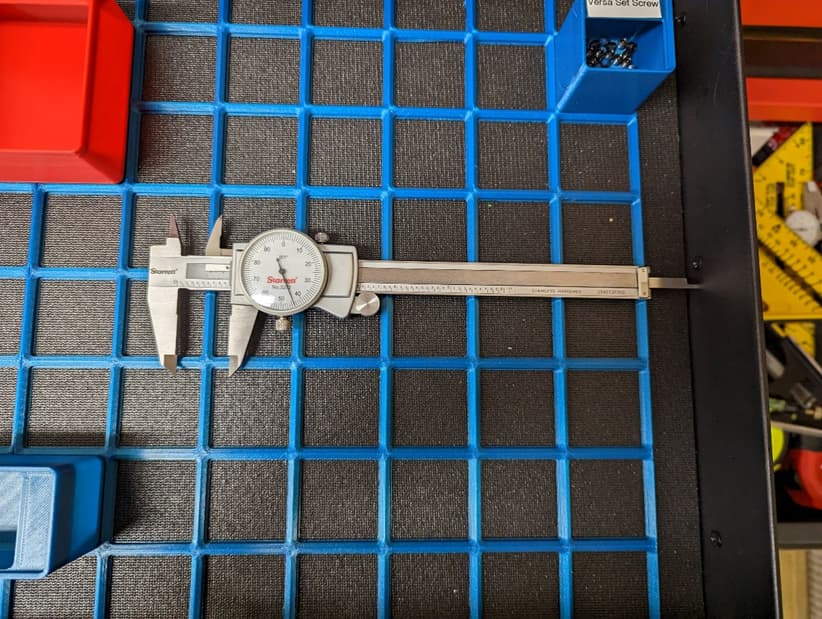

We are utilizing the Gridfinity System developed by Zack Freedman (https://gridfinity.xyz/). Gridfinity creates a grid of 42mm squares that allows organizers to slot into a grid baseplate. The current plan is only to Gridfinitize the hardware and fasteners drawer, as it has many small parts that can easily get lost and would benefit from labels and color-coding system. But there are other examples online of people doing their entire toolbox. You will likely see a lot of color coding from our team as this year we had some difficulty with technical communication, as many of our newer students are not familiar with many of the terms and what they mean, so it makes it simpler to ask for a ”Red” Bolt that is 2 inches long.
We started by taking inventory of the drawer. While taking inventory we made note of what grid sizing that set of fasteners needs. The basic Gridfinity bins have support for optional label locations and an optional scoop to allow for easier grabbing of small parts. We wanted to label
everything, so we only made note of whether or not we wanted a scoop for grabbing the parts.

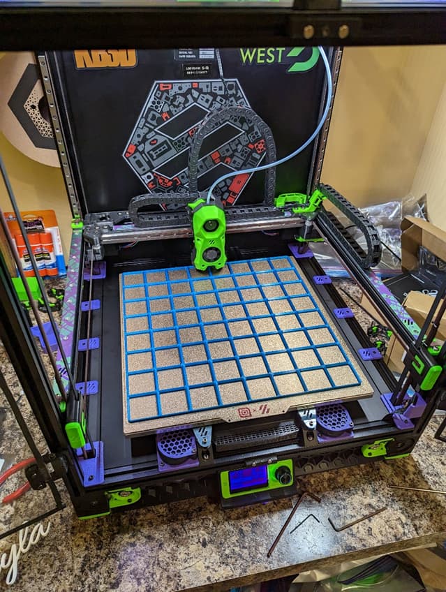

We unfortunately used a wide variety of fasteners throughout the season and plan to consolidate for next season, but did not want to immediately throw away the other fastener sizes in case we need to replace something on this year’s robot. We measured the drawer and determined the max it could hold is an 8x15 baseplate. The largest printer we have access can print 350mm x 350mm, so we had to split the baseplates into 8x8 and 8x7.
This left 24mm remaining inside the drawer that could not be taken up by a grid space that we will have to find another use for.

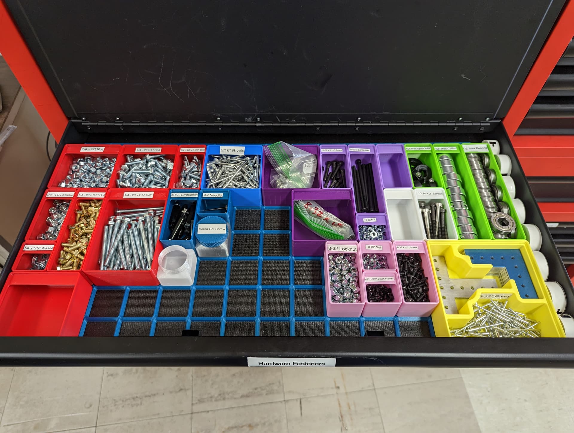

We printed off all the bins that we determined from our original inventory as well as a few extras. Gridfinitizing the drawer is still a work in progress, but part of the idea is that it is adaptable to what our needs are. In the process of gridfinitizing the drawer the mantra of what the goal is of the drawer changed a bit. Originally we didn’t intentionally store gussets, bearings, or shaft collars in the drawer, but we quickly opened up so much space we weren’t sure what we were going to fill the space with. We ended up making a custom container for L and T TTB Gussets with some rivet storage. We also used the additional space that the baseplates couldn’t use for rolls of label maker tape. The mantra of the drawer is now to store small important items that need to be grabbed quickly. So we will be adding master links as one of the items in the drawer.
Our measurements were slightly off, so the height of the bins are a little too tall for the back row. It is hard to see from the picture but the back row is not populated with any bins. The bins can fit there if you push hard as they will pop in just under the hinge, but it can be very difficult to take out, so whatever bins are used in the back row will need to be shorter. We accidently printed some purple bins that are a different color, so we will have to figure out exactly what to put in them, but we updated our color scheme to add Purple and Lilac. Unfortunately, we discovered that when a 1x1 has nothing next to it and only contains very light items, it can be accidently tipped over. So for light/small items we printed small bottles with a screw top. For style points we wanted to make the bottles as clear as possible with the cap matching the color scheme.
It took a few attempts to print the PETG as glass like as possible. We used these sources: How To Print Glass by Rygar1432 and Transparent FDM 3D Prints are Clearly Stronger to assist in dialing in the settings to make the bottles as clear as possible. We were not able to find what settings would give both a clear side wall and a clear base, so we will need to experiment with the settings to make perfect glass bottles.

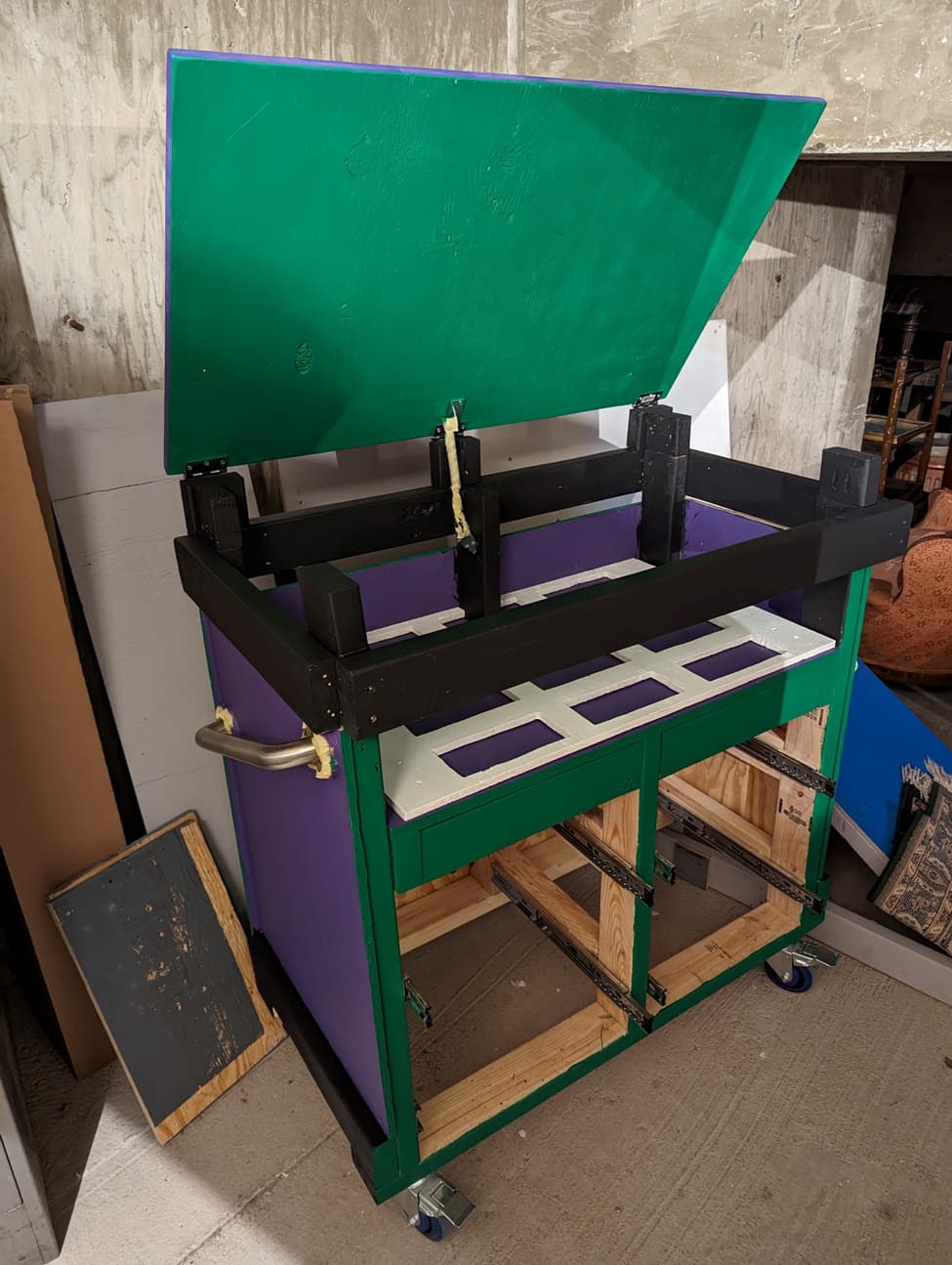

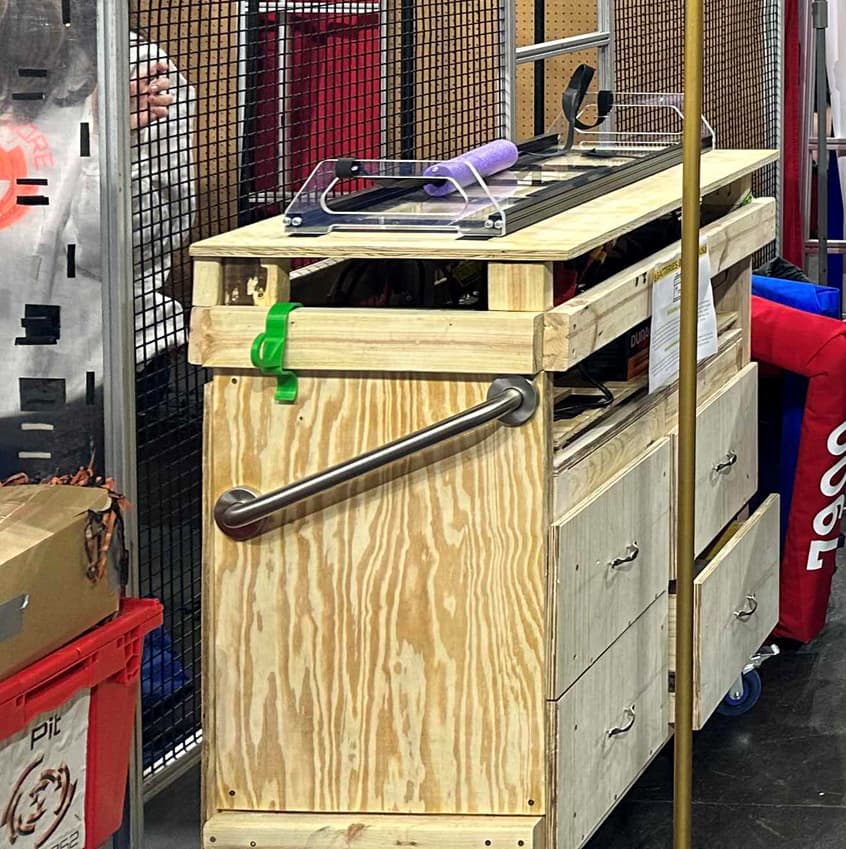

Our battery cart was a last-minute addition to our pit setup this year, so we did not get around to finishing it during the season. It serves multiple functions having a work surface when closed, charging all our batteries, and storage for the pit. The downside is that it is so large that it makes it extremely difficult to take to demos.

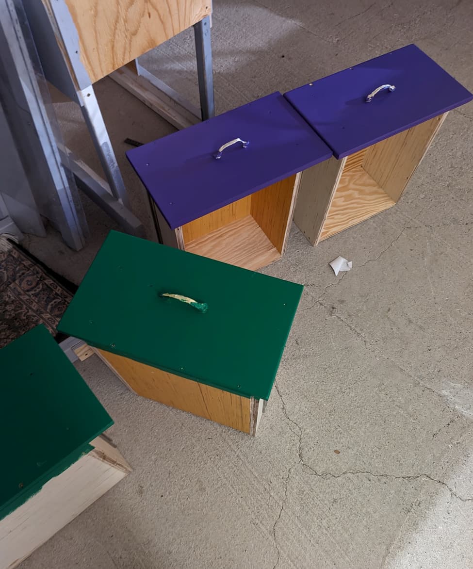

The Battery Cart is getting a coat of paint, hiding some of the imperfections, but giving it the TNT branding we are looking for. We unfortunately destroyed one of the drawer slides when transporting it for painting.
The other benefit of the paint is to provide a color code as it will be easy to identify, such as the top purple drawer.

We used to mount our driver station to the top of the battery cart in the pit, but that was sometimes awkward for the grabbing batteries since the top of the cart opens at an angle. Can anyone else share how they store their driver station?

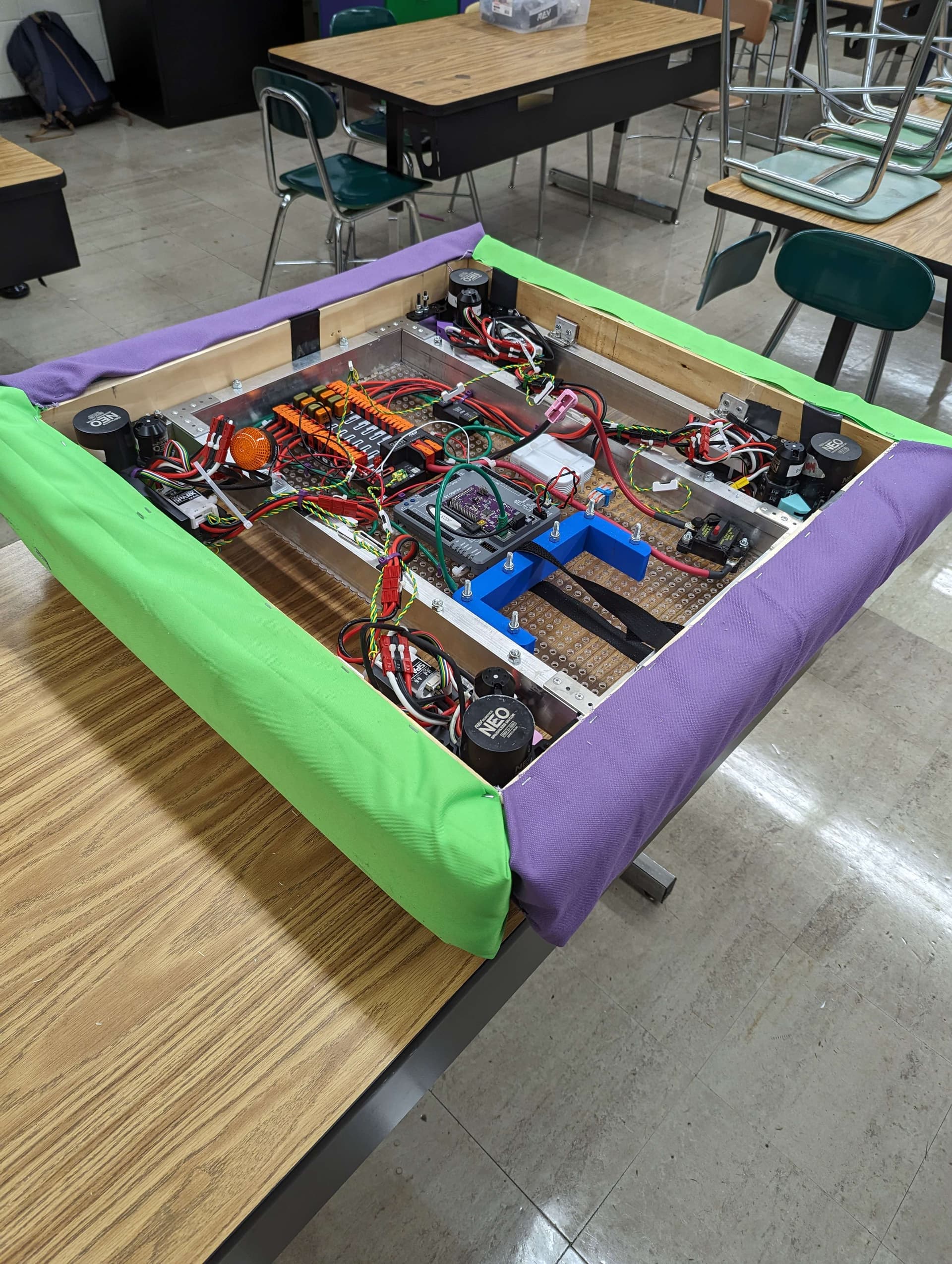

Our new off-season bot, Sidewinder!

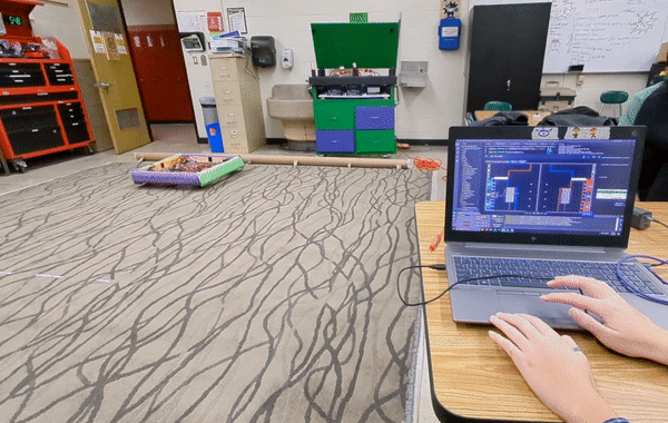

Sidewinder has been crucial to our team learning about Swerve. Since inception of the team we have used C++ as our primary language, but we never had a good reason for that so we have switched to Java for it’s popularity, but primarily because of the amazing YAGSL Swerve Library. (Yes I technically said Swerve Library Swerve Library). Last years robot code had no header files either, so we were basically writing C++ as Java anyways.
To our surprise we were maybe the first team to use YAGSL the NavX2 for the IMU. As we found a NavX library or firmware issue that should be solved for 2024. NavX Quaternion Units
The YAGSL Example was a great starting point as we developed the code for Sidewinder: GitHub - Trial-N-Terror-FRC-7900/YAGSL-Max-Swerve-Example
Our code differs in a few ways:
  • Uses WPIlib Auto Chooser
  • Alerts if YAGSL fails over to the relative steering motor encoder (Added to YAGSL Main)
  • Wont turn back to the starting rotation after auto (Working to add to YAGSL Main)
  • Working on adding AprilTag Pose Estimation using PhotonVision
