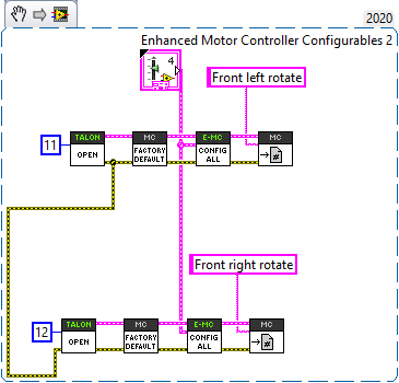

We have run into a frustrating problem and you could some advice troubleshooting. When attempting to load last years code with the updated drivers, firmware, hardware, etc. we found that the code would could go through the deploy process and then lose connection the moment the code is done deploy. The driver station still shows communication, but there is no robot code deployed.

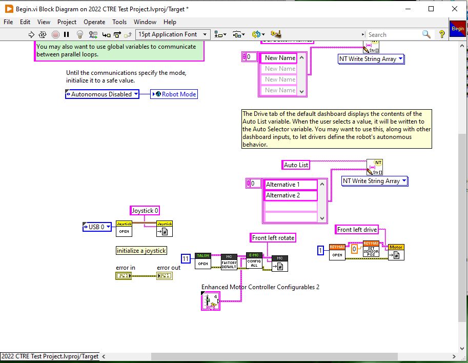

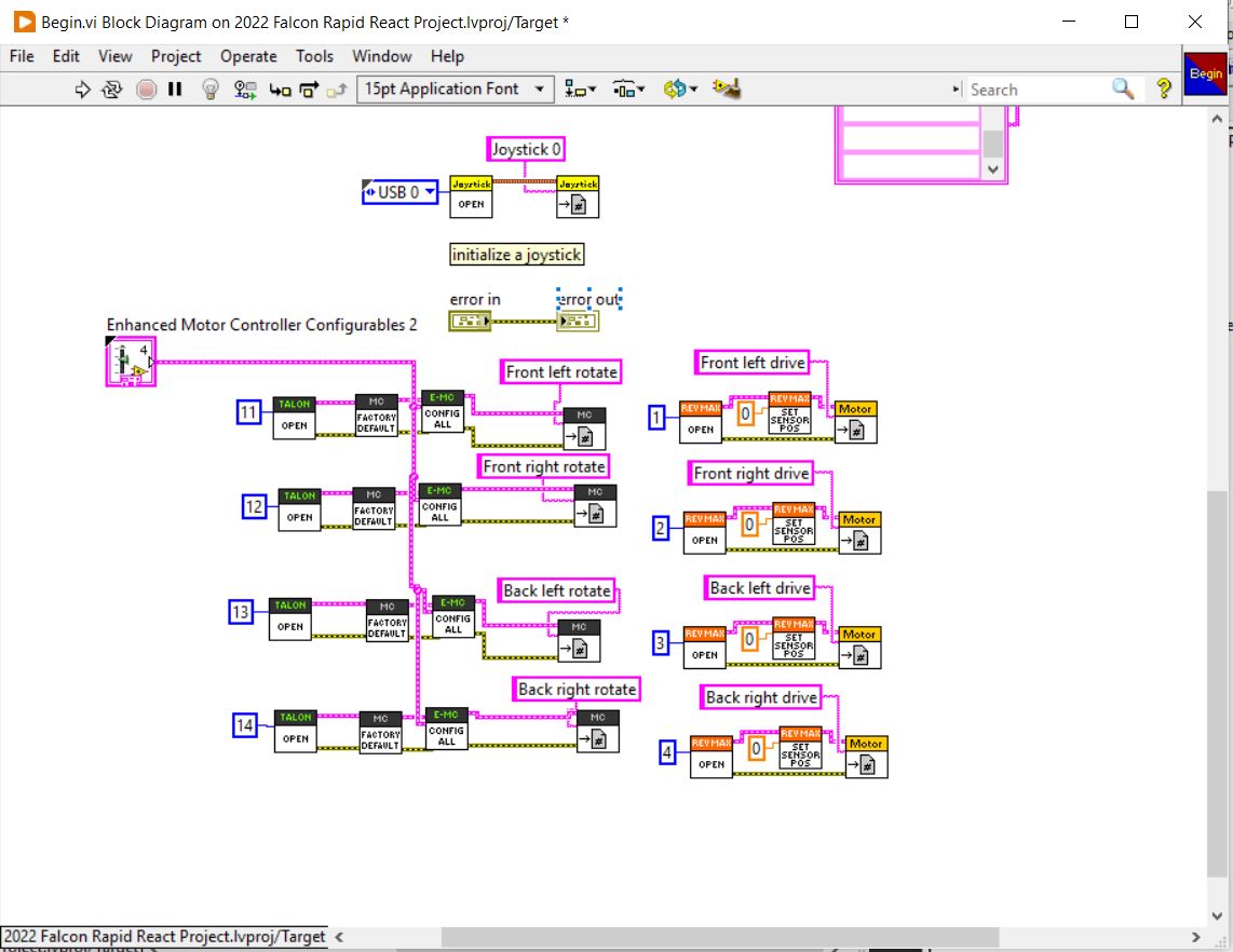

We spent the better part of a couple days tracking what was going on. The error doesn’t show up reliably, so it’s is really difficult to sort out. The key issue seems to be how many motors controllers are set up. Below are some screen shots of the begin program. The simpler one will run every time. While the more complex with either lose connect immediately after deploying or the Talon SRX controller won’t work.
Some strange symptoms. If I run the simple one first, the complex one will work. Once it works, I can redeploy it many times and it will always work. If it fails, it will keep failing.
Power cycling resets this. If I run the complex one after a power cylce it will never work on its own. Sometimes if I deploy the simple one, I can coax the complex one to work.
I have tried examples that have 4 controllers instead of 2 and 8 as in the pictures. Those example have a about a 50/50 chance of working.
All of these codes worked in the system last year. the problem seemed to occur after I implement the Talon SRX system on the roborio. But I can’t be certain that is problem.
I’m looking for advice on troubleshooting problems. This a pretty simple code and I’m struggling to figure out what is happening. Thanks in advance for any help.

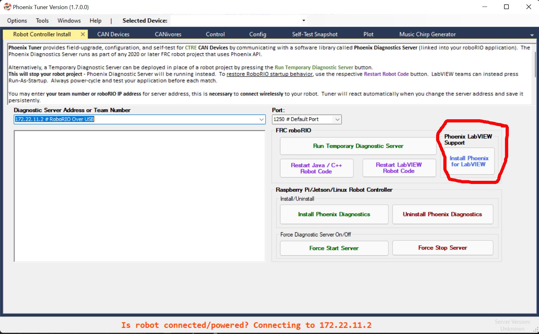

Immediate thought is did you use Phoenix Tuner to Install CTRE LV libraries on the roboRIO?
Thanks Mark. The installation of the Phoenix for labview is when the troubles began. Prior to that installation deployment seemed to work fine (except for error because of the missing code). After the install the code began to lose connection immediately after deploying it.

Maybe try chaining the Talon Opens, so they are forced to occur sequentially.
That might point to race condition vi settings deeper down.

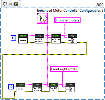

Just use the error output to force each Open to occur one at a time like this.
Chain Opens

I wouldn’t call it a recommendation to normally chain those. Normally, we wouldn’t have to chain those operations.
It’s a diagnostic to see if opening them one at a time affects the problems you are seeing.

Hey all,
We got an initial report of behavior like this last week and we’ve been working with some NI folks to figure out the issue.
We’re still troubleshooting to determine the root cause and what changed between beta and kickoff (whether in Phoenix or LabVIEW) to cause the issue, however the workaround is to chain all Phoenix Open VI error signals to force sequential initialization, as Mark referenced in an earlier post.
Note that only the Open VIs need to be chained, all other VIs can be used as normal.
We’ll have some additions to our documentation up today that highlights the necessary workaround.

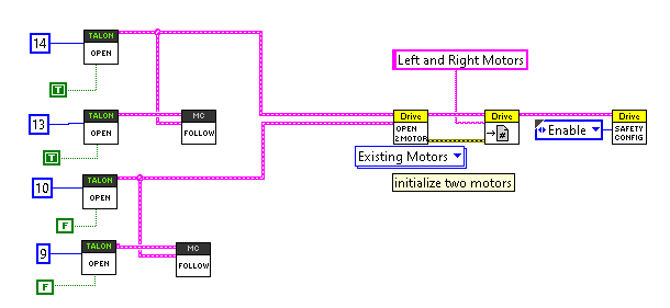

We are also seeing a similar but different problem when using talon srx.
  1. Sometimes it takes what seems like a long time for the robot code to restart after new code is loaded. (Same thing if you restart robot code, or reboot roborio.)
  2. Sometimes the talon SRX don’t drive. We are using 2 talon per side (one follows the other). These are connected into the standard existing 2 motor. Then using the standard update 2 motor VI to set output (We haven’t tried strictly using the CTRE provided code yet).
  3. Power cycling the roborio (not just rebooting), without deploying new code, seems to correct this.

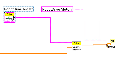

Here are screenshots.
Begin
Periodic
Network table values update, but motors don’t move. Motor reference appears to be good.
