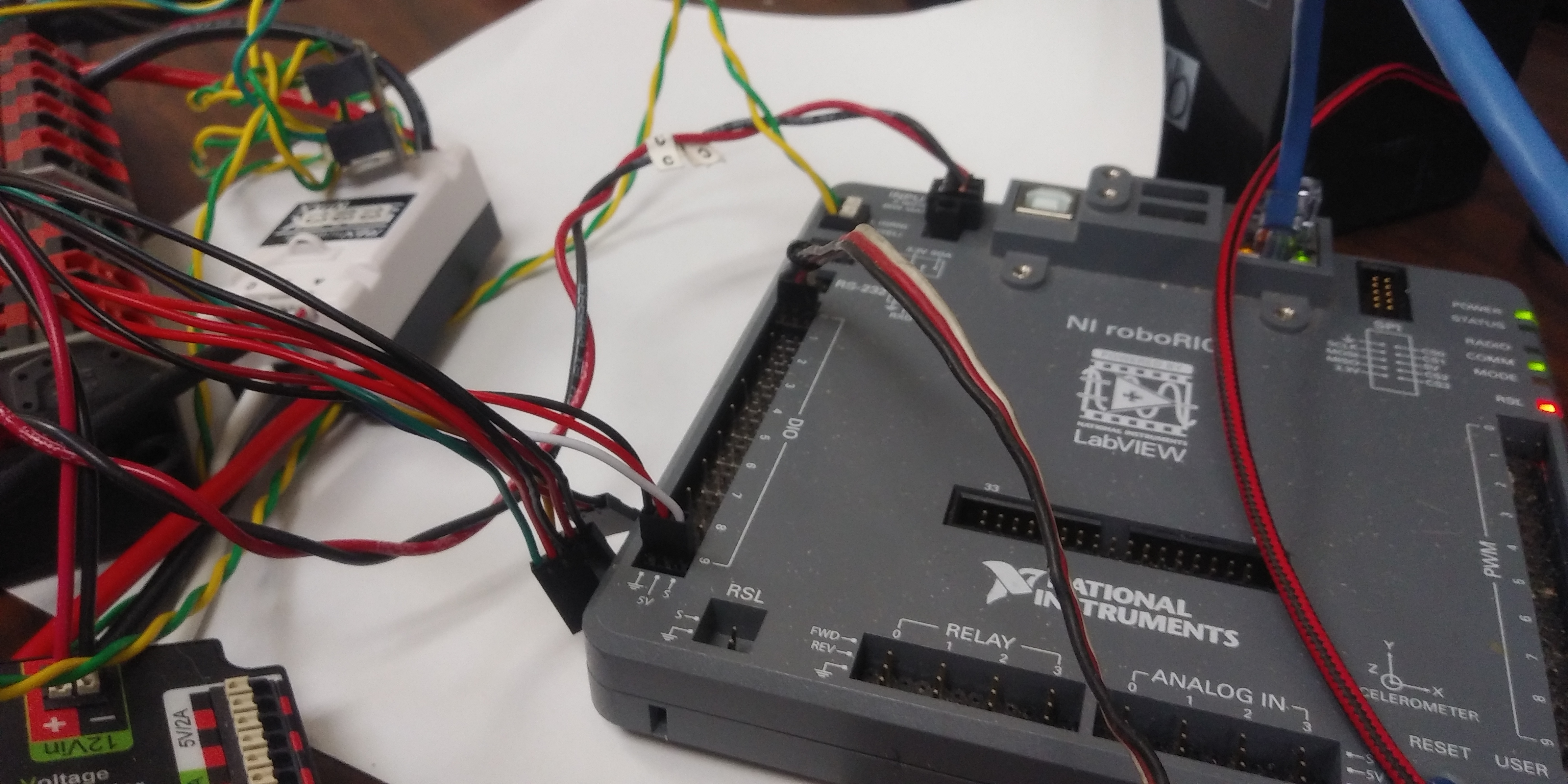

We’re having some trouble getting the Rev through bore encoder reading in either absolute or quadrature modes.
We plugged in a limit switch to the DIO to make sure that the pins were working and everything went swimmingly, but as soon as we try the encoder we get nothing. The programming team is new to encoders (and programming), so any help would be appreciated!
Looking at the SmartDashboard we aren’t even getting values from the encoders, so I want to make sure that we aren’t doing something wrong before sending it back to Rev.
Here is our quadrature wiring and code:
In the picture the motor controller is next to the RoboRio, but the through bore encoder is actually plugged directly in to the RoboRio via the jst->dupont adapter

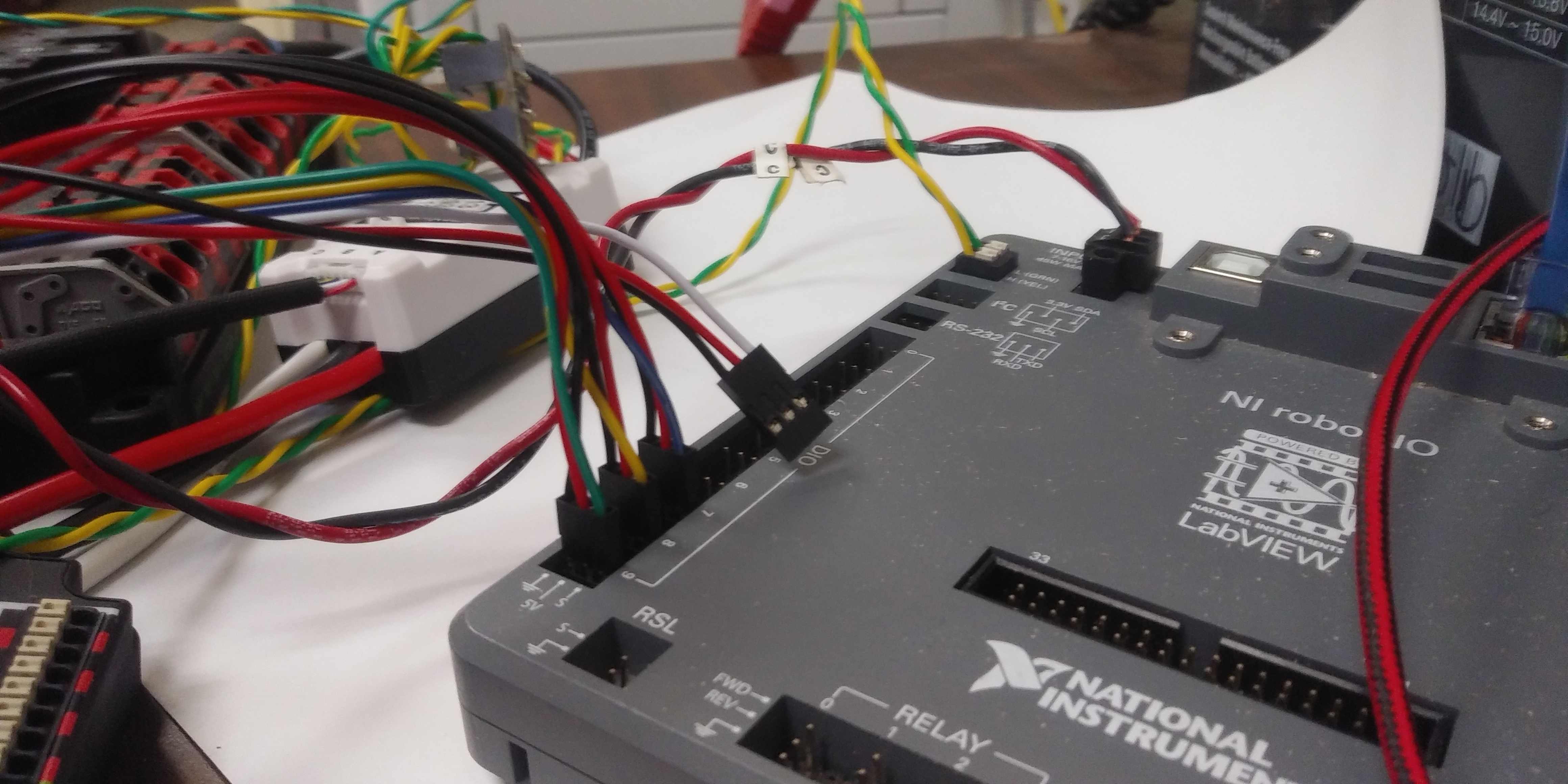

I can’t put another picture in, but imagine a pic of the white abs wire plugged into DIO 9 with the other three quad wires unplugged.

The WPI folks might need to chime in for a code review, but could you make sure that the switch on the side of the Through Bore Encoder is in the “A” position?
Yes sir, I read on the reference material that the S mode is for future use. We have our’s in A mode.
Here is a pic of the absolute wiring going from the DIO on the RoboRio through the jst->dupont adapter to the encoder.
Did you double-check that the JST end of the cable is fully inserted into the encoder?
All connections are tight, I am mostly hoping to have someone that has got these working verify that it is wired correctly. If so I will change this over to a coding issue.
The first photo looks mostly right, assuming the green, yellow, and blue wires are your encoder signals (A B Z/index). Red and black are power to the encoder. You only need one pair. Make sure the others are well insulated.

I’m not sure what your showing in the second photo…
Everything looks good from a wiring standpoint.
It does not.
The second photo is what we are hoping is the wiring for the absolute mode on the encoder. We got the wiring from the documentation on the Rev website. The top picture is for quadrature mode. We’ve tried the quadrature mode both with and without the index wire to no avail. We aren’t even getting the encoder to show if it is connected on either absolute or quad, so I wanted to have someone verify that we have it wired correctly before we move this thread to programming. Thanks again for all of your help!
