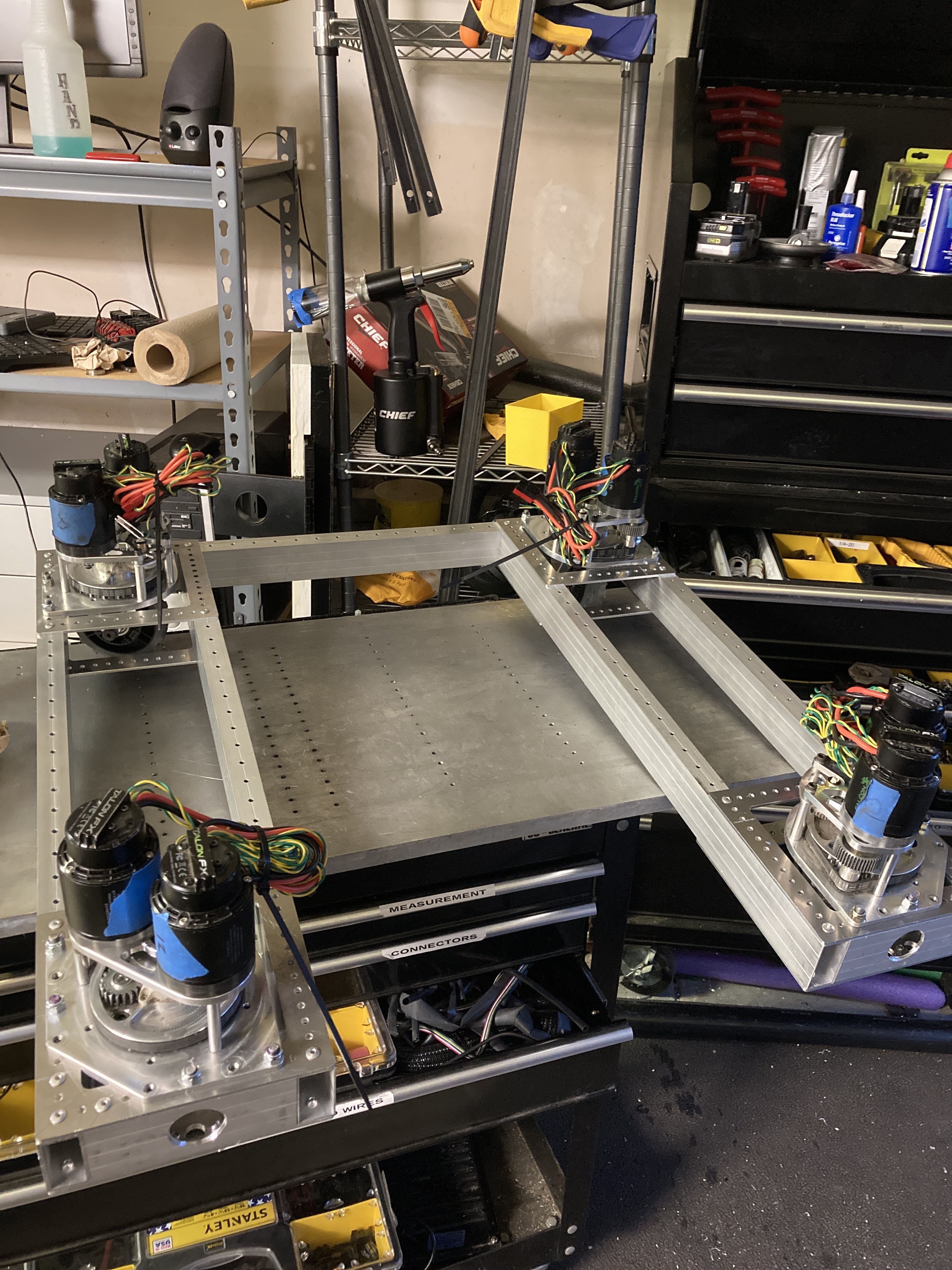

@seanw @tkchan @MrForbes we are using falcons on our swerve modules, and in order to daisy chain the two motors on each module together we have connected the stock wires from the two motors together and then bundeed the ~two feet of slack right in between the motors. Could this be causing issues?
This is kind of what the bundle looks like:
Obviously, there are a lot more than just can wires in the bundles in this picture. Thoes are no longer like that as the power leads have been connected to the pdp and the first and las can connections have been extended to other modules.

those are all CAN bus wiring so noise pickup shouldn’t be an issue as long as they are twisted. Hard to tell from the pix, are the CAN wiring done in a daisy chained manner? i.e.
from left/previous CAN device → [top motor → bottom motor] → [ next top motor → next bottom motor ] → [ next-next top motor → next-next bottom motor] → [right side top motor → right side bottom motor] → to next CAN device.

I’m not a software the guy, but the software guy isn’t a fan of forums, so I’m making this post. That said, afaik we can see all devices on the can network (8 falcon motors), can connect to them and make them all spin individually, and can make them spin while running code. The swerve drive in general is having some issues, which i think would be best described with a video, so i will get that, but the main CAN related error we are getting (again, afaik) is a “CAN Frame not received/too-stale” error, which appears while the swerve code is running. I am not sure if this error is given with a specific can device, but if it is, and if that info would be helpful, i can ask for that info.
I seem to recall that a section of the can wiring is currently being extended using a non twisted 3 conductor pwm extension… will get that fixed, and then report back.
