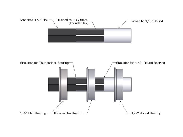

Unfortunately, a hex shaft won’t work because the shaft needs to be in block bearings, but the idea of drilling through an aluminum shaft collar should work great, and those are only about $4 each.

Some options may include using thunder hex which has rounded corners to fit into round bearings
maybe depending on the application a 3d printed or machined spacer to let the hex fit in a round bearing. Also depending on the application you could machine the end of the shaft to fit in the block.
