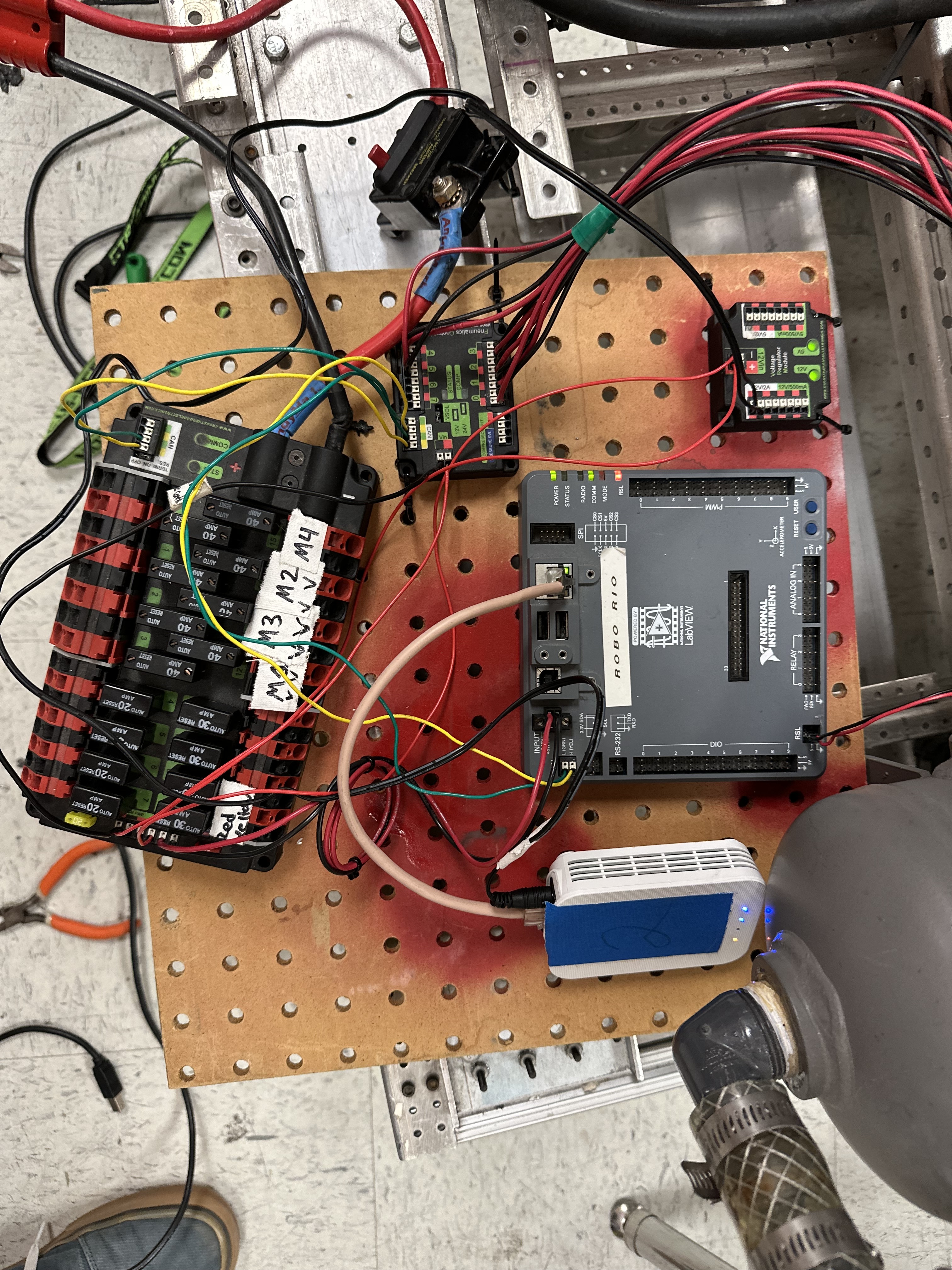

Tshirt cannon CAN issue
We are just trying to get our tshirt cannon to do the bare minimum and open solenoids. We have been having a CAN issue for a while and we’ve tried almost everything…
  • Replaced all hardware
  • Updated PDP and PCM Firmware
  • Updated the PDP CAN ID to 1 and PCM CAN ID to 0
  • Rewired all electrical from FRC guide
I’m very sure our electrical is all correct, but we still get a CAN issue in Driver Station console.
The PDP and PCM status lights both flash slow green, even when enabled.
What exact message is the driver station reporting?
Probably not an issue with this short of wires, but the CAN wires ought to be a twisted pair.
Yeah I don’t have an updated picture but I twisted the CAN wires, and moved radio like 2 feet away.
Error is: “CAN Error message not found”

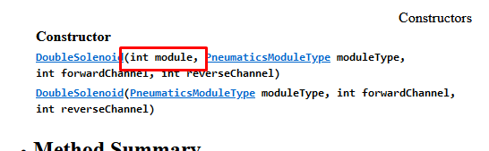

The CAN ID of the PCM can be declared in the constructor of the solenoid itself and in my experience it usually is best to do so.
I think the only variable it takes is the port on the PCM.
No, it can, the constructor of the Solenoid and DoubleSolenoid class can take the CAN ID of the pneumatics module. I am not sure if this is your issue but we have had similar issues before and I do believe adding the CAN ID solved it.
DoubleSolenoid
Solenoid
I rewrote the code with the proper solenoid method and it worked, thank you so much​:sob::sob:

The PneumaticsControlModule class also has a constructor that includes the CAN ID.
Ah, it does, looking back at some of our team’s code. But even with that CAN ID there we still saw issues without putting it in the solenoid itself.
If you contructed it like the following then the two objects aren’t linked together and the PCM would use CAN ID 10 and the Solenoid would use the default CAN ID 0. What PCM would the solenoid be associated with if you had multiple PCMs?
  PneumaticsControlModule pcm = new PneumaticsControlModule(10);
  Solenoid sol = new Solenoid(PneumaticsModuleType.CTREPCM, 0);
If you constructed it like the following, then they would associated and both would use CAN ID 11.
  PneumaticsControlModule pcm2 = new PneumaticsControlModule(11);
  Solenoid sol2 = pcm2.makeSolenoid(0);
The former syntax has the advantage that for robots with solenoids in multiple subsystems, you don’t need to pass PCM objects around, but with the disadvantage that you have to put in the CAN ID each time.
Code issues aside, I’m begging you, please give those CAN wires a good twisting (CAN wire should be twisted to avoid signal interference). It’s painful to look at. :joy:
yeah I already had, im gonna neaten up the board now that it work
