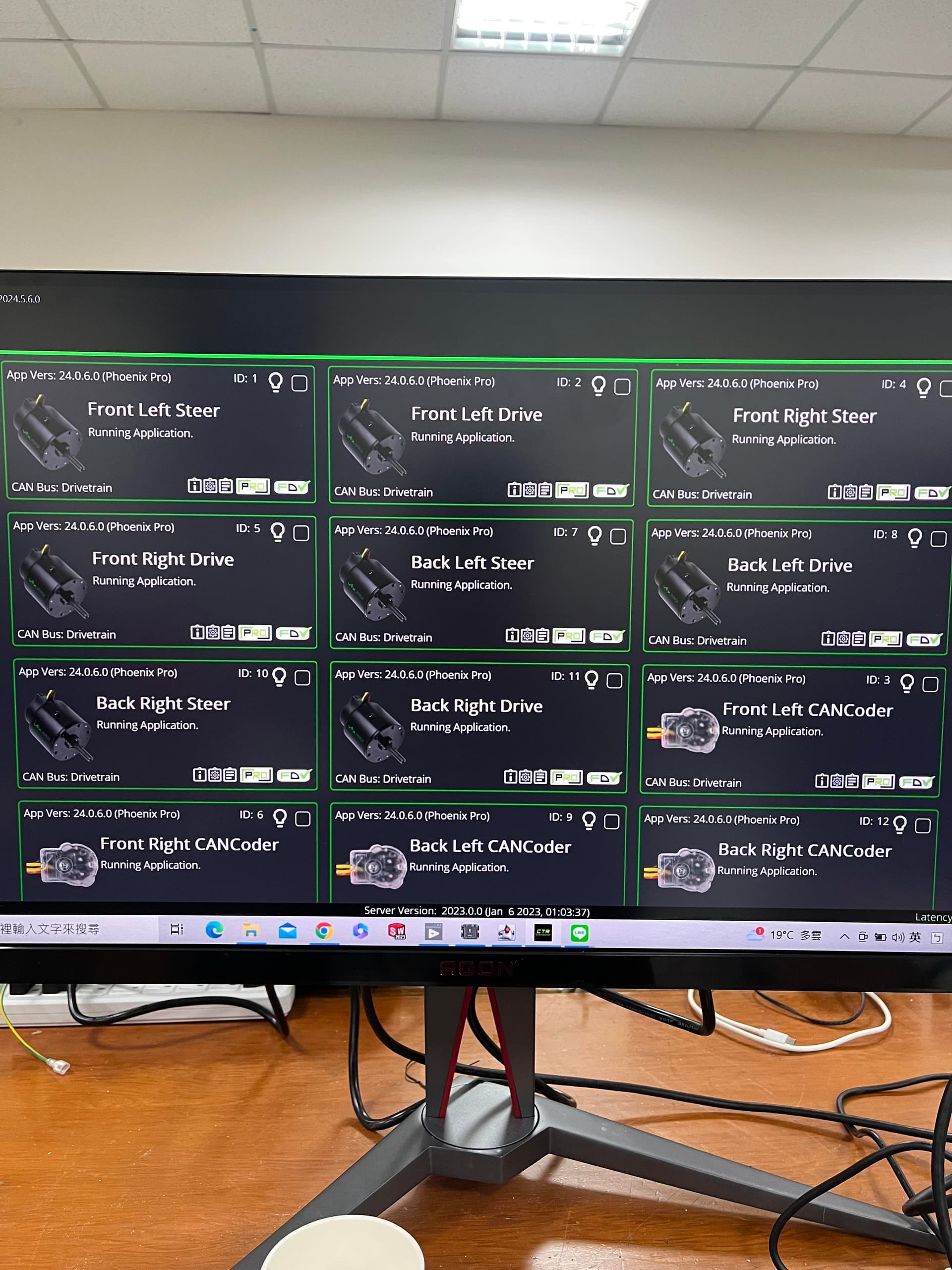

Hello,

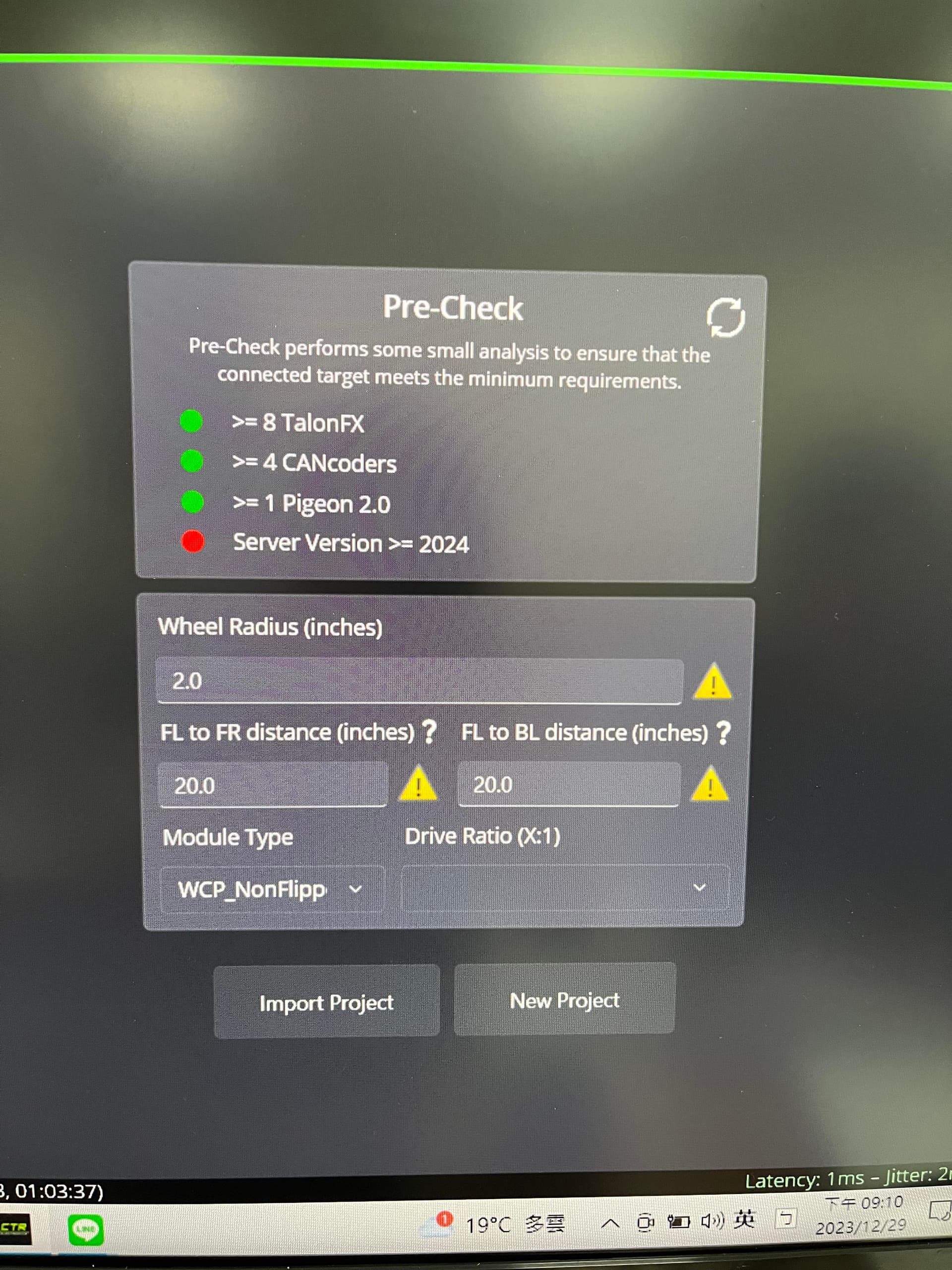

I was trying to use Swerve Generator to create the code. However, in the first of this priod, there was a error about version.
I reviewed all the devices, and the versions were all right.

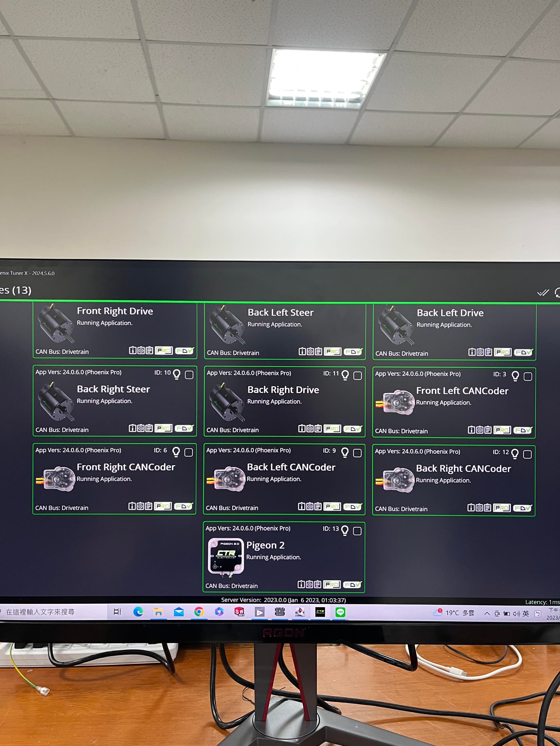

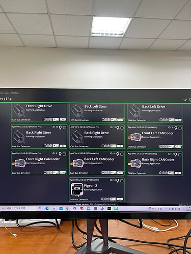

I was not sure about what is the pronlem, so I ignored this this mistake and just went to next step. Then other problems happened, the fisrt one was that I couldn’t use the “Encoder Calibration”. I checked the light, and one of those for was sparking red light. Below is the light:
415253070_6978739832246834_5531484346620788878_n.zip (416.0 KB)
The other one was that I did not see the “Factory default all devices” option.
I forgot to take these problem photoes, hope this statemaent can enable you understand, if not, please feel free to ask me more information.
Whats the version of your phoenix vendordep in your code?
2024.5.6.0, the newest one.
Not sure if it is the same issue but we had a similar issue. Needed update our rio to 2024 beta first. Then we weren’t able to access the can devices. We tried temporary diagnosics server but found out it doesn’t yet work with 2024 to maintain compatibility with 2023. The solution was to upload code that has the 2024 Pheonix 6 installed and at least one device initialized.

The 2024 image is required.
He is right that the temporary diagnostic server doesn’t work for the beta.
They have multiple examples you can deploy to get around that.
Our latest firmware is 24.0.6.0 and latest vendordep is 24.0.0-beta-5.
Based on the Pre Check for the server version being too old, I’m assuming you’re still running 2023 API/Diagnostic Server. You’ll need to image the rio with the 2024 beta image, and deploy a project using our beta API. The examples are all updated to use the beta API so deploying any of them should give you an up-to-date diagnostic server to do the generation on.

Thanks! After changed the software vision to 2024 beta, I successfully generated the project.
