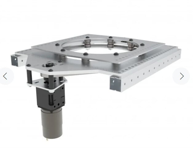

Can someone please explain the mechanism behind turrets like these? I don’t understand how the bearings are connected and how that allows things to move the way they are supposed to. How are the bearings connected to the plates?
I know team 148 did something like this in 2017, but I can’t get a good grasp of exactly how everything works.

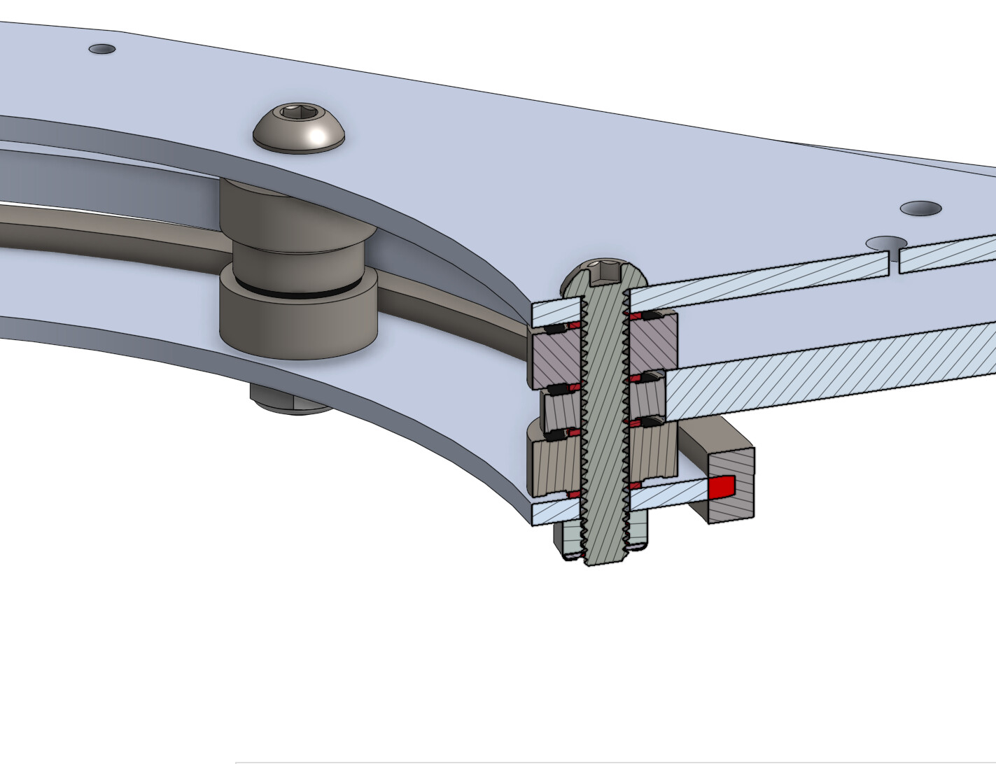

A section view might help:
The top plate is what the rest of your turret is mounted to, and the very bottom plate is a giant sprocket. These two plates are bolted together, with a stack of bearings on each bolt. By using a big-small-big bearing stack, you create a little C shape that rides on the edge of the middle plate, which is rigidly mounted to the robot. By having multiple of these bearing stacks in a circle, the entire turret is fully captured, riding on the edge of the big circle in the middle plate.

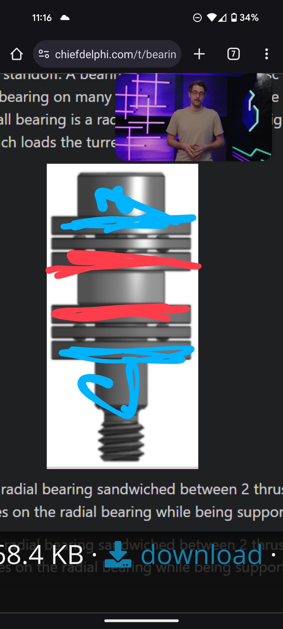

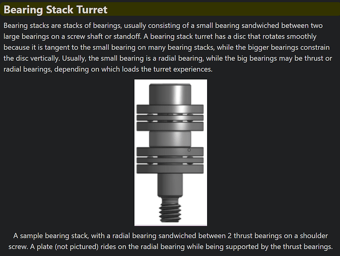

How does the bearing stack work exactly? Does the middle smaller bearing not move and just the outside bearings move? (By move I mean if the inside of the bearing rotates or not?) Thanks!
In a “perfect” world, all three bearings rotate as the turret turns. The thrust bearings take the moment load (and support the weight of the turret), while the center bearing keeps the turret running smoothly by rolling along the edge of the ring plate.
However, in reality, bearing stacks are imperfect and the turret ring plate might not contact every radial bearing at all times. For this reason those bearings tend to function more like “bumpers” and are there to make sure everything continues to run smoothly.
The thrust bearings act pretty much as you would expect, however the bottom one of course tends to spend more time supporting the turret due to gravity.
Adding on to this, the red parts move, the blue parts don’t.

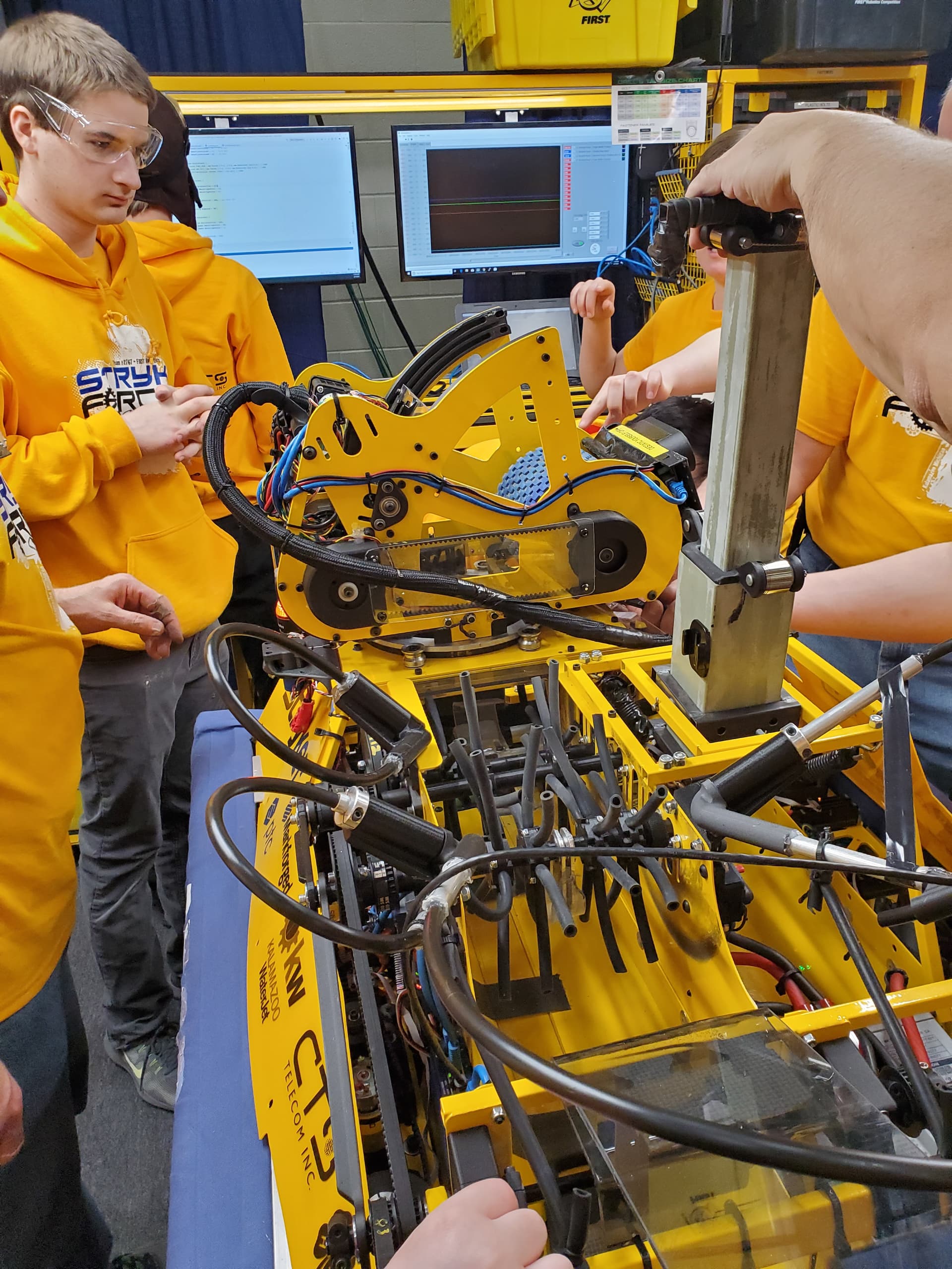

In 2020 2767 did a V-groove setup with a 2-D part plate, in 2022 we decided to use a COTS part because we didn’t wanna go through that all again (time wise it made sense to focus on other things)

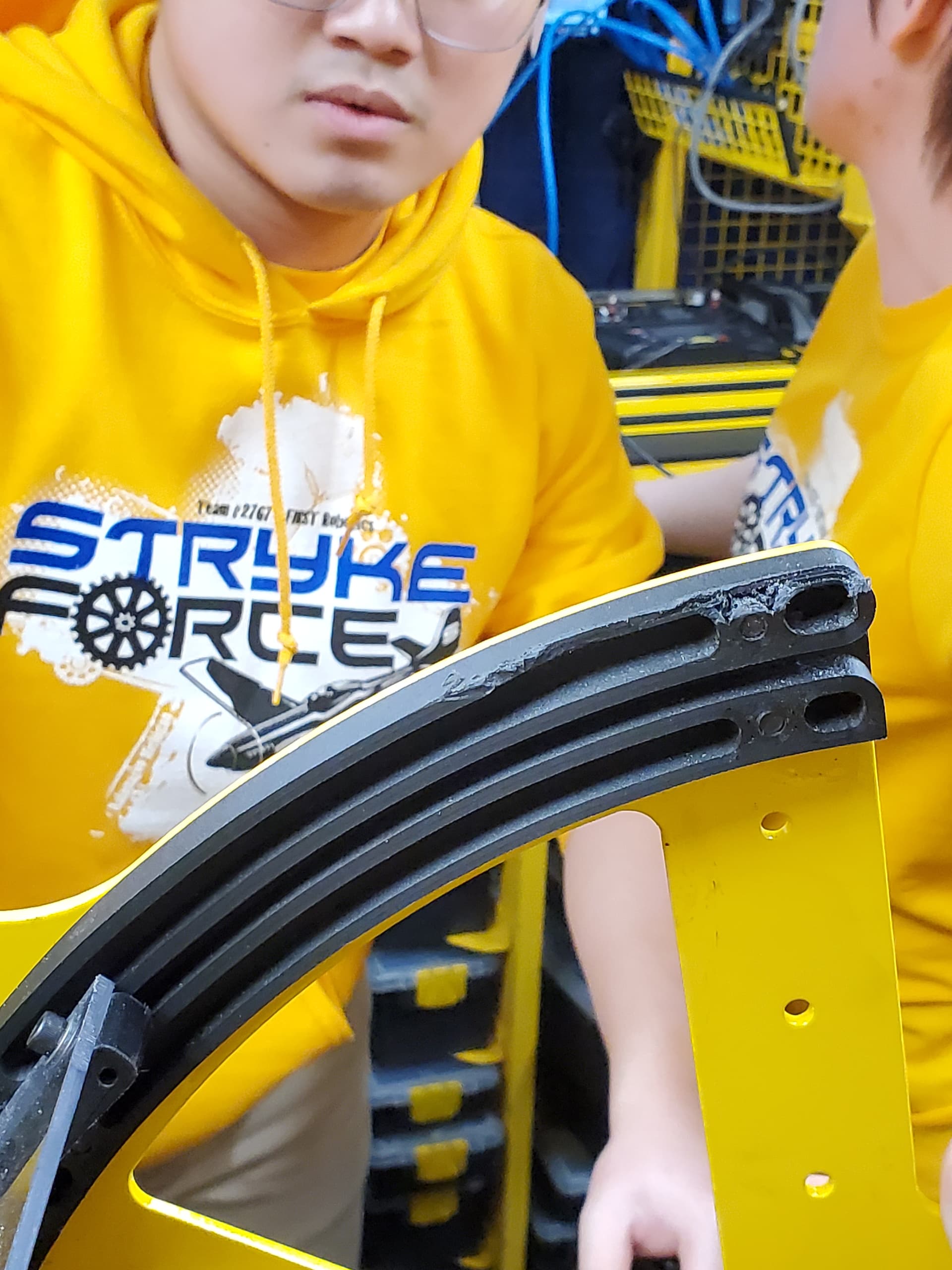

An odd number of V-groove bearings were placed around (important incase the waterjet aluminum inner plate is out of round when tightened) (correction, comp bot did not do this). There was adjustment in placing these bearings. We used custom steel V-groove covers over radial bearings (i think it was stainless; non cots v bearings was for geometry reasons, so there was room at the root of the V for the plate so we didn’t have to chamfer). The plate slightly wore into the bearings, creating work hardened chamfers. You can see the setup here:
… and assembly, at least to some extent, in the build time-lapse
This was all a fair bit of hassle, but was very robust. In our first (and only) comp weekend of 2020 we had a ball get under the robot and we hit the turret on the color wheel. The turret popped off. No damage because of how things flexed. The video is on FUNs week 2 clips of the week. Here is the damage sustained:
