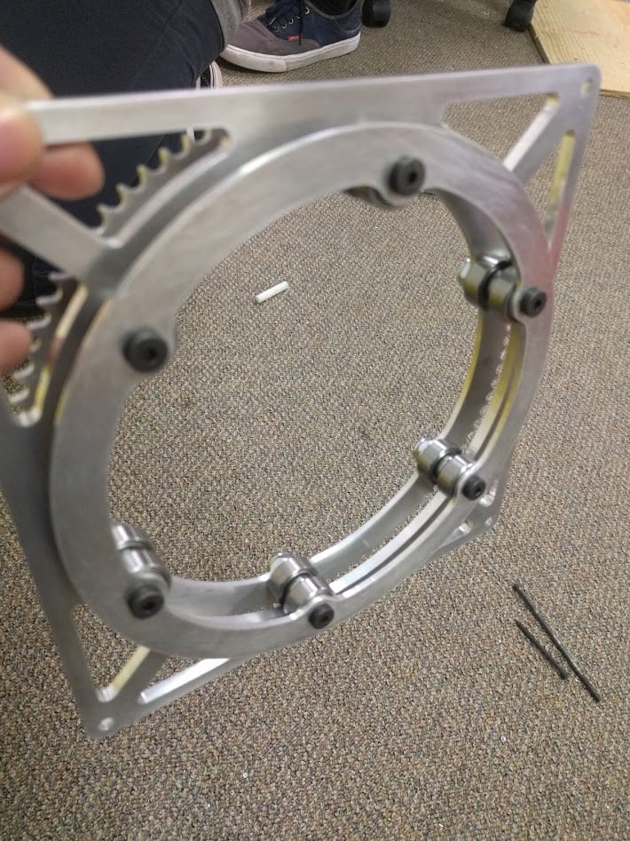

So the way I see our team could accomplish this is laser cut or plasma cut a thin piece of aluminum with a circle in the center. We could then laser cut a big sprocket to which holes would be present for attaching a mechanism and the bearings. The plate with the central hole would be raised by mounting it on 1x1 or some form of tube around the perimeter and that assembly could be raised by using L-channel. Does that seam plausible. Btw, it’s one of those industrial laser cutters that our sponsor has. Idk if plasma cutting would be better though. We don’t have a router (that works at least)

Here’s a little turret demo thing we made that illustrates how our 2019 turret bearing worked.
So the bearings in the middle are sandwiching the support. And then the bottom is a custom sprocket sandwiched by the top plate where you’d mount the mechanism I suppose a shooter.
Edit: Wait, 2019, what was it used for. It looks too small for a turreting elevator
Not a turreting elevator… a turreted elevator. They mounted hatch and cargo on opposite ends of an arm, mounted to their (sideways) elevator, and the arm could do a near 360 about a horizontal axis.

Also, that’s a miniature demo piece, the real one is much larger.
Ah, I get it. But the concept still applies, it can still be used with a shooter with the hole in the middle as pass through for objects
Why did you use a small bearing between two large bearings instead of a small bearing between two delrin spacers or something like that?
Roller bearings have an effective CoF of about 0.001. Delrin (or equivalent slippery plastics) have a CoF on aluminum of around 0.2. That’s a significant increase in force needed to move the turret.
