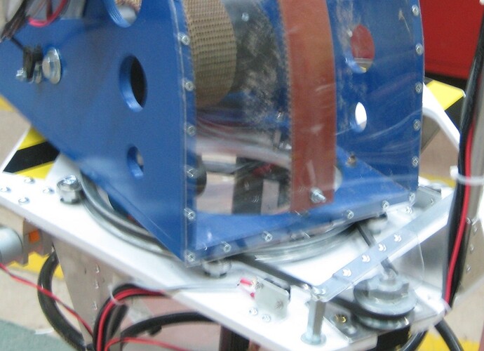

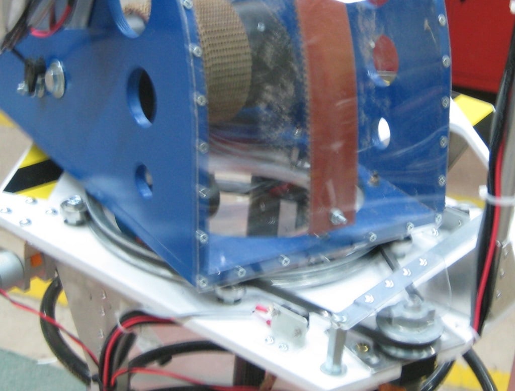

I want to preface my answer up front by saying I have never actually built one of these, just picked the brain of lots of teams, and inspected a few.
I’m not an expert on question 1, but the second question I have looked into a lot. The most effective way of building a turret without custom machining I have seen is what I call the reverse belt method. Basically you take a lazy susan bearing (Amazon Link below) and attach a timing belt to it with the teeth facing out. You can then mount a standard pulley to the end of whatever motor or gearbox you choose, and physically mount the assembly so that the pulley interfaces with the teeth of the belt as if they were two gears meshing. The Photo below is from team 174 in 2012 and shows roughly how the belt looks on the bearing. Cant find a better picture showing a motor from my collection unfortunately.
This is what we did in 2012. You could also do the same thing with chain using these links to fasten it to the turntable bearing. The timing belt method would definitely be smoother.

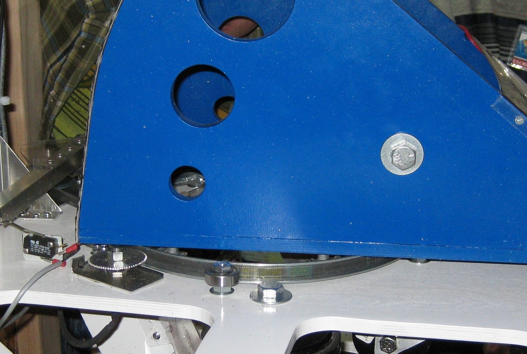

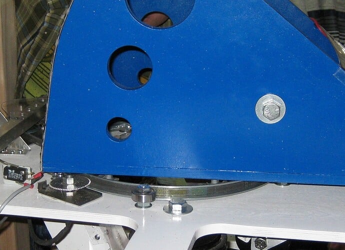

if you want cheap, and not much machining…
in 2009 we used a V belt…the big pulley was not expensive, and we used a hacksaw to remove the center, leaving enough of the spokes to bolt the turret base onto. It is supported with bearings that fit into the edge of the pulley.

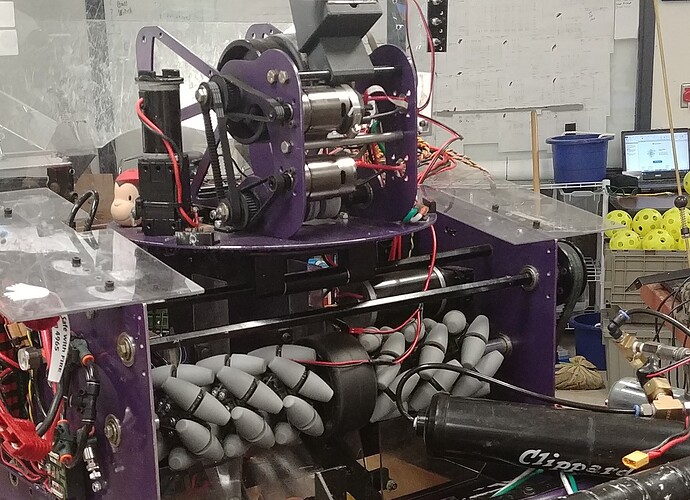

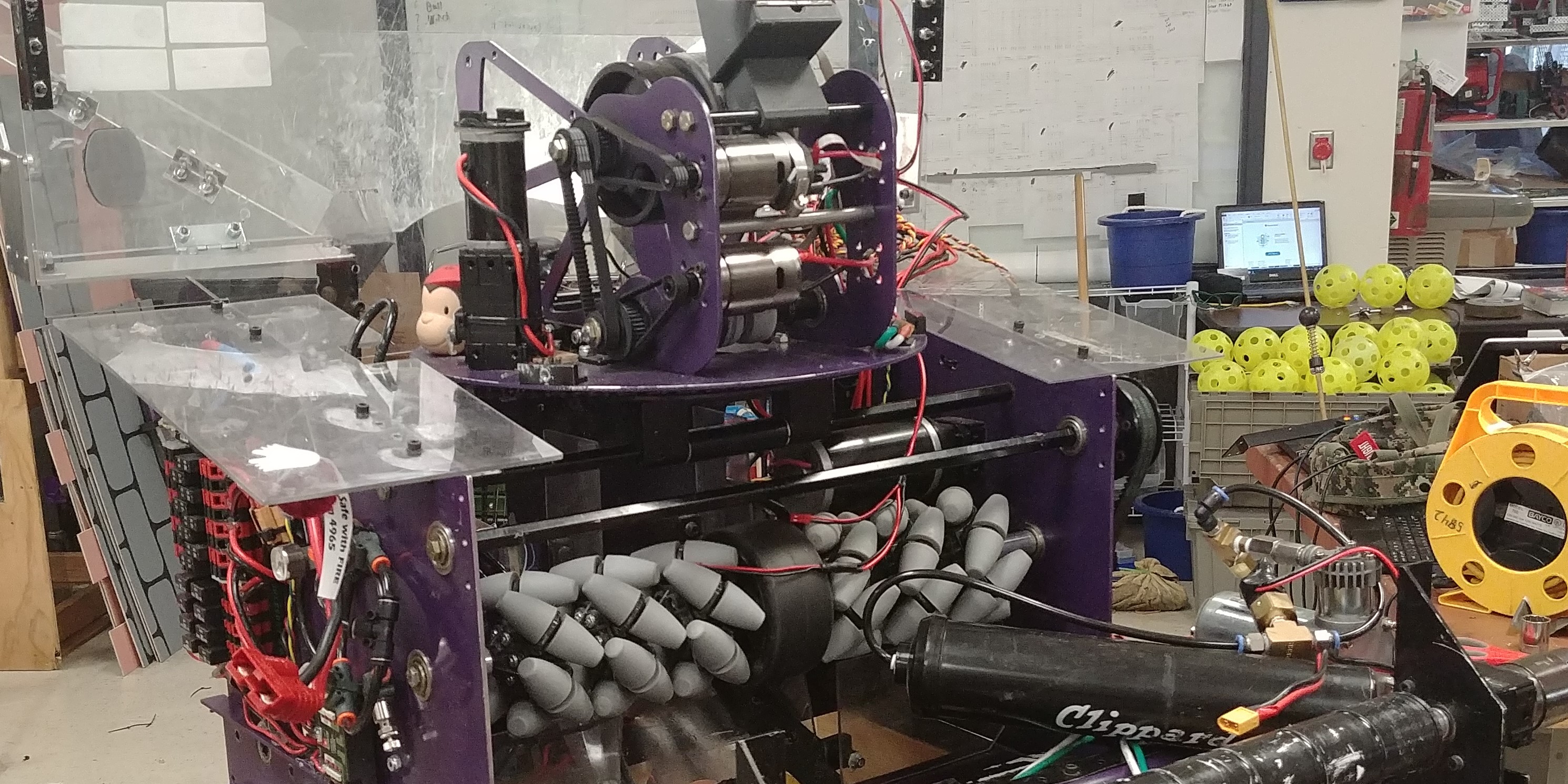

Last season my team used a sprocket on (I can’t remember the name off the top of my head) and a giant lazy susan bearing set something like this. we then proceeded to drill a hole in the outer ring to thread in a bolt that would go between chainlinks so essentially as the motor sprocket pulled the chain the torque would be delivered to the bolt and pull the outer ring of the bearing around as the inner ring stayed mounted in place.
It may be hard to see, wish I had a better picture or the CAD on hand, but the lazy susan bearing is mounted under the metal disk the motor sprocket and chain are also underneath. We mounted the inner bearing to the robot and the motor then spun the whole disk, (wires, camera, motor controllers, and light) around.
