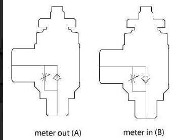

Capture
Apparently there are needle valves (which appear to be bidirectional) and flow restrictors (which only restrict one direction). I found this symbol on some of ours but am not sure what it means. Is the circle/arrow symbol the unidirectional flow?
So those it looks like will restrict flow in one direction and be unrestricted in the other.
You can see that the flow is restricted in both directions by the left symbol, however there appears to be a ball valve allowing unrestricted flow in that particular direction (direction away from circle arrow?).
Put a needle valve between the solenoid valve and the extension side of the cylinder. Also put a quick exhaust valve between that needle valve and the cylinder. Don’t modify the retraction side (just tubing). I think this will do what you want.
