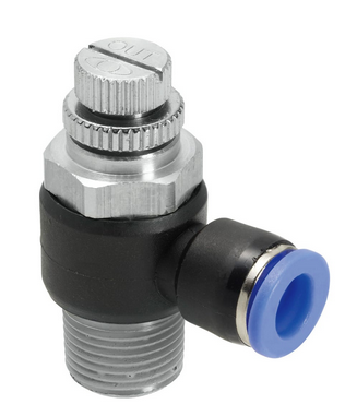

A flow rate control valve looks something like this. It works to reduce flow rate in one direction only, so your cylinder can have different speeds for extend and retract.
If you wish to control only one port of the valve then look at these https://www.automationdirect.com/adc/shopping/catalog/pneumatic_components/special_purpose_pneumatic_fittings/pressure_regulators_-z-gauges-z-_indicators/pru14

Depending on what you are trying to do… You can put regulators between the cylinder and the valve. Just make sure they are the relieving type. For speed control you are generally better of with speed control valves that Don mentions. Be sure to use the meter out version so that it controls the discharge from the cylinder. (except for spring return cylinders were you would use meter in.
