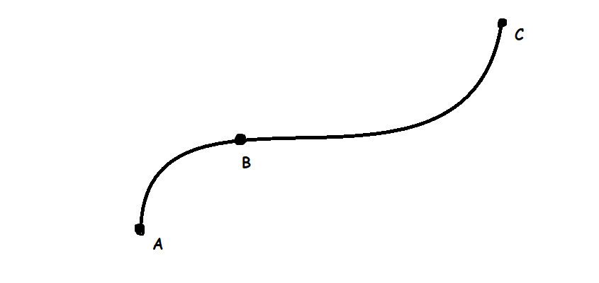

Let’s say you are wanting to follow the below trajectory from point A to point C and want to shift from low to high gear at point B.
Instead of this being on trajectory, break it into 2 trajectories. When using the WPILIB trajectory generator:
  1. Set the max velocity and max acceleration accordingly to the respective gear.
  2. Make sure to convert the speed at B (i.e. if you ended the trajectory at B going 7 fps in low gear and go twice as fast in high gear, make sure to start the second trajectory at 14fps, not 7)
  3. Create a series command group that takes the first trajectory, then a command to shift, then the second trajectory.
I think it should work out pretty smoothly. Feel free to ask if you have any questions!
