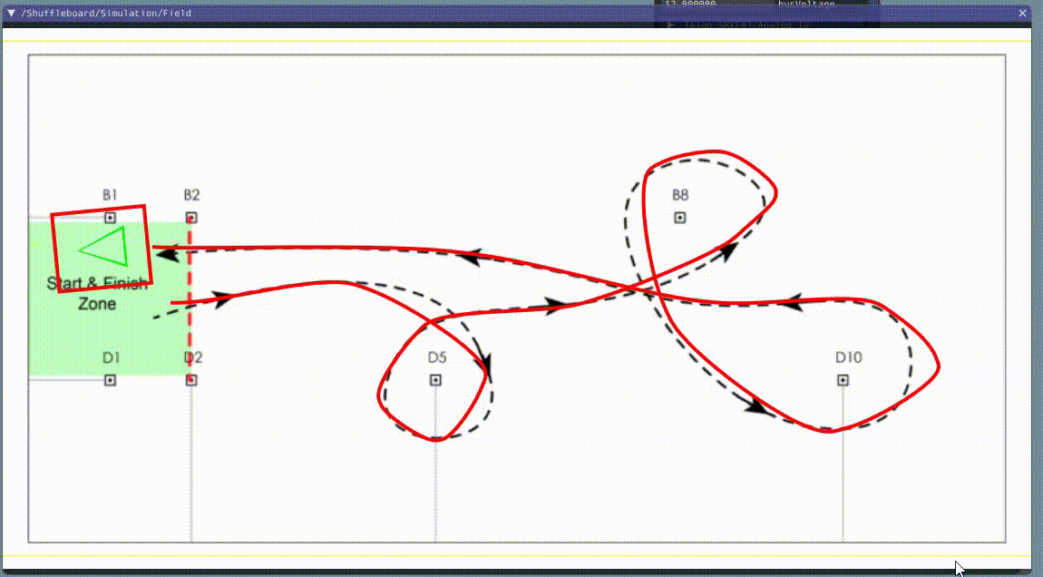

I’ve actually written a full example of trajectory following for non-commandbased, with integration with CTRE motor controllers, PathWeaver, and NavX.
I’ll share a gif later
Screenshot-2021-04-26-v1211
