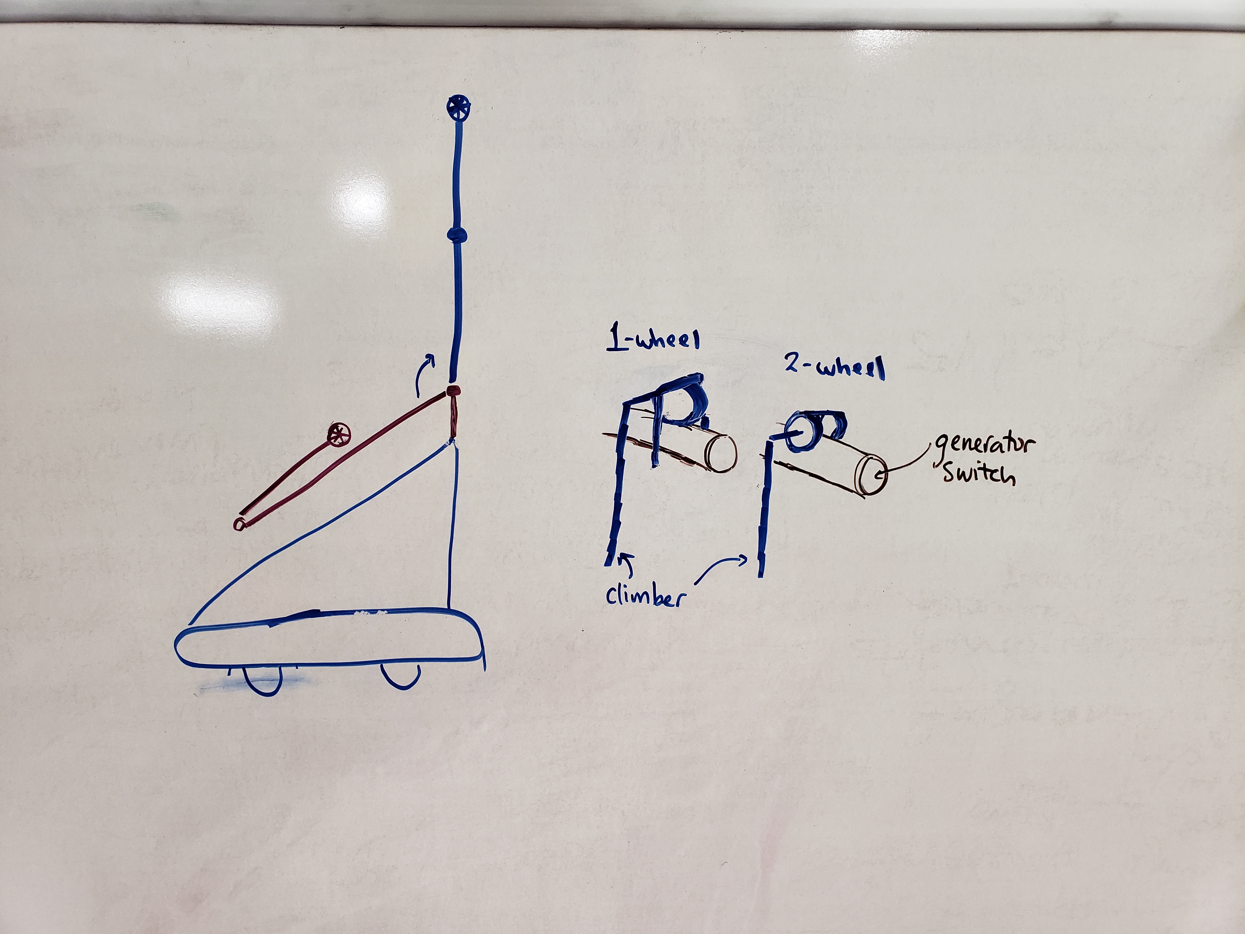

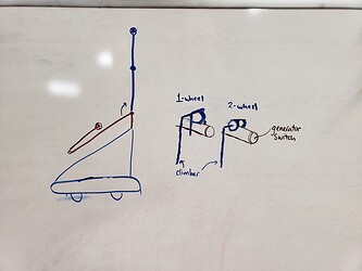

Climber
Goals:
After more deliberation we decided that our climber should be able to reach the initial (~5 ft 3 in) and the top height (~6 ft 7 in) of the generator switch. Regardless, our goal is to climb first which means we just need to focus on the initial height of the bar.
Design:
Our climber will be a spring-loaded folded arm that, upon release, will unfold to attach to the bar. A simple ratchet will bring the robot up. This contraption can either attach to the bar using a hook, or, with a more complicated set-up, using wheels. We are hoping that by hooking onto the bar using driven wheels, we will be able to ride up and down the bar, and thus be able to level the bar.

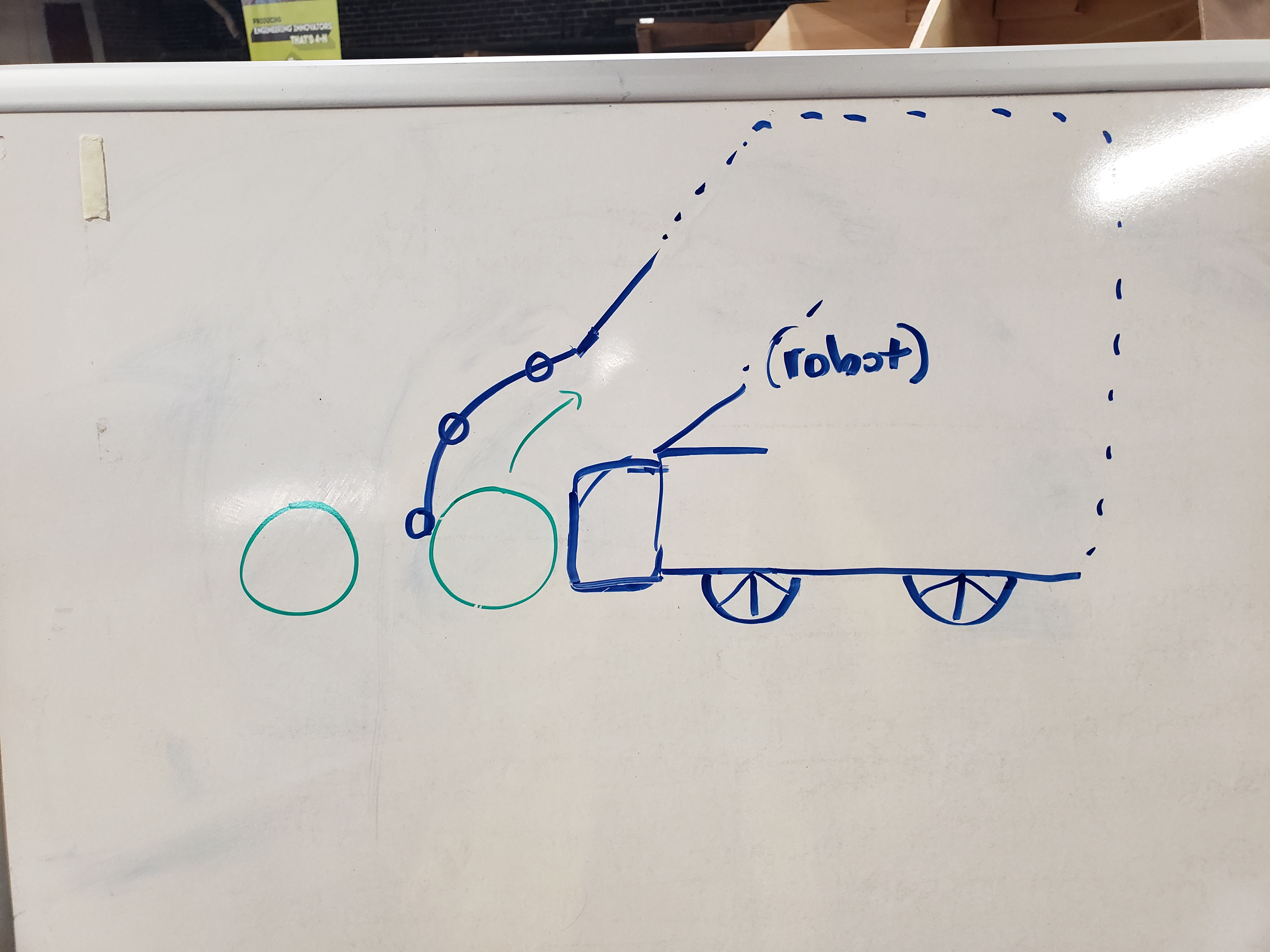

Intake
Goal:
One of our design goals for the intake is to be able to pick up the power cells from the ground, so our intake will extend over the bumper.
Design:
We will have an initial roller pick up the ball and bring it into the robot where we will have an inclined slope created by polybelts. This incline of polybelts will also be on a hinge on the bottom of the slope which will allow us to change the angle of the incline. We want to be able to control the angle of the incline so that we do not immediately outtake the balls when we intake them. The balls will accumulate towards the middle of the polybelt and not go further because they will lose contact with the belt and not be able to travel further upwards.

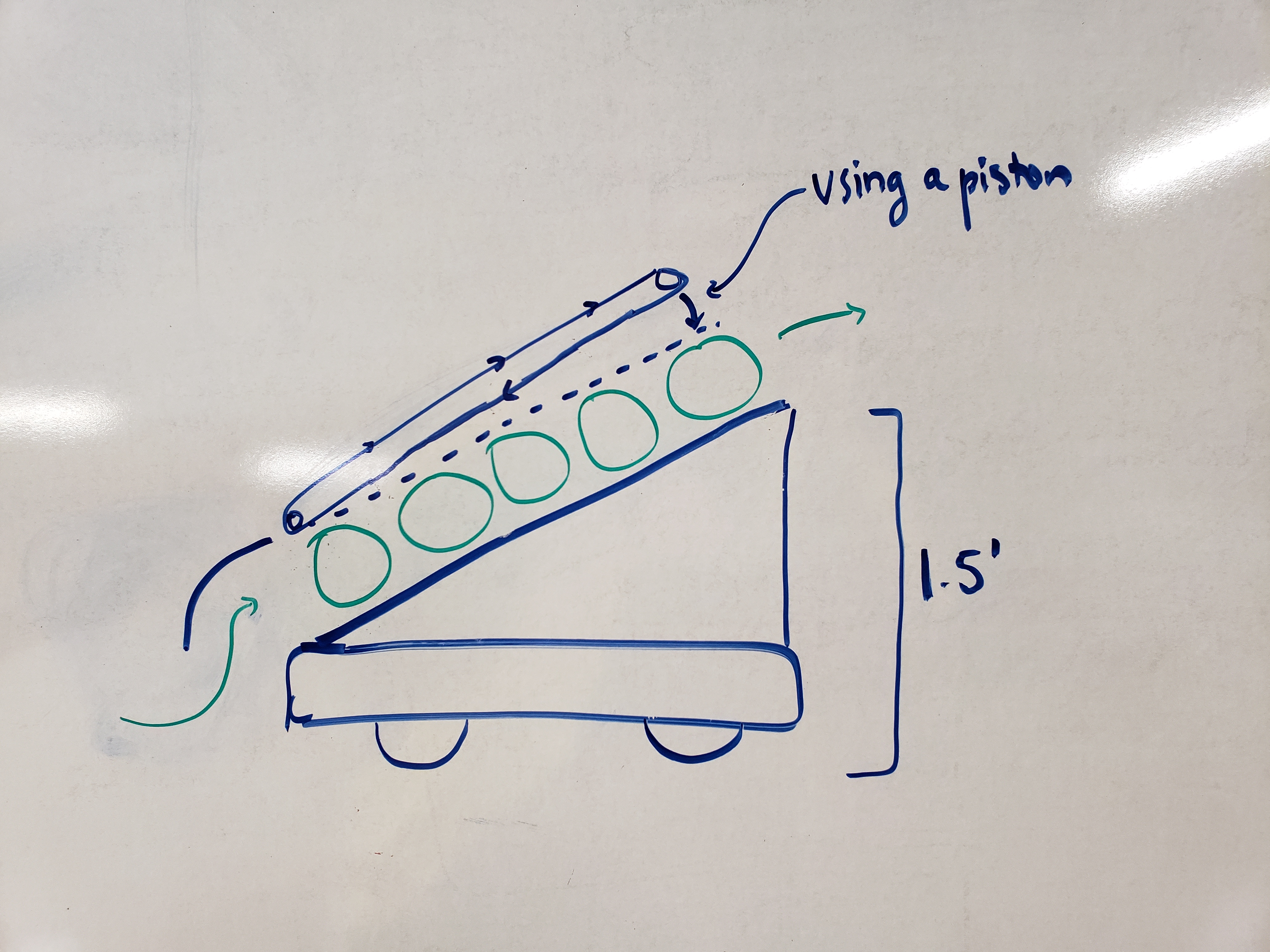

Other Prototyping:
We are currently prototyping two designs that would best prevent us from outputting a ball when we don’t want to.
  1. The entire set of rollers and belts will be on a hinge. When we are traversing the field and intaking power cells, the belts will be in the up position, slightly angled up. This would prevent the balls from making contact with the belts towards the top of it, therefore preventing them from exiting the top of the robot. We have brainstormed two simple ways to do this…
    • Pistons to raise and lower the entire set of rollers and belts
    • A mechanical linkage to raise and lower the entire set of rollers and belts

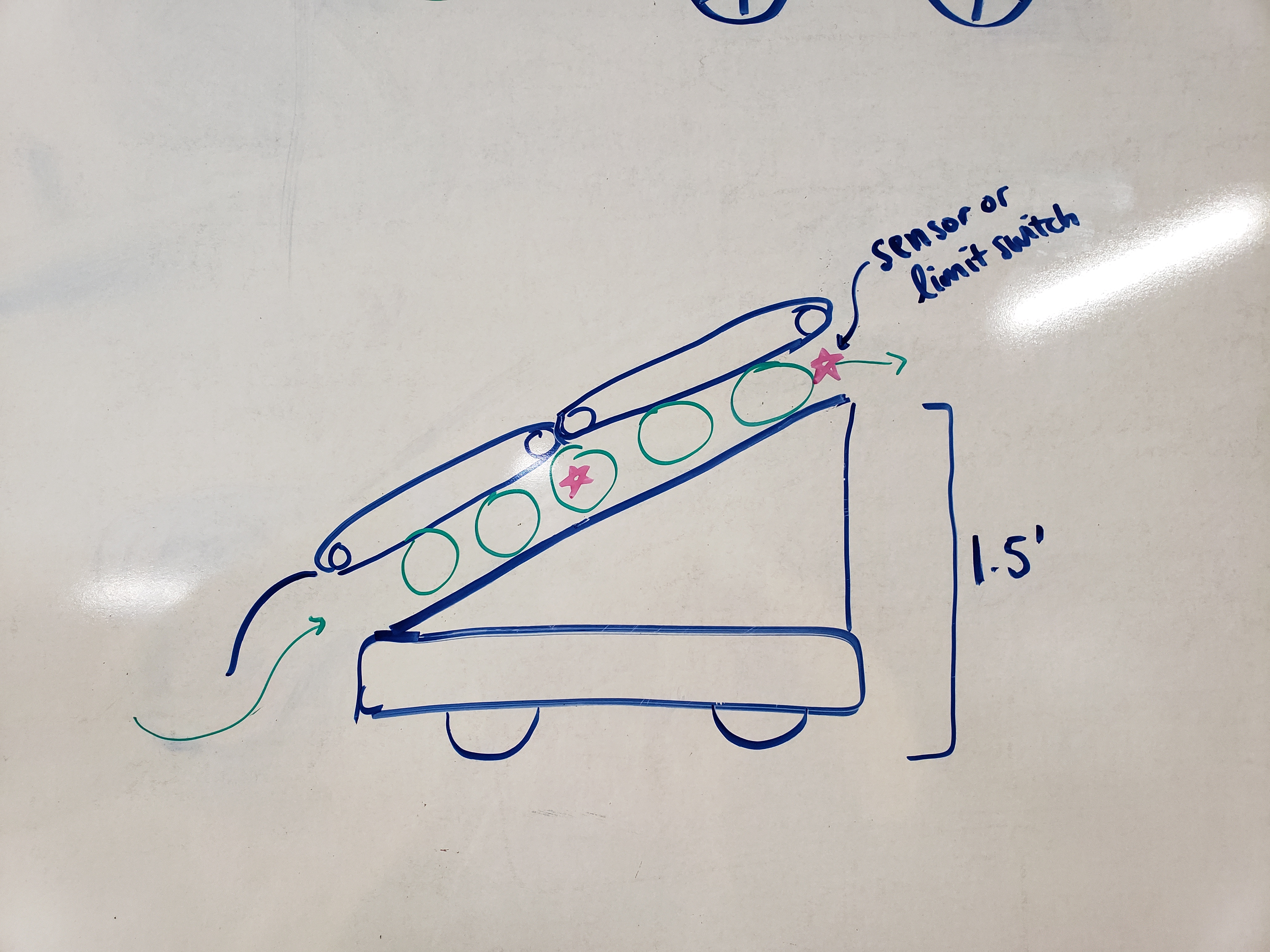

  2. Our other idea is to use a combination of ultrasonic sensors and/or limit switches and two sets of rollers, instead of just one. The ultrasonic sensors would be placed on the top of the ramp and at the beginning of the second set of rollers between. The first set of rollers, which would be connected to the intake would run constantly while trying to intake. The second set of rollers would run when there is a ball at the beginning of the set, as detected by the ultrasonic sensor or limit switch. It would not run if there is a ball at the output end, as detected by the second ultrasonic sensor or limit switch.

First idea:
Second idea:
Ball intake rough sketch:
Climber rough sketch:

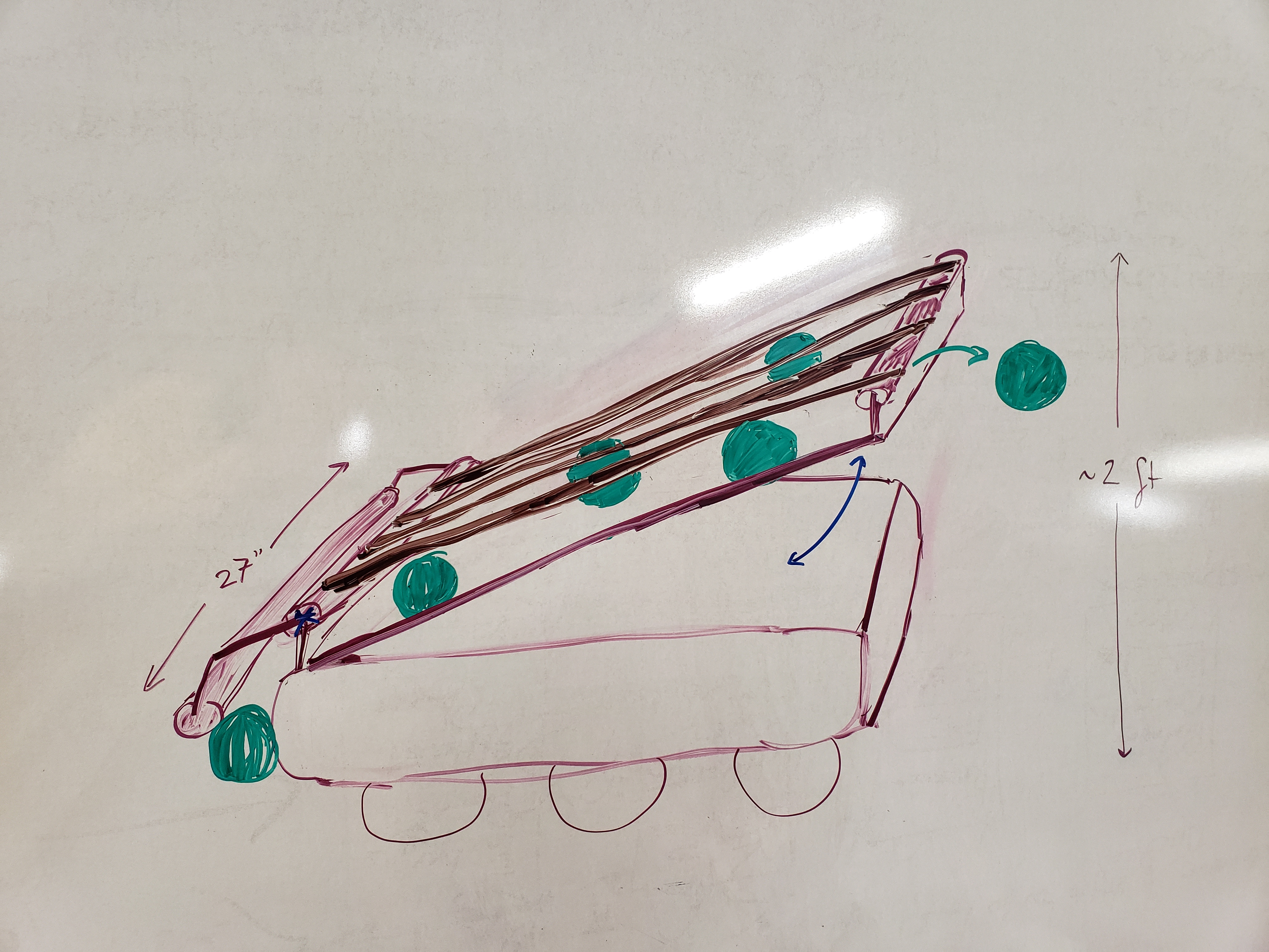

Whole robot rough sketch:

We completed geometry and design for our over the bumper intake mechanism. It is two rollers mounted on lexan piece that are free to rotate about the bottom end of the ramp, with hard stops to limit it’s motion on either direction. This mechanism would be it an up position at the beginning of matches, as to keep it in the frame perimeter, and then fall down as we start driving to be at the correct height to intake the balls. Today, we mounted it to our robot, attaching it to the rest of our ball mechanism. The rollers are connected via polycord to the main set of rollers.
Output
We finished the design and then manufactured and assembled our belts and ramp that are our ball mechanism. Three 2” wide belts are evenly spread out our 18” ramp to bring the ball from the intake height to the height of the lower port. There is a plywood base for the balls to roll on along the entire ramp, providing sufficient friction with the balls. We are using urethane flat belting from Vex, which can be found here: https://www.vexrobotics.com/urethane-belting.html. In the next few days, we will be making a quick tutorial video with our advice and tips on how to best use these, so check back on this thread for the tutorial!
