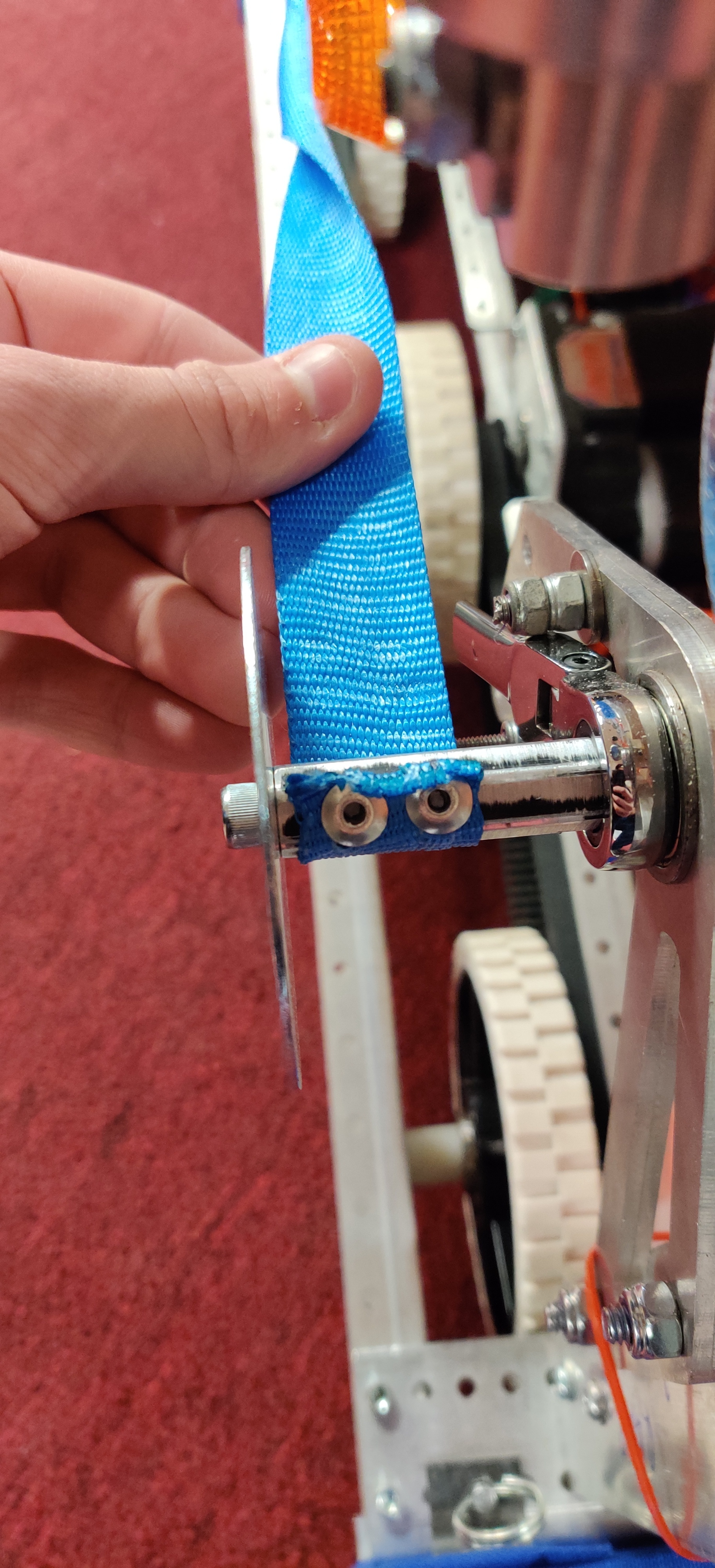

where did you get that blue cable for the climb and how did you attach it to your winch gearbox?
We bought a 1" wide ratchet strap (2-pack) from Walmart for about $5. We then cut them to length, and made two holes with a heated-up 3/16" rivet. We used a small butane torch to head the rivet, the nylon melts away and the hot rivet prevents fringing around the hole (DO NOT DRILL HOLES). We attached the strap with 2x 3/16" rivets into a thunderhex shaft, see image below.

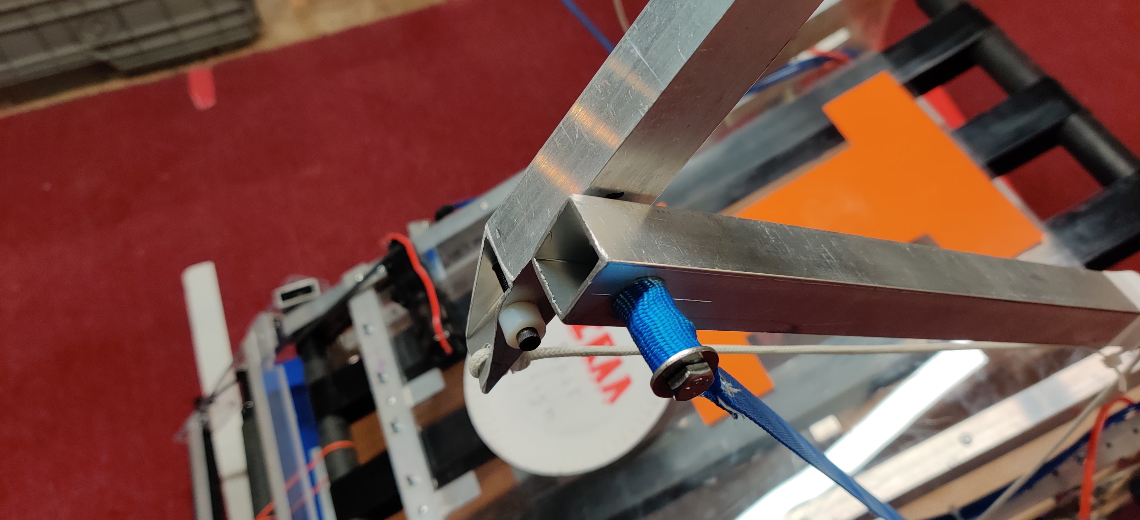

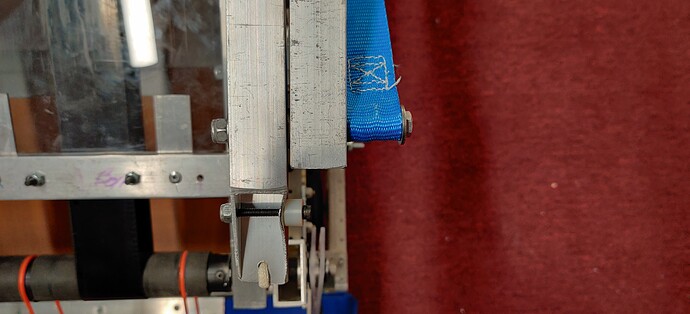

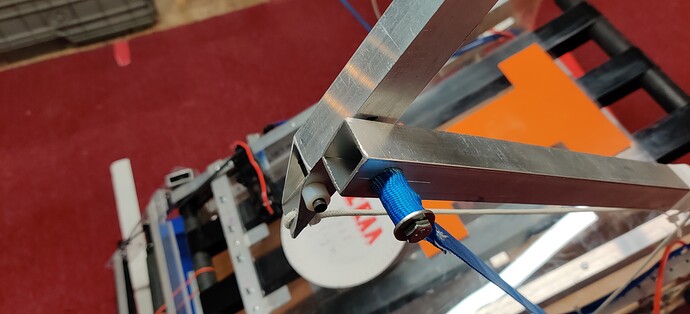

I love the climb you guys built. I have an oddly specific question about it; how did you make that hinge in the middle of the climb connecting those two 1x1s? My team doesn’t have a lot of experience making hinges like that and we’re trying to figure it out. Also, are those 1/8" or 1/16" gauge tubing?
For our climber, we used a single bolt as the pivot point on both sides. See below:
The arm material is 1x1x.0625 wall.
