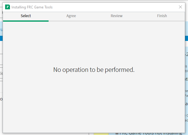

When I try to run the NI installer it tells me “no operation to be preformed” and I cant seem to find a way around this.
Screenshot 2023-02-01 210636
Seen this error before, see this thread: No Operation to be Performed - #5 by individual_disaster
Long story short: make sure you uninstall all the old NI software before installing the latest FRC game tools.
