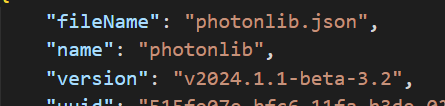

Running PhotoVision v2024.1.1-beta-3.2. Verified in photonlib.json and Photon Client Settings.

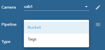

If I use Photon Client Dashboard to select pipelines, images and pipeline data responds as desired.

Solved my problem. Apparently I could not run the v2024.1.1 versions of photoVision with the 2023 version of robot code.
I copied a v2023.4.2 version of photonlib.json into vendordeps and loaded v2023.4.2 into the raspberryPi and now I can select pipelines from the robot code.
Wait, so is 2024 beta 3.2 photonvision on the raspberry pi and 2024 beta 3.2 photonlib on your robot not a working combo?
I spent way too much time screwing with things, so when I got it to work with v2023.4.2, I quit worrying about things. Looking at my original post I see that my photonLib was beta-3.2, while the rPi version was beta-3. I do not know if that was my problem. With 2023 robot code, I was only able to select pipelines with v2023.4.2.
